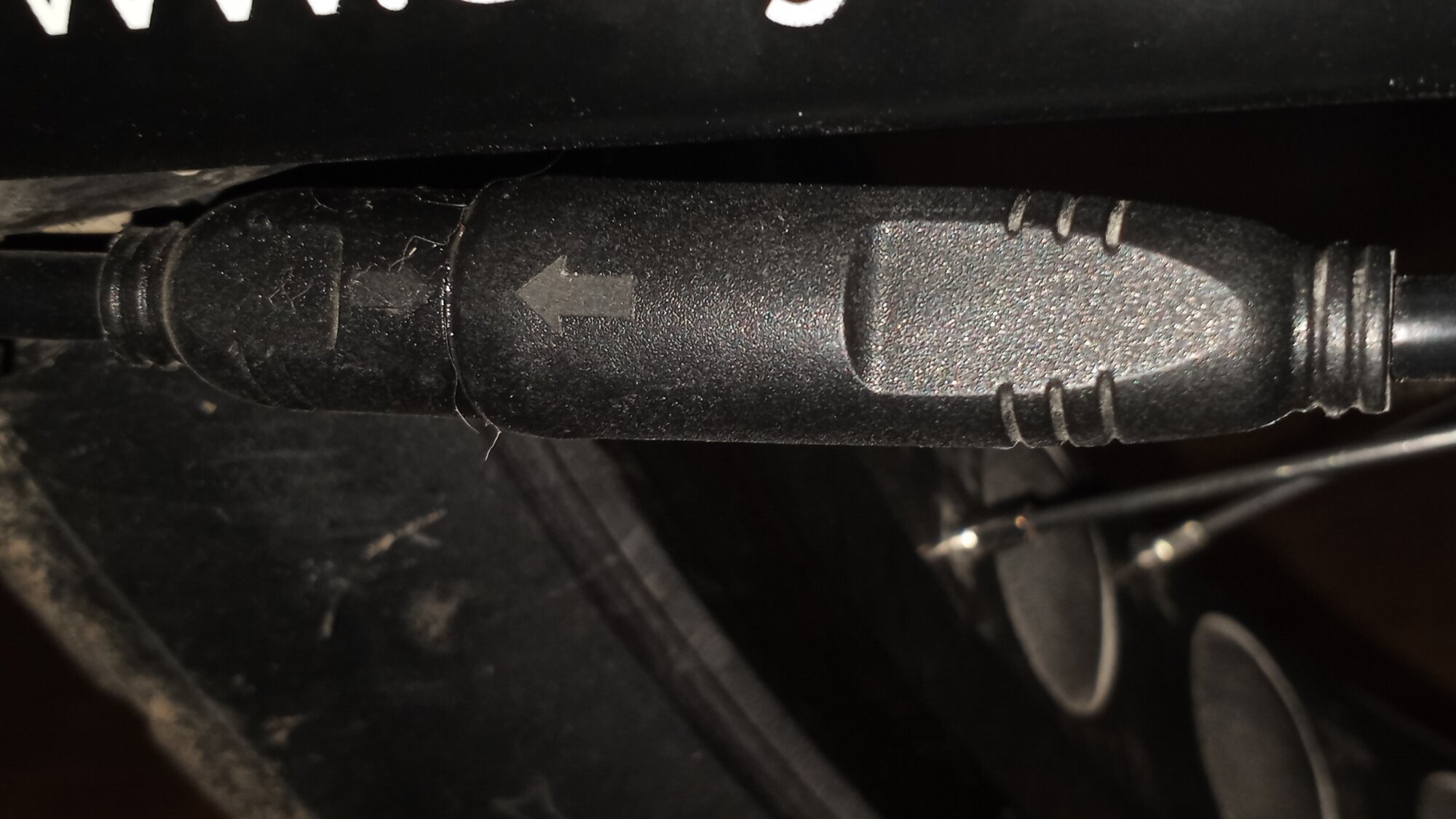

Ok, I understand that this is probably the stupidest question ever posted, but how do you undo the wire connectors to remove the rear wheel. Twist, pull, pull harder? I just don't want to brake anything 🫣

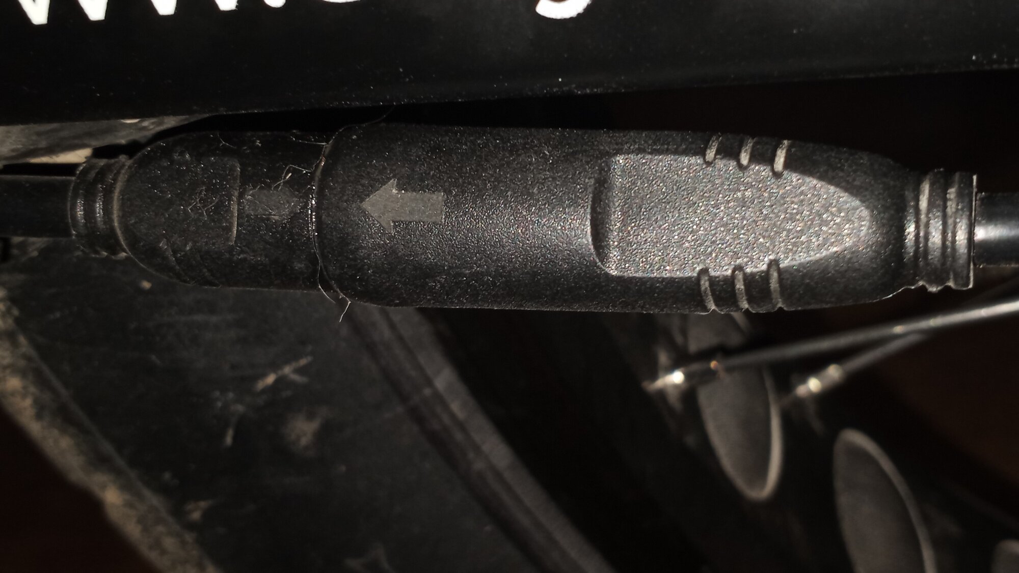

As a follow up to the above, I 'll add that I've been a mountain biker forever, but brand new to e-bikes. The bike in question is an Aventon Level.2, which seems like a pretty decent bike for the price - but the owners manual is a joke.
If you look closely there are aligned black arrows on the two sides of the connector. I often put a dot of color on each. You can use a couple of plyers to pull the straight apart. They go back the same way. Do not twist.
Wait, what? Mine has a silver ring in the middle which connects the two halves. You have to unscrew that and then pull straight apart.
I found that if you wobble the joint a little as you are pulling, it helps to get it apart, and then you don't have to pull as hard.
I put dielectric grease on the joint when I put it back together.
It helps prevent corrosion, keeps moisture out and makes it easier to get apart next time.

EDIT:
I don't mean to twist it, just bend it a smidgen back and forth as you're pulling.
It's plastic, it's got a bit of give to it.
(Mine is anyway. I don't know what's on the Aventon?)
