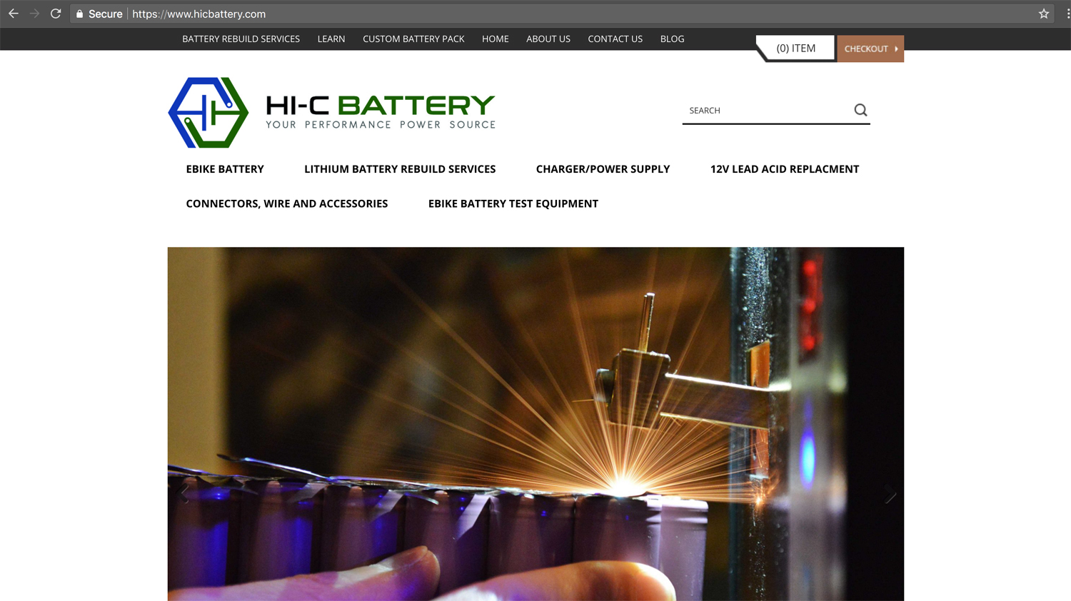

The second, more recent, resource I discovered was called Hi-C Battery. This happened when I was in Denver, Colorado filming reviews for Electric Bike Outfitters. The founder of Hi-C is Patrick Duggan, a former automobile mechanic who lots of shops in Denver know and have worked with for their own battery needs. Patrick is a high-speed kit guy who not only repacks and repairs batteries, but also tries to upgrade them to offer more capacity. He and I spent some time talking on camera and that is included in the EBO tour video here. Patrick has been super friendly and responsive in sharing what services he is working on offering and asking for feedback about his website, which looks pretty good.
In my experience, Patrick has been the most responsive and seems to offer the widest range of services for ebike battery repair and repacking. He strikes me as an expert and my goal in sharing with you here is to help reduce waste by recycling and re-using existing ebikes vs. having to buy a new one. Many companies, including Bosch, seem to have their own programs and replacement packs available, but many older or smaller companies may not provide this level of support or simply may have gone out of business. I welcome your feedback and links to other great service providers and programs for recycling old packs, tips on shipping with hazmat hazardous materials, and your experience actually working with these companies.
