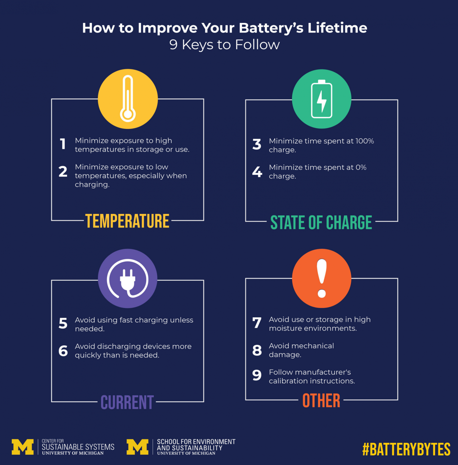

Ravi can best answer the specific questions regarding your eBikes.
For most users here are a few best practices.... hope this helps other EBR members. ;)
Useful tips, but not one word regarding balancing, which should be at least mentioned in any conversation regarding "best practices". Which is my other point....
So why not just charge to 100% every few cycles?

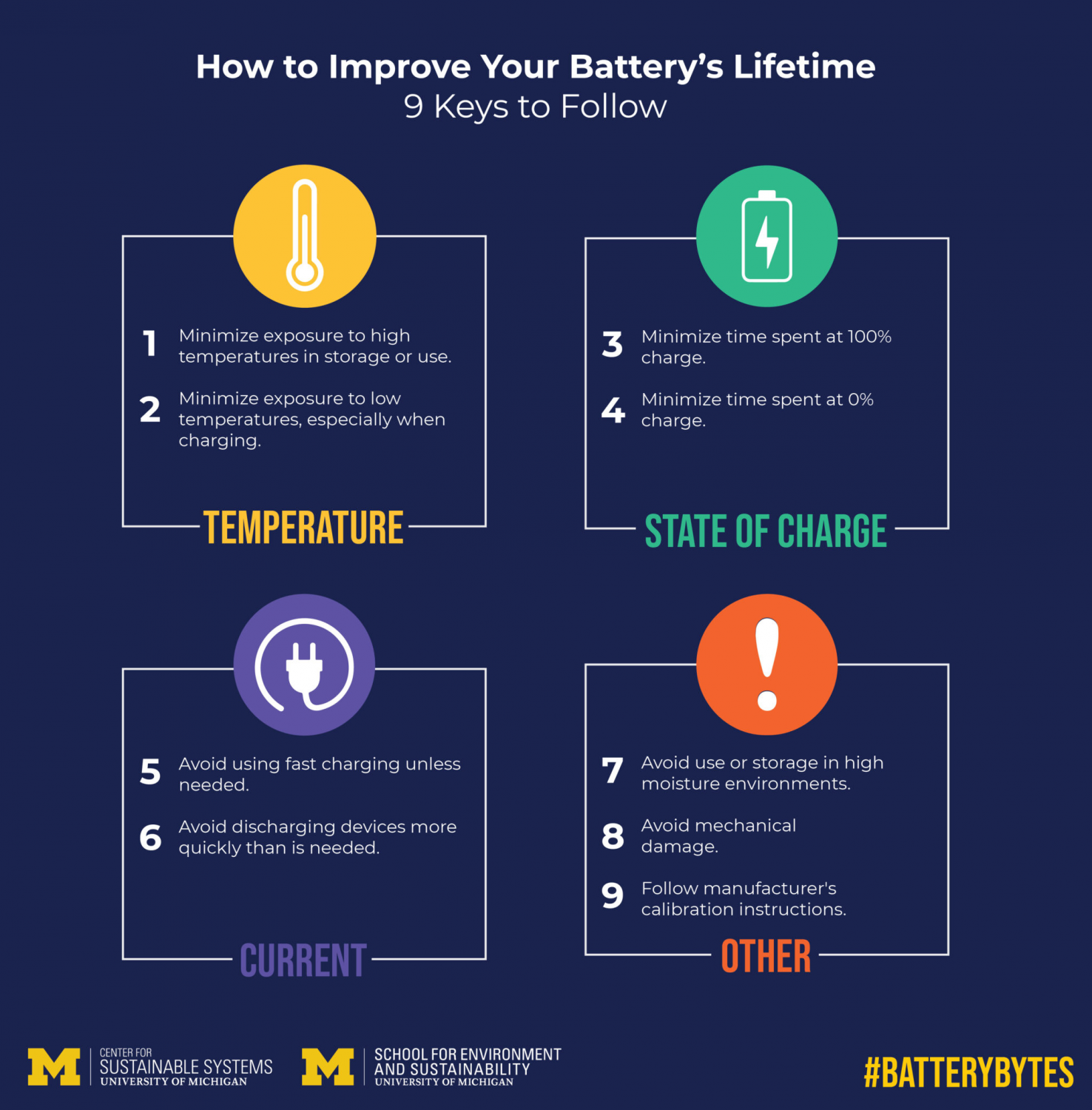

If folks can understand just this chart, then can forget everything else about battery care.
This was produced by the University of Michigan battery research institute and the scientists know what they are talking about.
