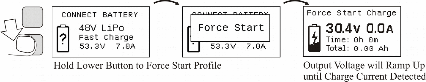

On one of my batteries, my Satiator will not start until I press the "force start" command on the Satiator menu.
See this thread for force start information. https://endless-sphere.com/forums/v...p=1552601&hilit=satiator+force+start#p1552601

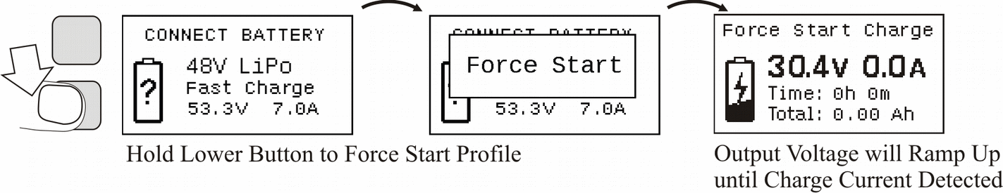

5.1 Force Start
In some scenarios, you may have a battery attached to the charger but the charger still says CONNECT BATTERY. For instance, this can happen if the battery has been drained so low that the battery management system's (BMS's) protection circuit inside your pack has shut off and disabled the battery output. If there is no voltage on the battery terminals, the charger will be unaware that a pack has been plugged in.
Figure 28: Force Start if battery not detected from tripped BMS
In this situation, pressing and holding the lower button on the CONNECT BATTERY screen will force the charger output to go active for a few seconds in order to begin a charge process. If it detects current flowing into the battery at a voltage

higher than the start voltage for the selected profile, the normal charge process will begin.
View attachment 80547 View attachment 80546
