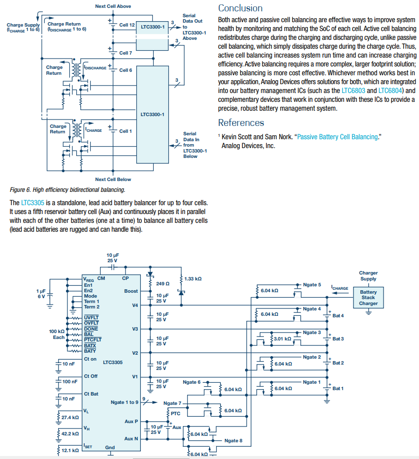

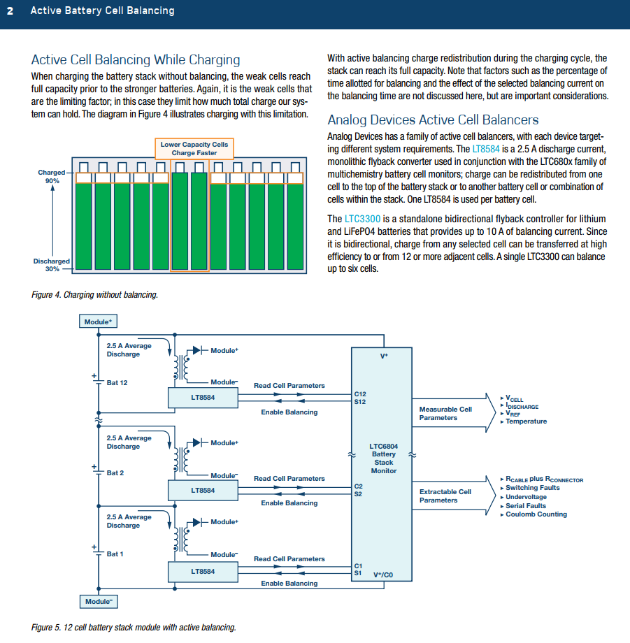

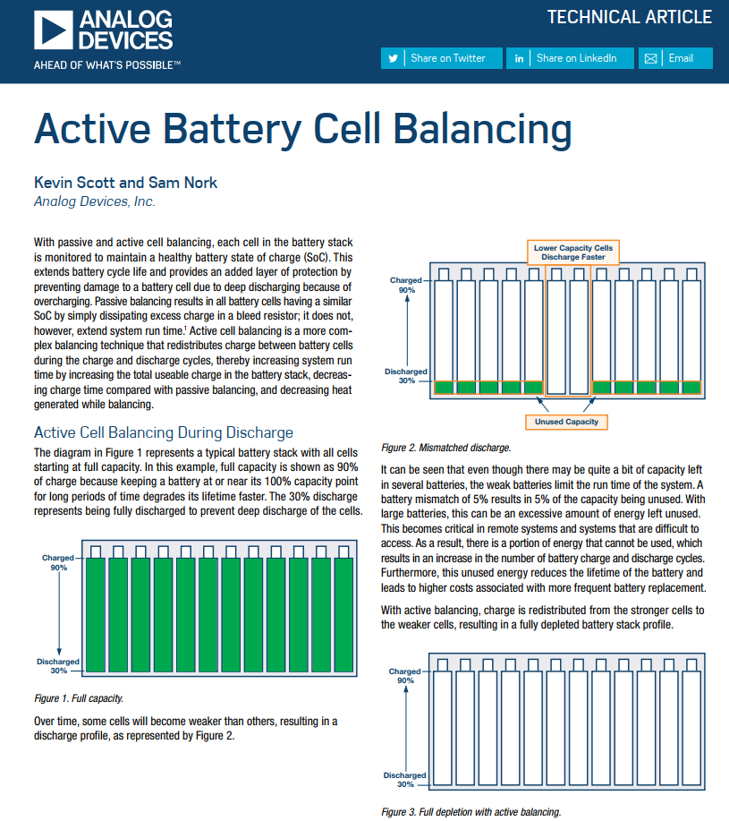

Thanks for tagging me in. I spoke with a friend of mine who has many years of experience designing BMS for battery packs before replying here.
You are right about the parallel groups but you need to balance the cells in series as well. There are many ways to do that and it is not as easy as it may seem. The summary is:
  1. Passive balancing is more common in BMS boards where cost is a major design constraint and it makes use of bypass resistors. This kind of balancing works when you are charging the battery pack and not when you are discharging. Packs that can be be purchased for ~$250, it may most likely use one of these bypass resistor based balancing circuits.
  2. Active balancing on the other hand is more complex and needs more components in the BMS board. What you are referring in your question comes under the gamut of active cell balancing where one cell transfers the excess charge to the next cell. To transfer this charge, the circuit needs to know when to initiate this process, when to stop this process, how much to transfer etc. This necessitates a few more components, larger footprint and I frankly don't think run-of-the mill E-bike batteries can afford that. To explain the complexity of your question, I am attaching this document by Analog Devices ( which is a well respected company just like Texas Instruments). They explain it much better than I could do now.
