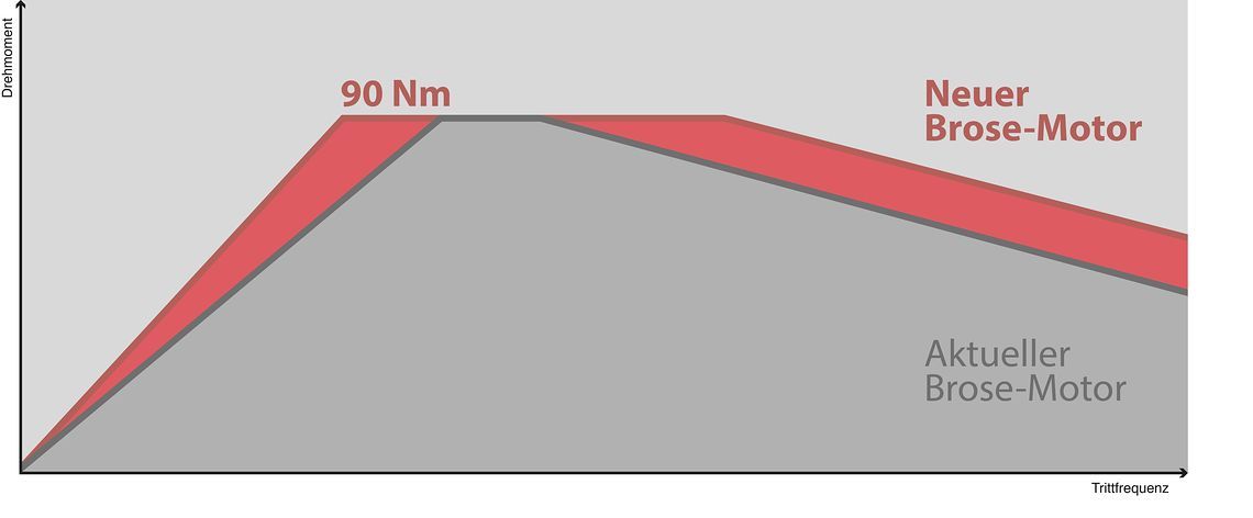

I found this chart for the Brose 2018 motor to be interesting.
I certainly feel that both Yamaha and Brose put out more torque.
That Brose torque vs rpm graph is very interesting. My calculated guess is that the red curve comes from the new Brose S drive. The peak torque has been expanded about 35% in both the lower and upper RPM range, so if the original upper was in the 80 rpm, the S drive continues to supply 90 NM up to ~108 rpm. That also correspond to 35 percent increase in power from 350 watts to about 475-500 watts. That would put it's performance profile somewhere in between the Bosch and the Shimano Drive.

There is clearly something wrong with the graphs in post#1. The Bosch CX motor outputs zero watts at 120 rpm. The graph shows it as 400W. If you extrapolate the graph forward, it would max out at 160 rpm, when in practice, it maxes out at 120 rpm. Somebody got their data seriously wrong. I don't believe that any of those motors make power past 120 rpm. Only the Yamaha one looks approximately correct.
