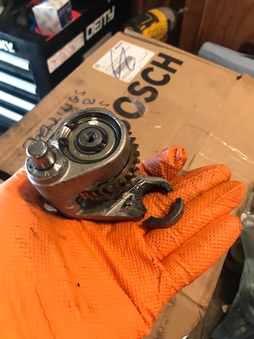

Two days after I sent my CX motor to EMR, I got a detailed email saying that the cause of my motor's roughness was a damaged "deep gear cluster" (pic below). I lucked out because they'd never seen this before, but happened to have replacement part on-hand. It was also recommended that I have them do a complete overhaul while the motor was "open." A bit more expense for more peace of mind made total sense to me!

@William - Bosch Team - have you seen this "deep gear cluster" armature break before? Again, EMR hadn't seen it before and it didn't cause motor failure, though it was probably just a matter of time because it was apparently flopping around inside the motor housing...
