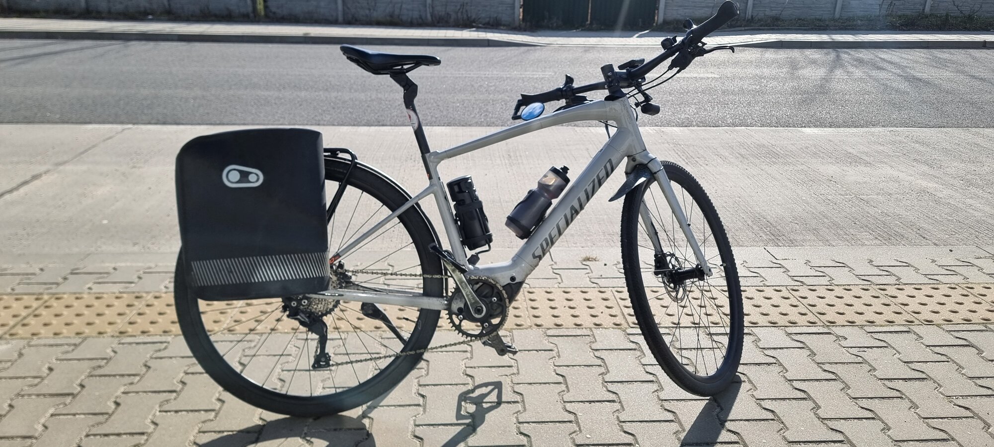

The current price of Specialized Vado SL 4.0 (non-equipped) is US$3,500.
