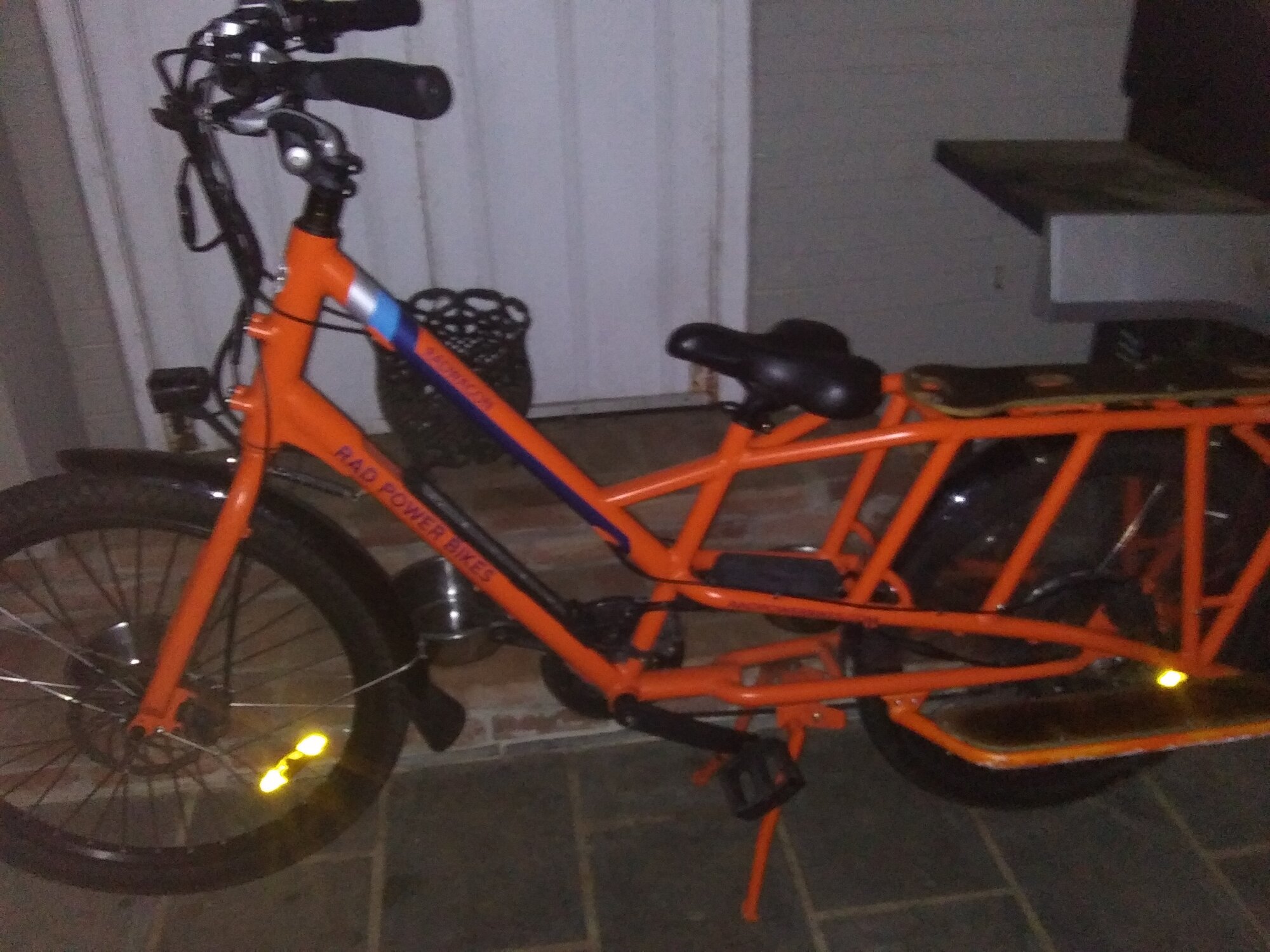

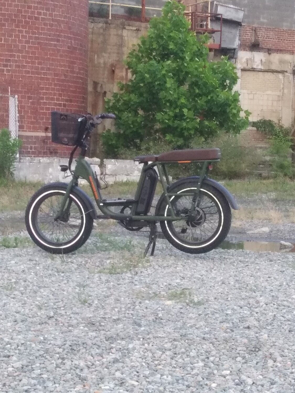

I rigged up my XP's 48v battery (Samsung 35e cells, 30amp bms, 14Ah) to my X3's controller/LCD and it worked great. Upgrading to a 48v battery does increase performance but I didn't get to do a real test drive. I'll do that once I order my X3's dedicated 48v battery.
