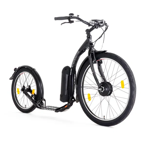

So, okay. A vehicle suited to being externally powered, with nice anchors and a lightweight, minimal frame. Stands to reason someone would electrify one. And they have.
But weirdly, IMVHO. Why a front hub motor rather than the rear? And 'ugh' to yet another ugly plastic lozenge battery case.

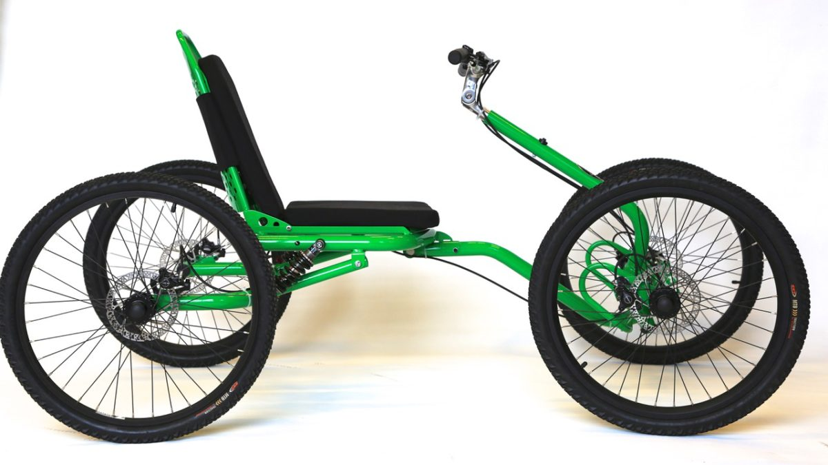

But it did get me thinking about other things that are dog-powered, like the green 'urban mushing' cart I posted in another thread.
Born for a series of hub motors if anything ever was, eh? Shame about the $5k pricetag...

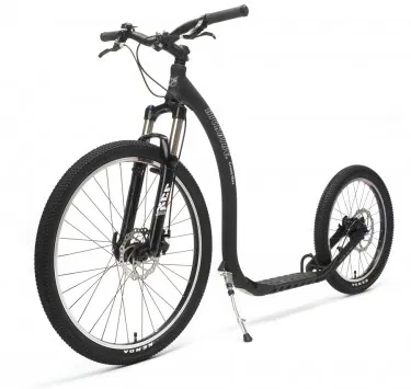

So I started looking around and the two best/only candidates for a build both come from kickbikesus.com, which is the US distributor for Kickbike Worldwide. There's a fat-tire version that screams, 'overpower me!' at about a grand, and two 'cross' models with nice brakes. They've got 26" wheels up front, and 20" at the rear that run just under $600. Not bad!

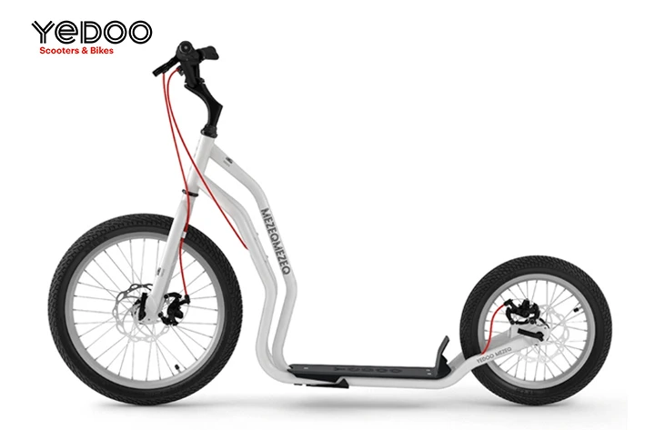

So then I came across this: https://8-elephants.com/collections/off-road/products/yedoo-runrun-mezeq-disc
Mechanical disc brakes, and a 20" up front with a 16" out back on a 100mm axle: perfect for a little 500w geared hub kit, no? I was thinking I'd forego the PAS (obviously), and even the display if possible, and just run the ebrake cutoffs and a throttle, and let him carry the battery and motor controller in a backpack for stealth and security (all the expensive bits aside from the rear wheel go where he goes, and sit in a locker during school, leaving an apparently nice but acoustic scooter behind).
So any holes in my marvelous plan?
