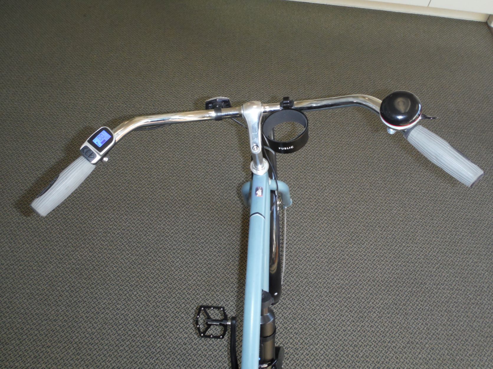

This is totally off topic, excuse me. I just happen to have a photo ready of the cockpit of an electric bike. The same could go with a trike. I like them uncluttered.

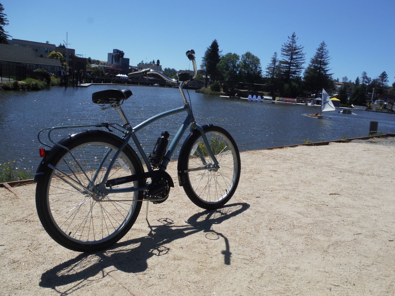

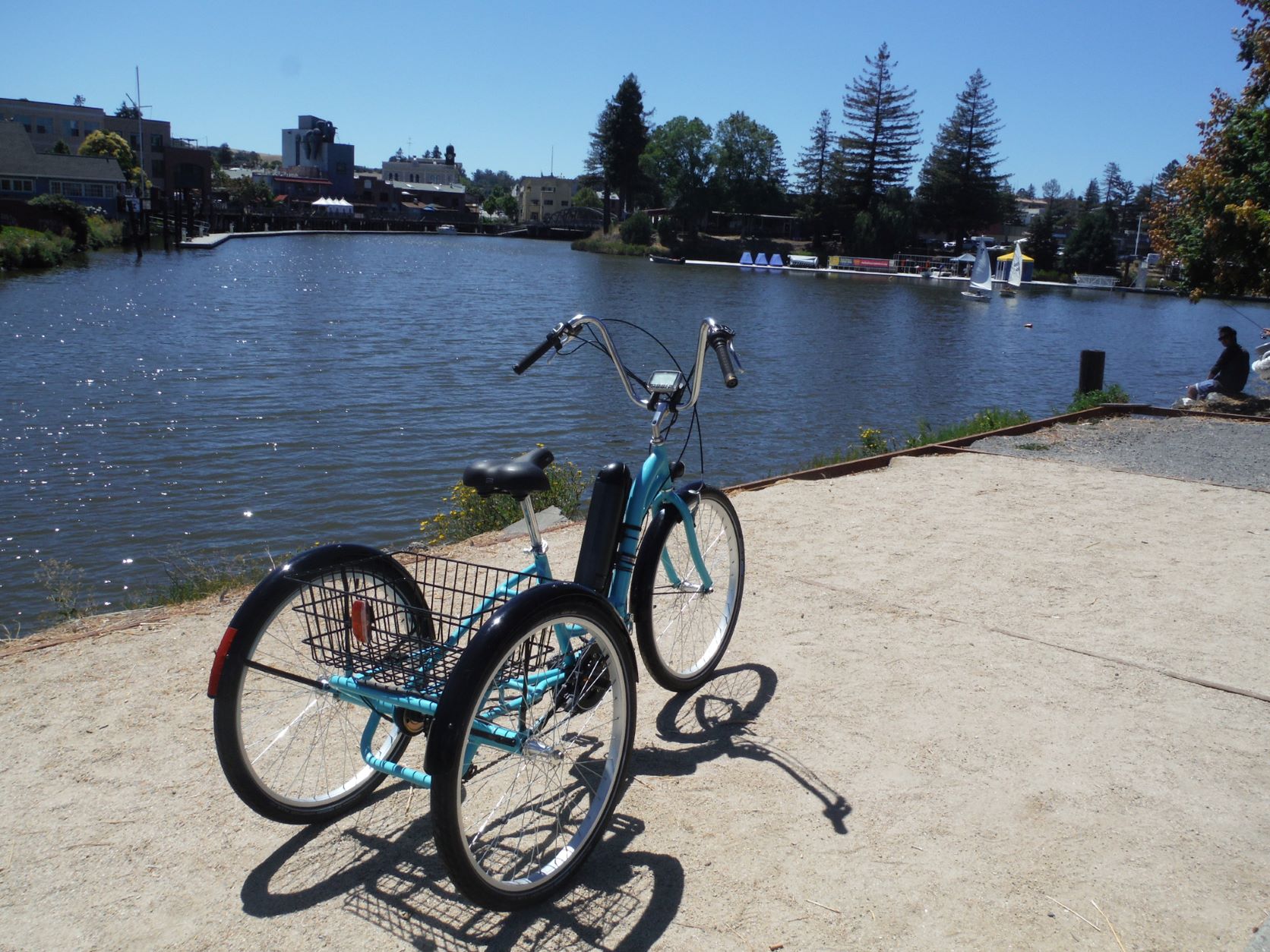

Thanks Kevin! Bikes don't get more simple that that one. It is a single speed cruiser with a coaster brake. I pulled the display wire thru-frame. Here is the side view and a trike from before I knew how to do clean builds. The new cargo motors are so smooth, quiet, and strong. That trike is a folder from Walmart five-years ago. The seven-speed starter Trike was $329 with free shipping. I Installed better, brakes, tires, and touchpoints. In looking at the photo again of the cruiser, I do not think most people could identify it as electric. See the chainguard?
