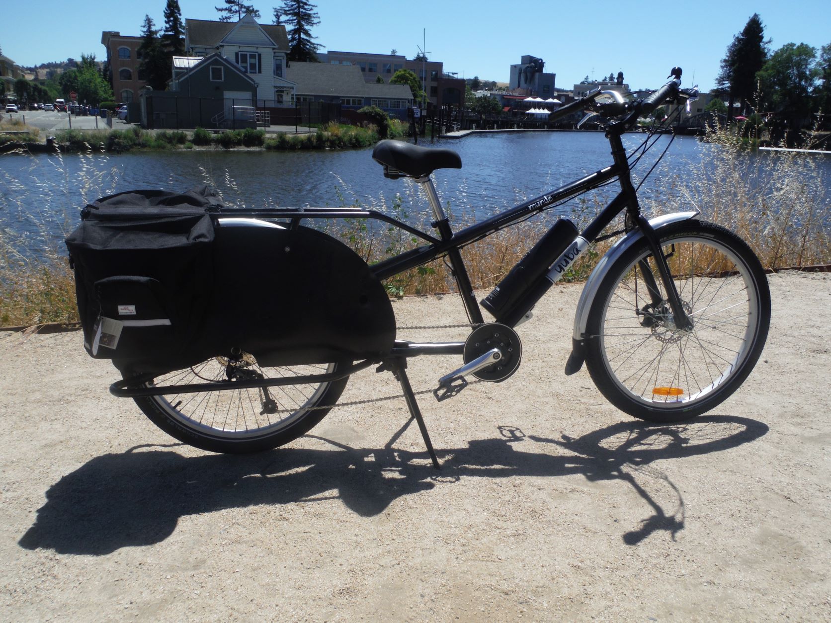

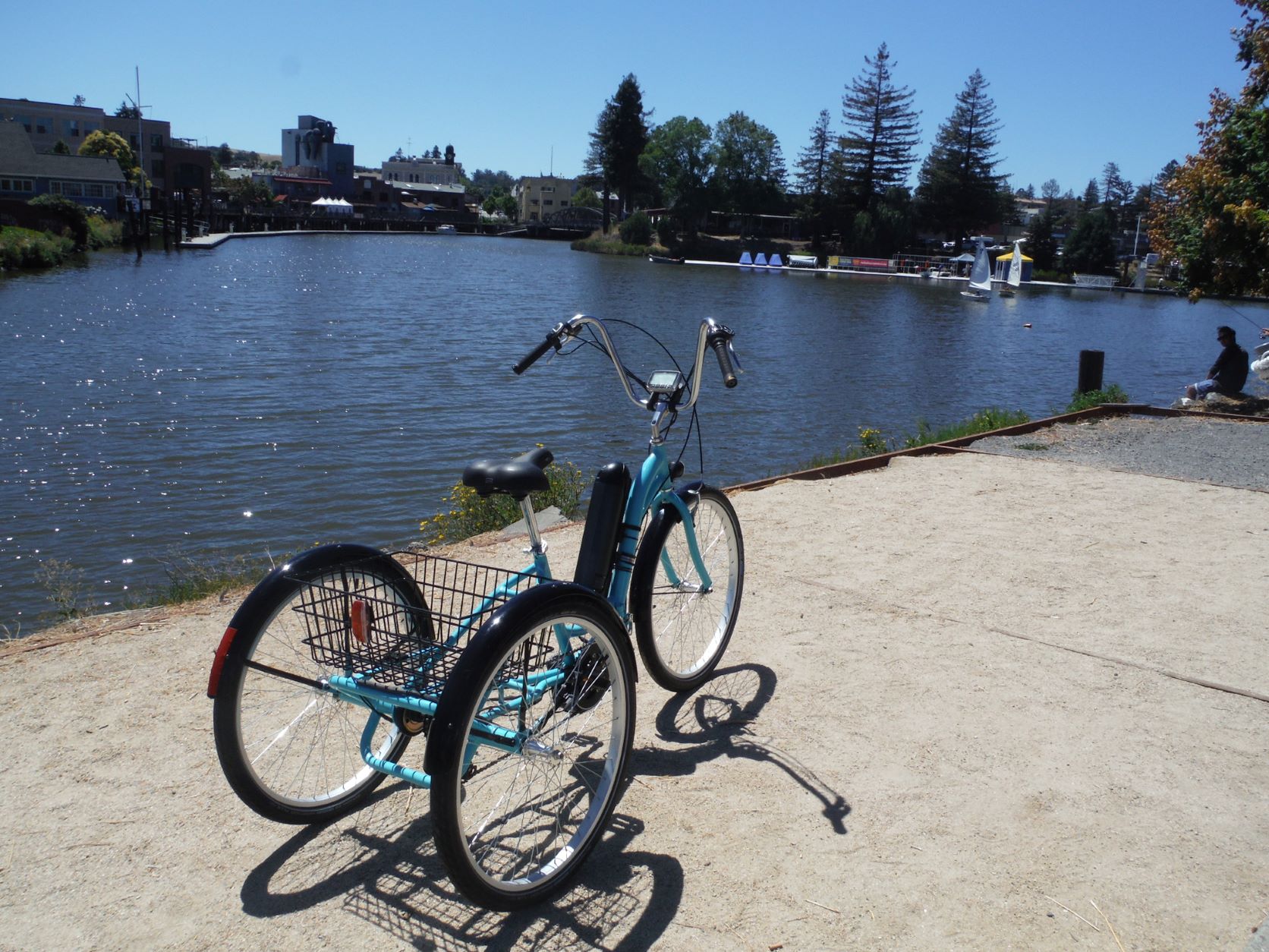

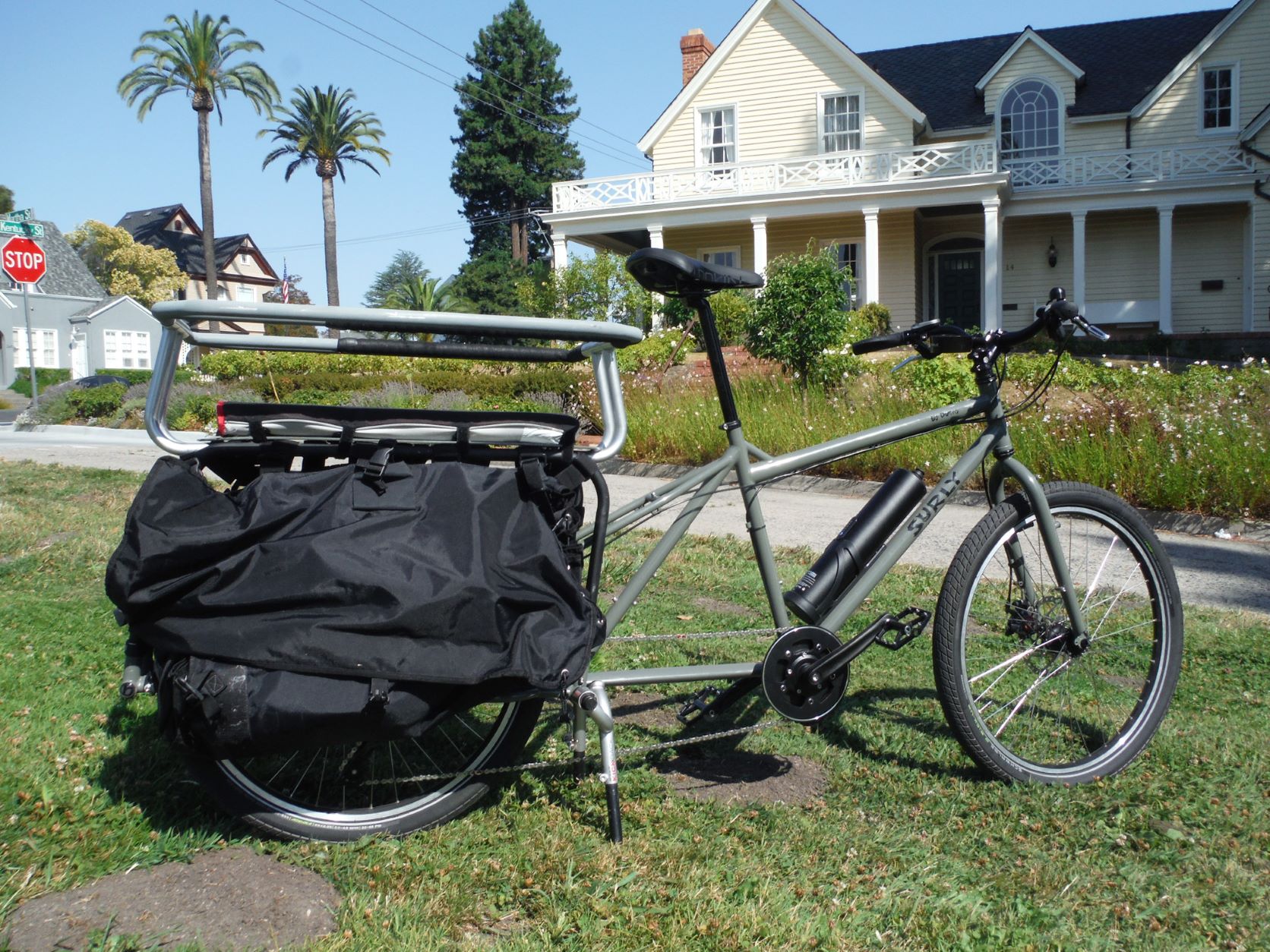

Ridding an eTrike takes practice. It is a two dimensional object. Flat. Typically only one wheel is driven. That makes left turns different than right turns. You need to practice figure eights in all sizes and speeds. Then do the same on a slope from every angle. A mid-drive cargo bike would be far preferable. Here are some of mine.
