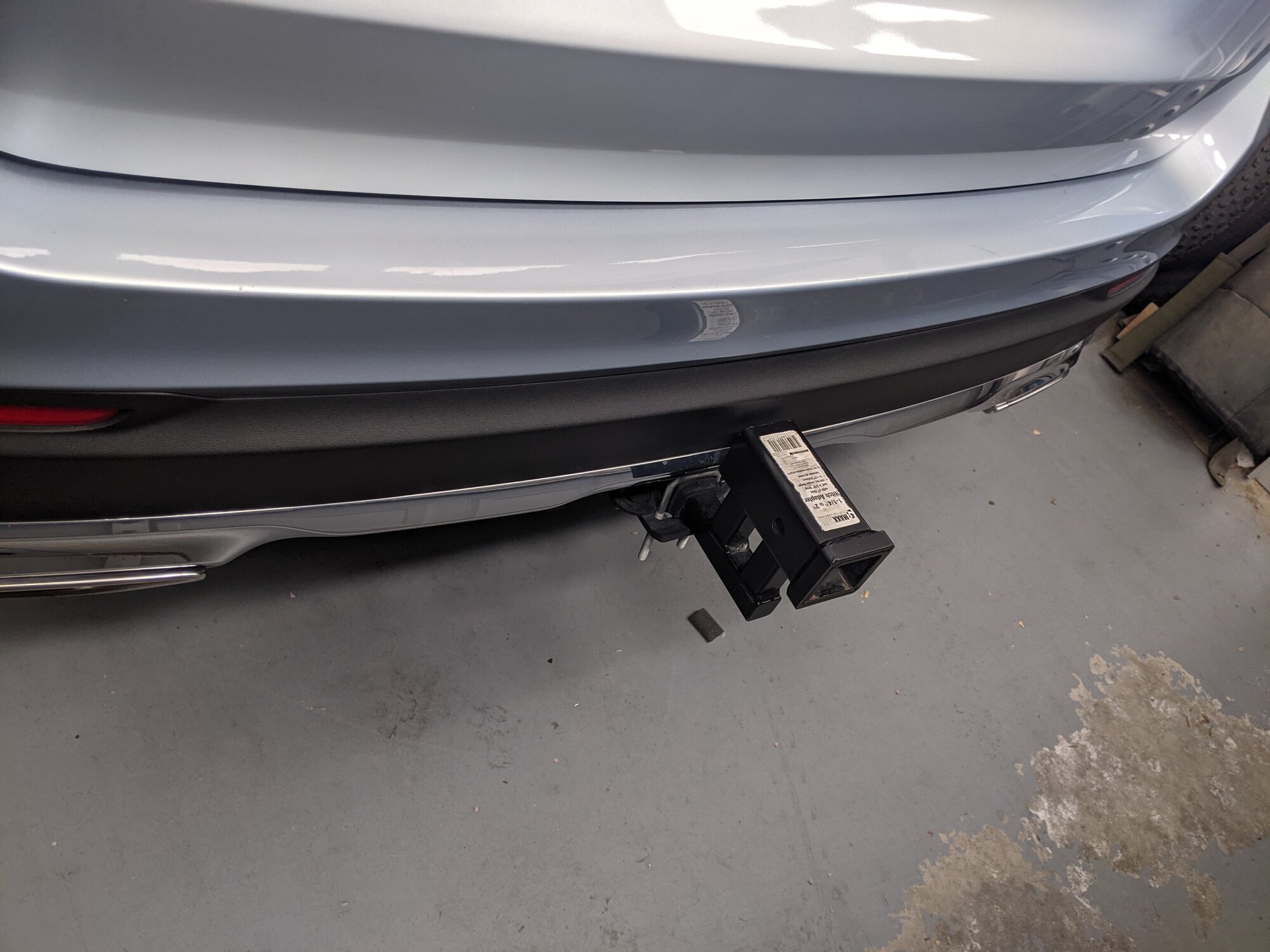

My dealer wouldn’t install a 2” receiver hitch on Mazda CX5 as the manufactuer only offers a 1 1/4”. I went to an auto accessory company and had them install a Curt 2” receiver. I won’t be exceeding the weight limit even with two ebikes on the rack. I’m using a Hollywood rack for Two ebikes. They specifically state to not use a 1 1/4” adapter as it won’t handle the stress placed on it. I think the dealer doesn’t want to take a chance with someone trying to tow a large travel trailer or yacht. 😄

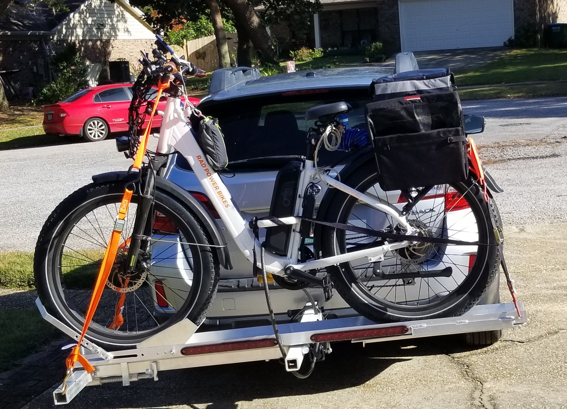

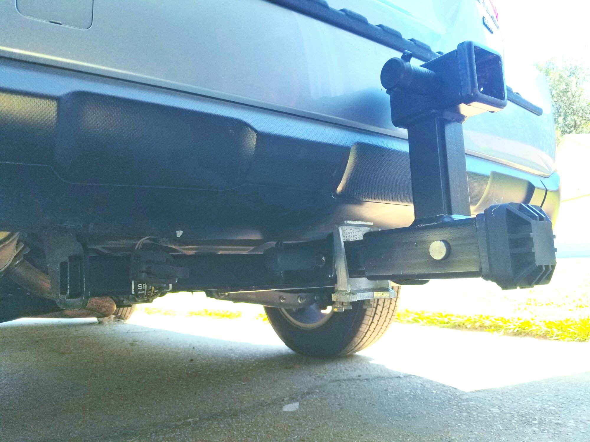

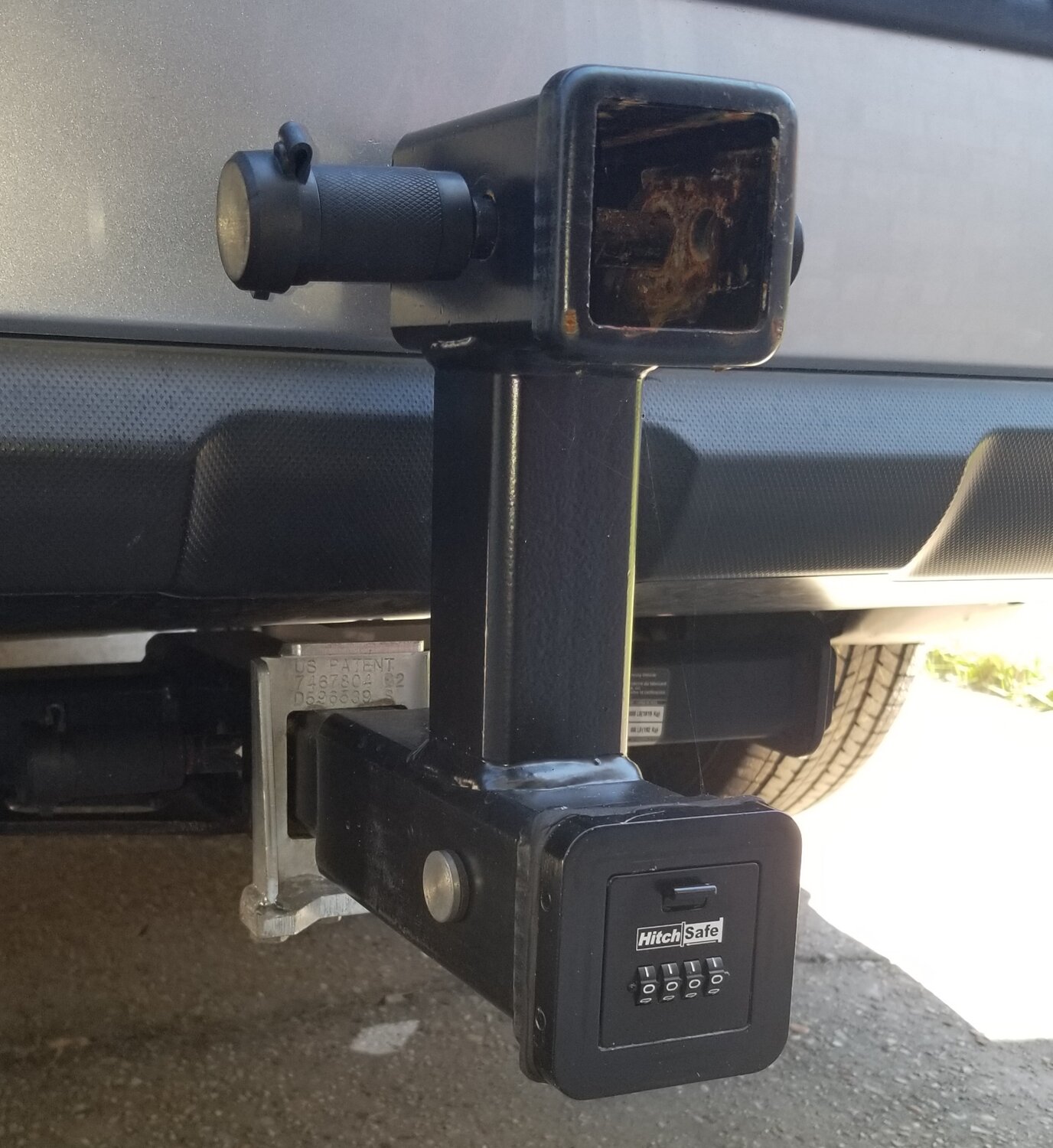

Here is my hitch adapter. Its REALLY sturdy and is much, much shorter than an adapter that does not have a riser. It is rated for a tongue weight of 350 lbs so no issue there. Notice I also used a hitch tightener. I use another one on the other connection to the rack. Rattle free on the highway and well up off the ground.
The rack is still $173 at Summit Racing. Everywhere else it has increased to about $350. Motorcycle rack rated to 400 lbs. Totally different world than ebike racks costing hundreds more that you still are barely within spec on for weight limits.
