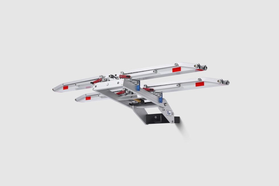

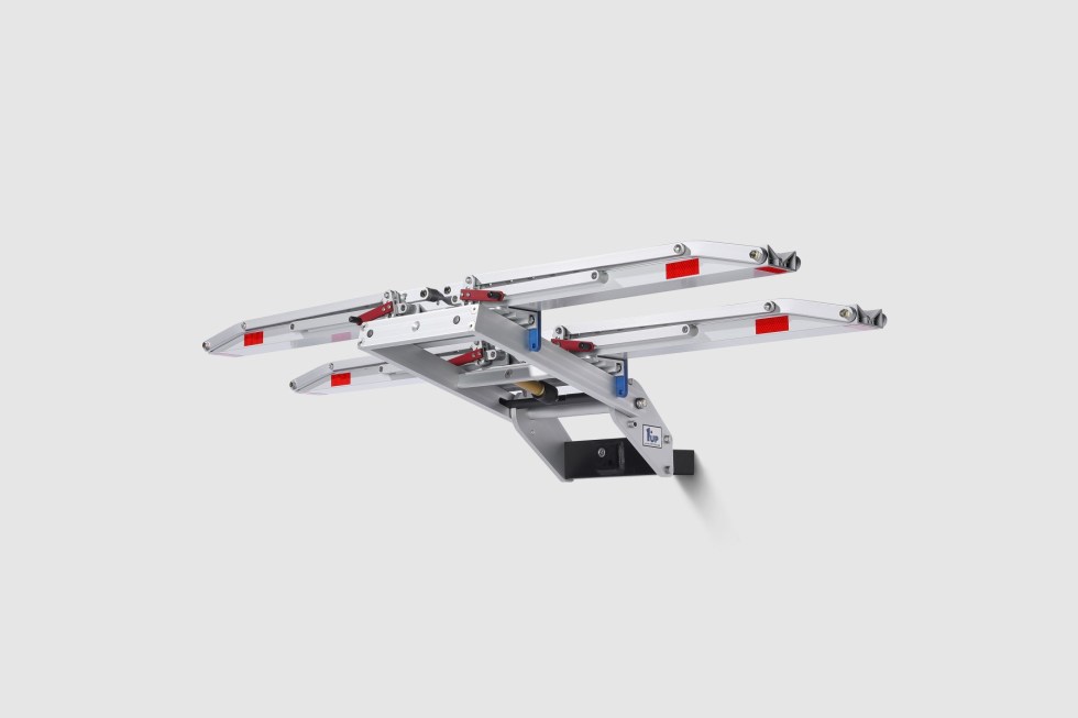

I have this one which is good for 46kg total
Just so happens that both of our ebikes weigh 45kg including batteries :)
We remove the batteries for transportation, so saves 5-6kg
I'm familiar with that tray style rack. Nice choice. I'm not familiar with any frame carry style that are ebike rated, though.
