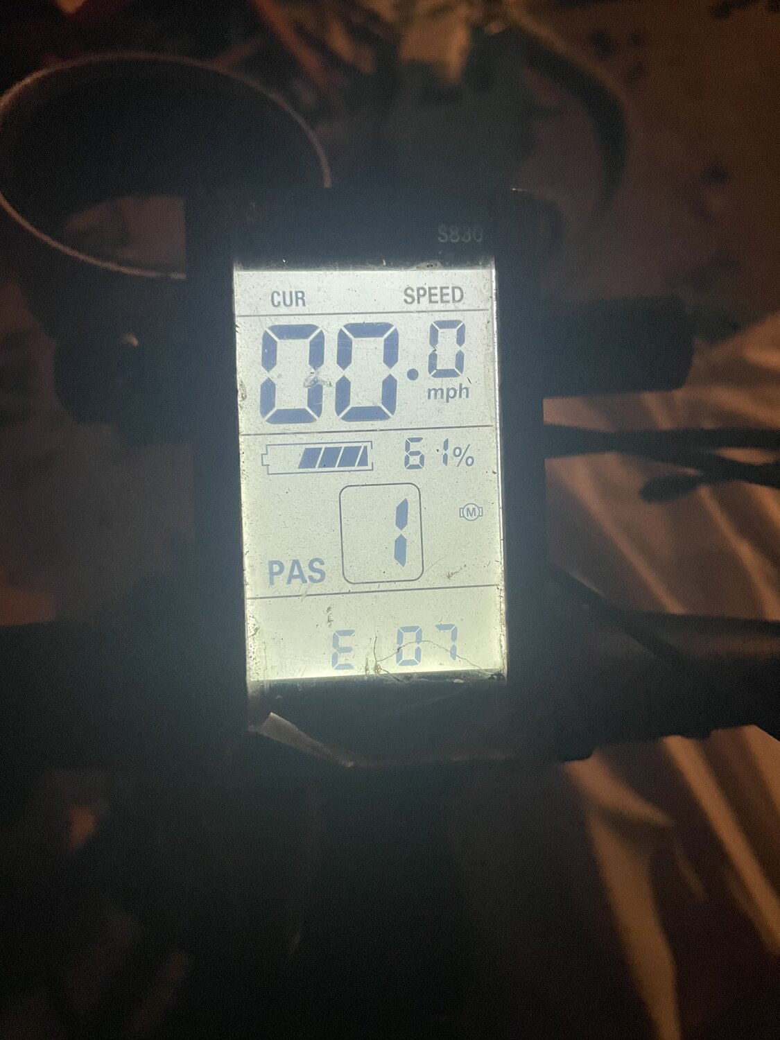

E-07 pops up, motor won’t run? Help
Jitss617
I have invested so much money in these bikes.
This one won’t run. E-07 pops up when I power it up.
Any idea?

Typically, this error is an indication that your motor is at a higher voltage than your controller is expecting.
Do you have another battery to swap in?
Have you checked all the contacts you can?
You might also want to search for Bafang error 7 and see what is suggested.
It sounds like you have more than one of the same bike kit. Swap batteries, then try swapping the display.

Just out of curiosity how can you tell the the controller volts from the picture?

From a quick Google that display says it's good up to 60v...have you set the system voltage in the display settings?

Bafang C965 display for a BBSHD, right? The E07 is high voltage protection, means that the battery voltage is too high.
I recall reading that new BBS02B/BBSHD kits were programmed by the factory to only run on 48V. A fully charged 48V battery comes in at 54.6V. A 52V battery goes to 58.6V. What does it say on your charger for the voltage rating?
If you do have a 52V battery, maybe the new display is set for 48V.
The Bafang kits could always handle 52V, but they couldn't handle owners that rode the throttle hard up hills while lugging the motor and overheating the motor. So Bafang tried to lock out the voltage.
