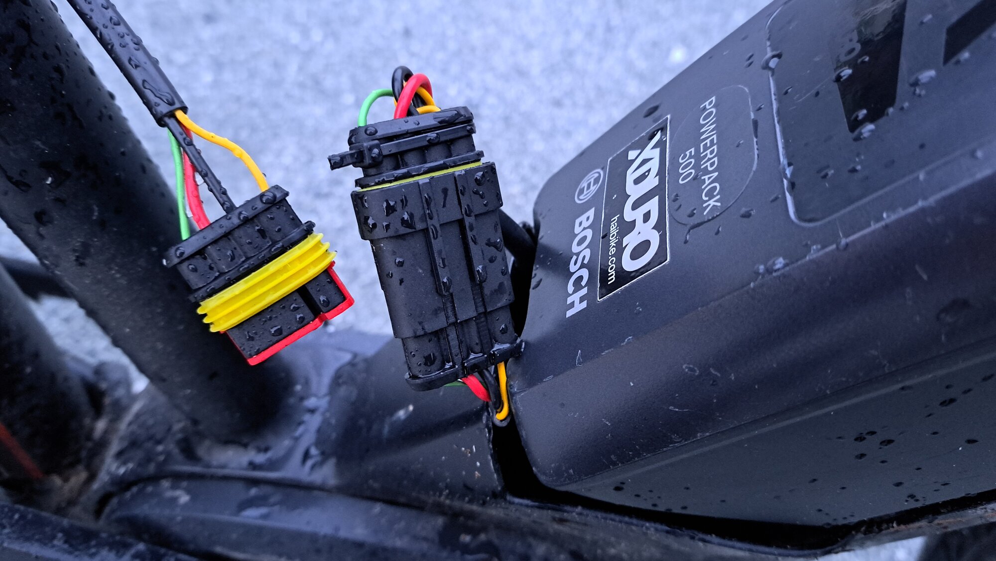

I recently got a used single battery setup Xtracycle Edgerunner 9E with 400 battery and works great. Since I plan to do long distance biking, I bought two 500 batteries and a frame cable, then spliced into the existing frame mount cable by connecting red to red, black to black and the two bus lines the same way. But now, whenever I turn on the system with both batteries conencted, the display immediately turns off saying "See You" like it would show when you physically turn off the display. The system work normally when I have batteries in only either ONE of the mounts, but not both.

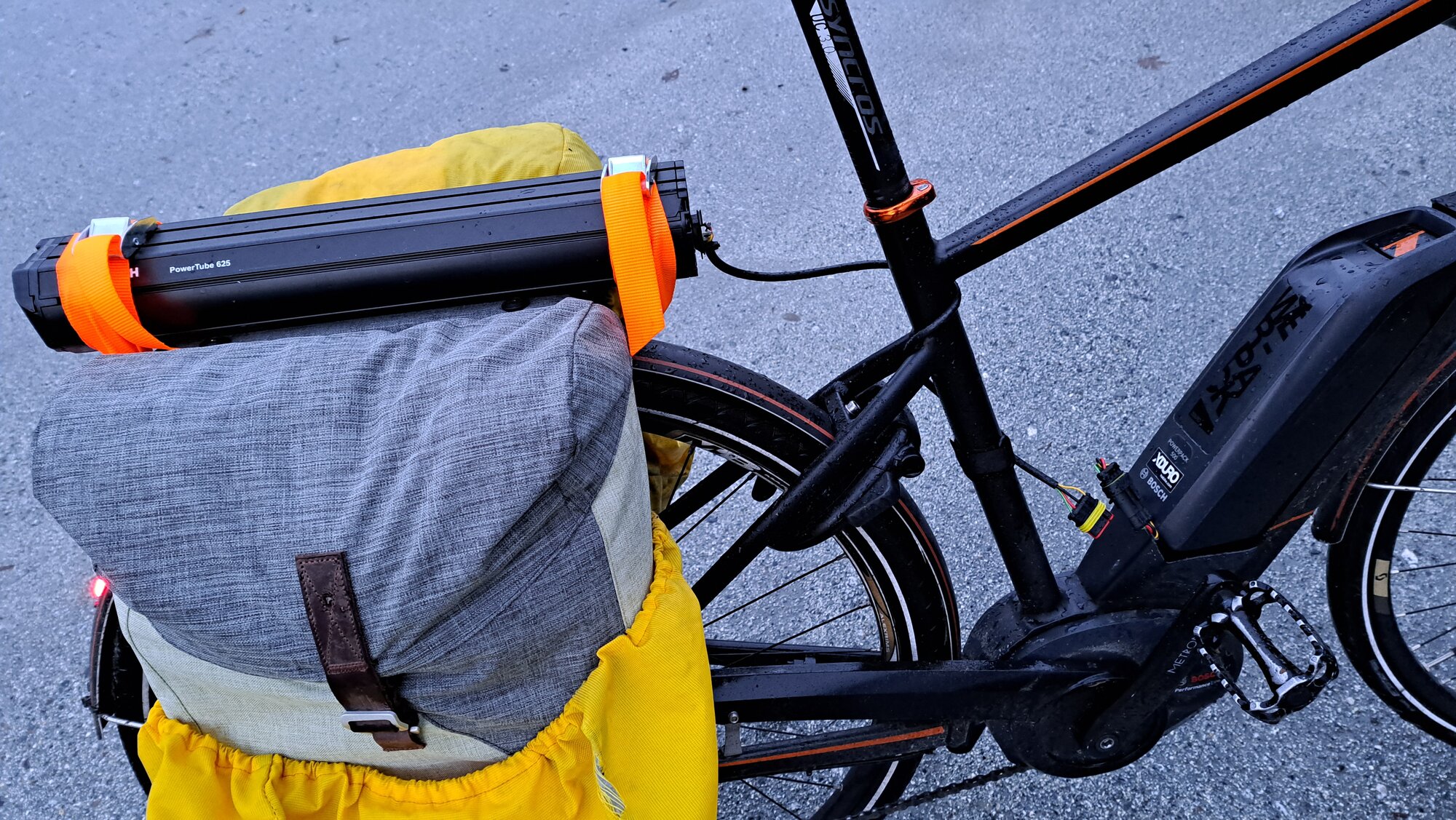

Here is how I do it on one of my bikes:
