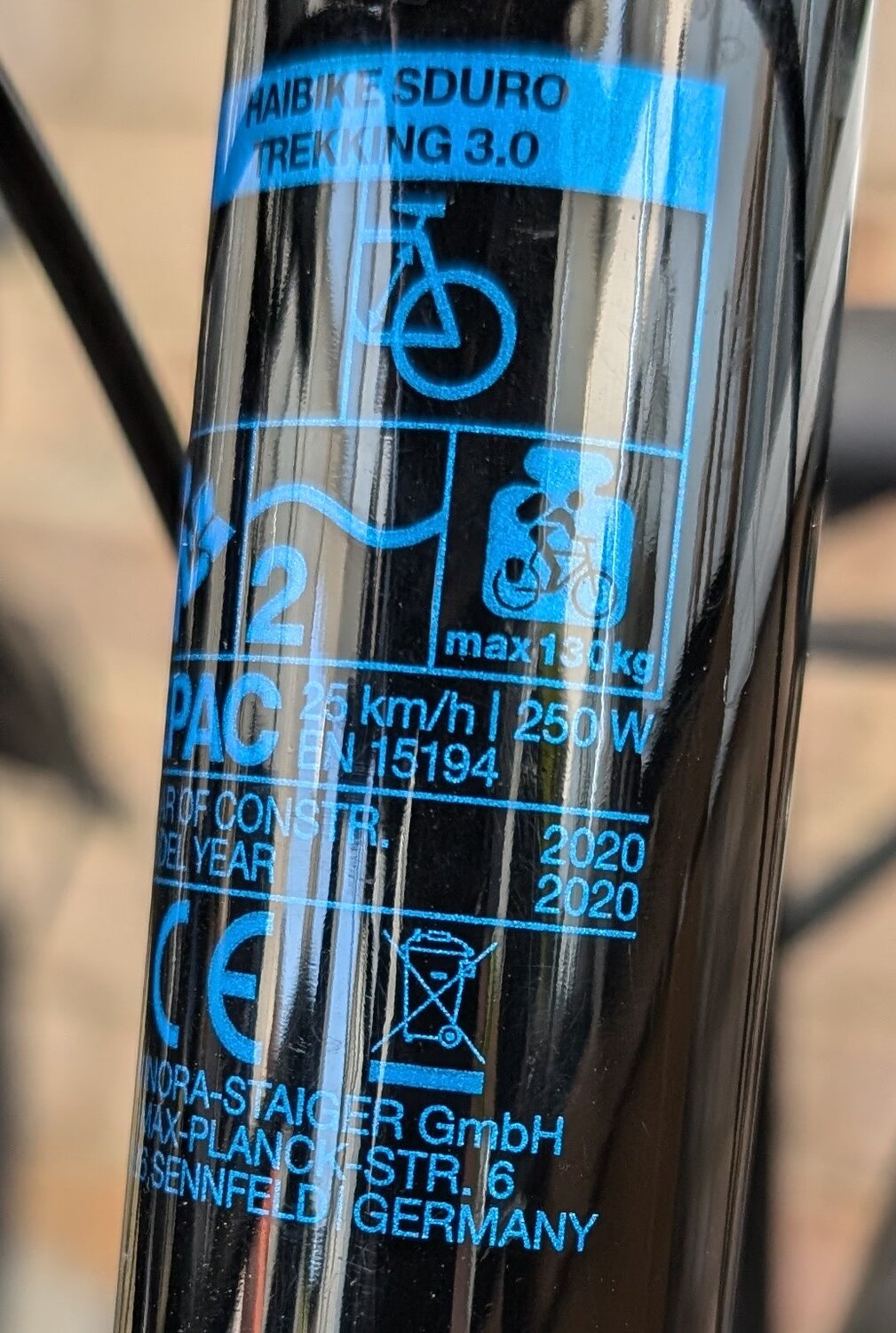

Example EPAC label. This may be on the bike frame or the motor. This is the easiest way to establish legality in the UK and EU.
Maximum output is 250w

Ok geek, congratulations you have earned a biscuit. You totally missed the point that these are buying guidelines for consumers who are unlikely to understand the finer points, and just need the headlines.
The EPAC label that is an essential requirement for legality in the EU and UK only shows the headline power output.
