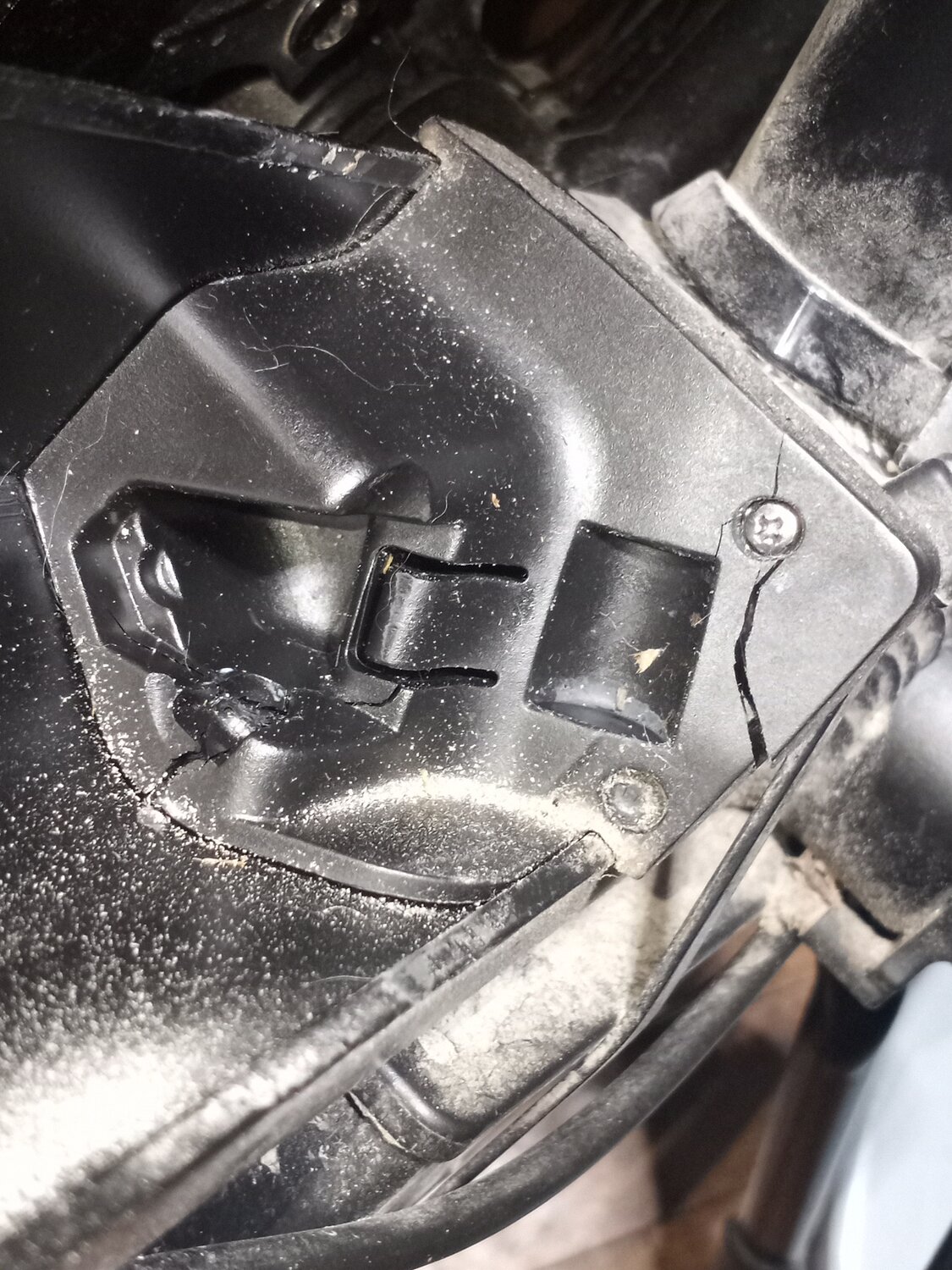

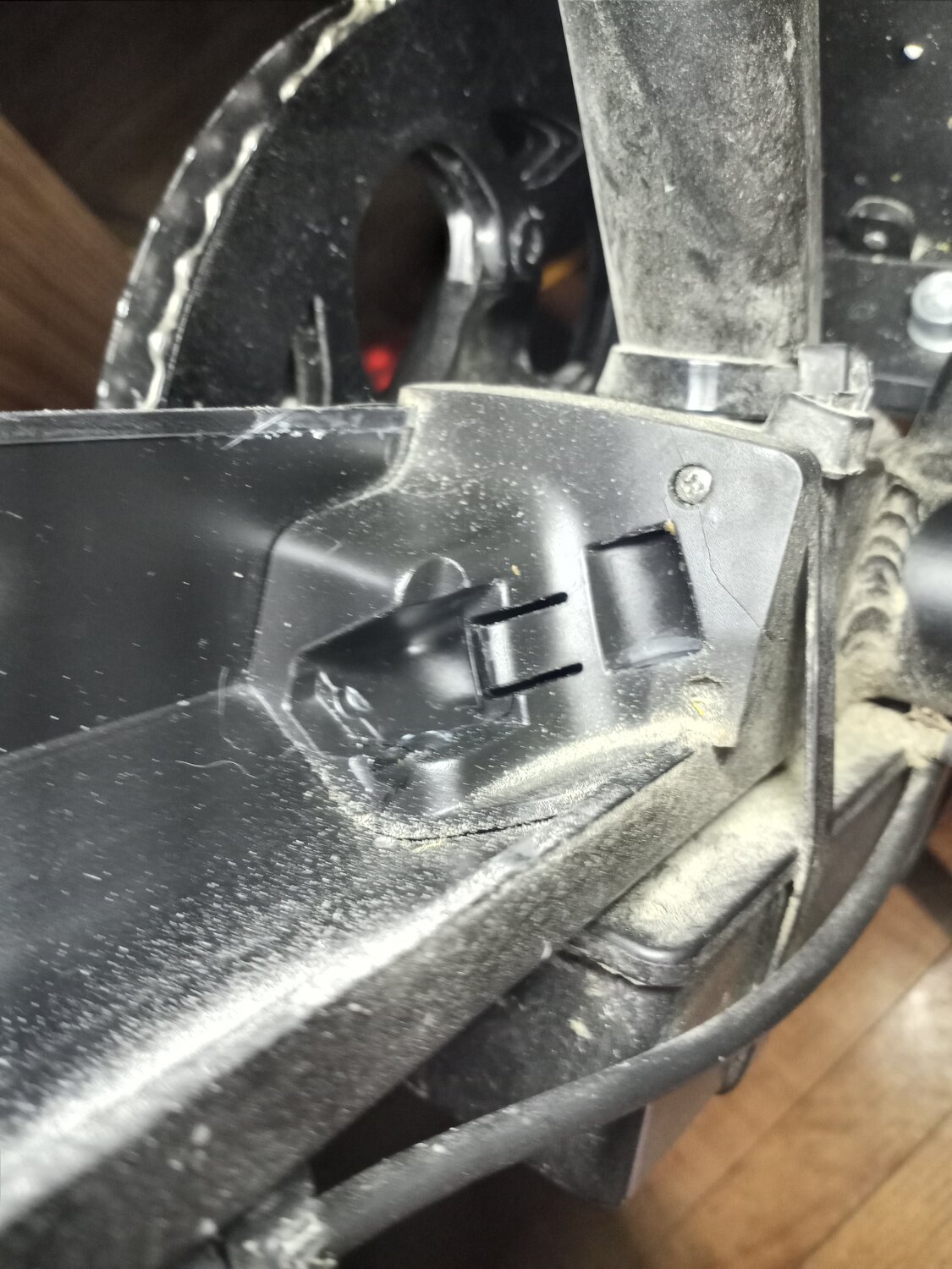

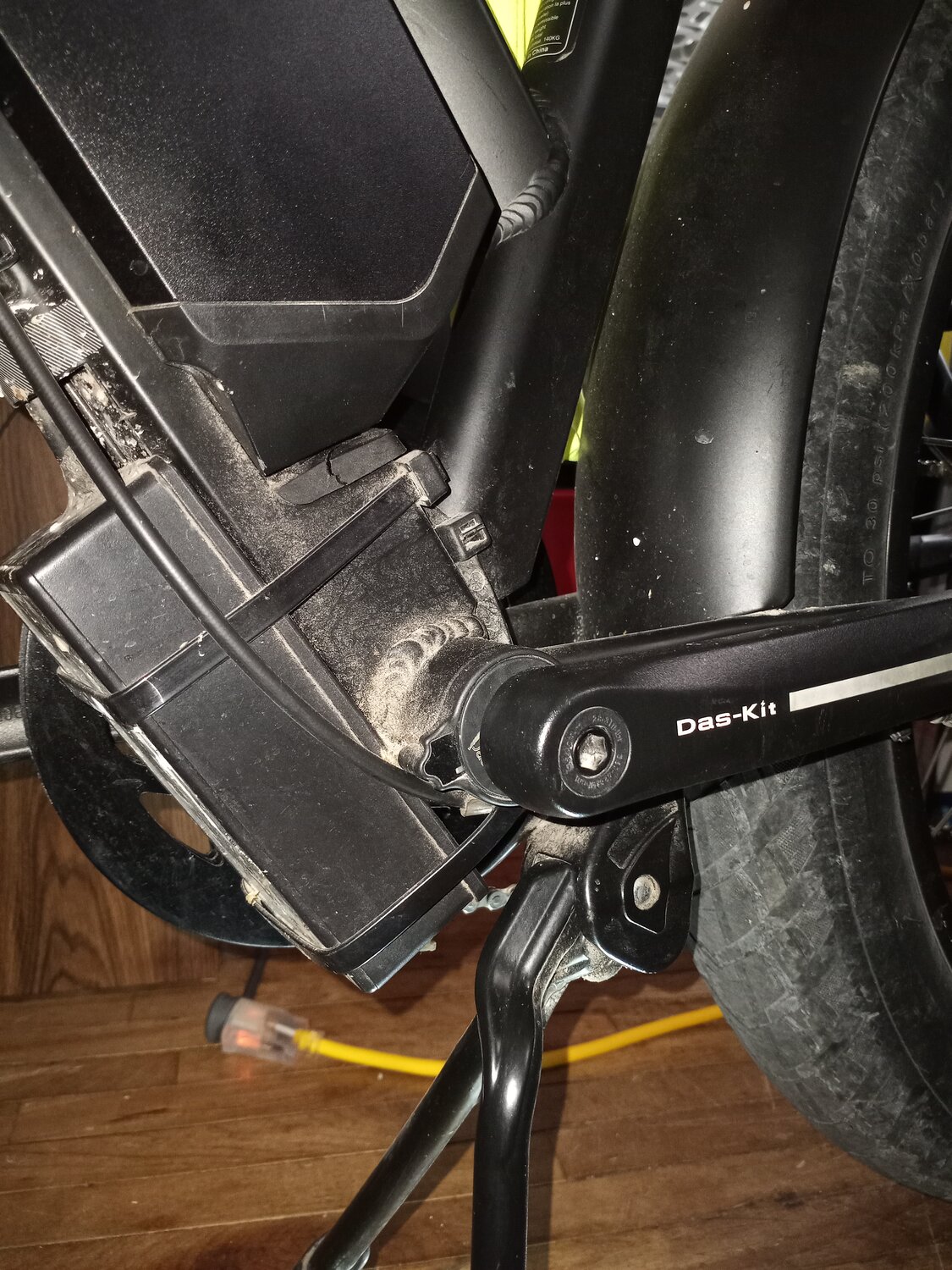

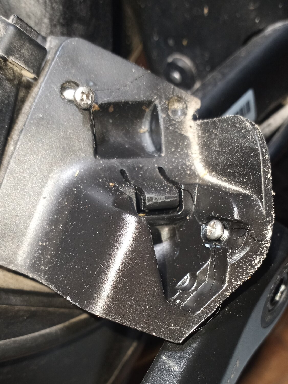

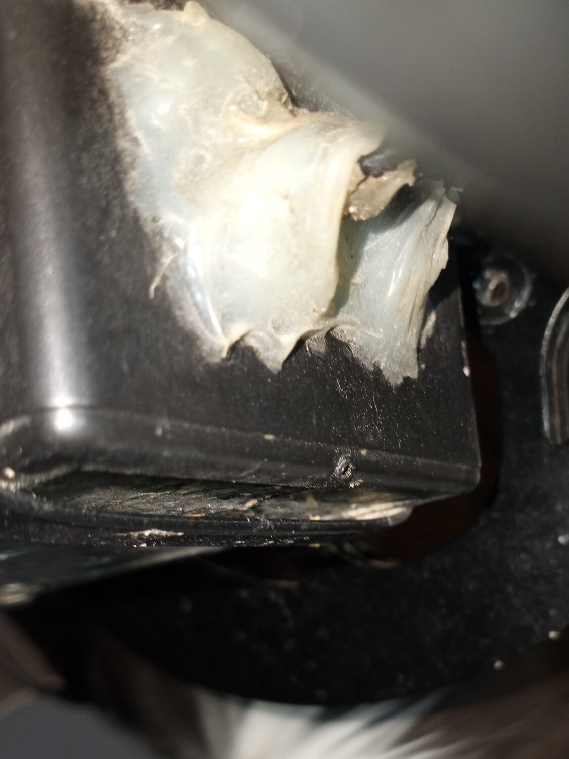

This is my bottom battery bracket.

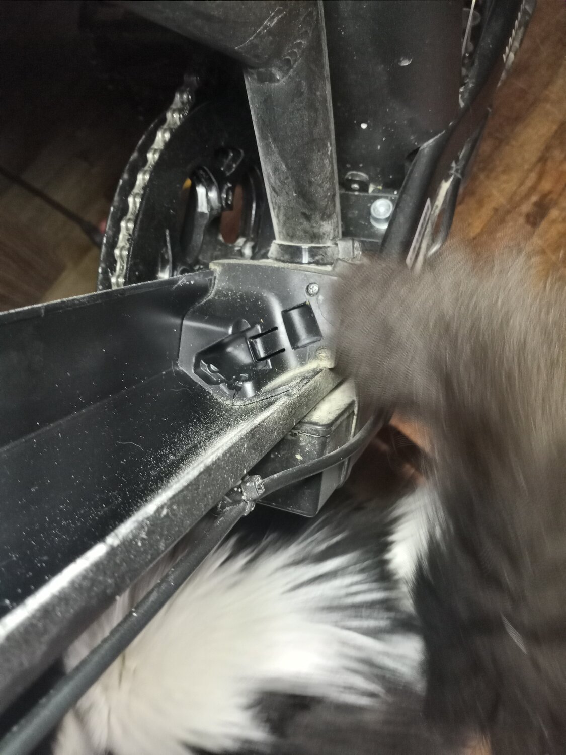

(And my cat)

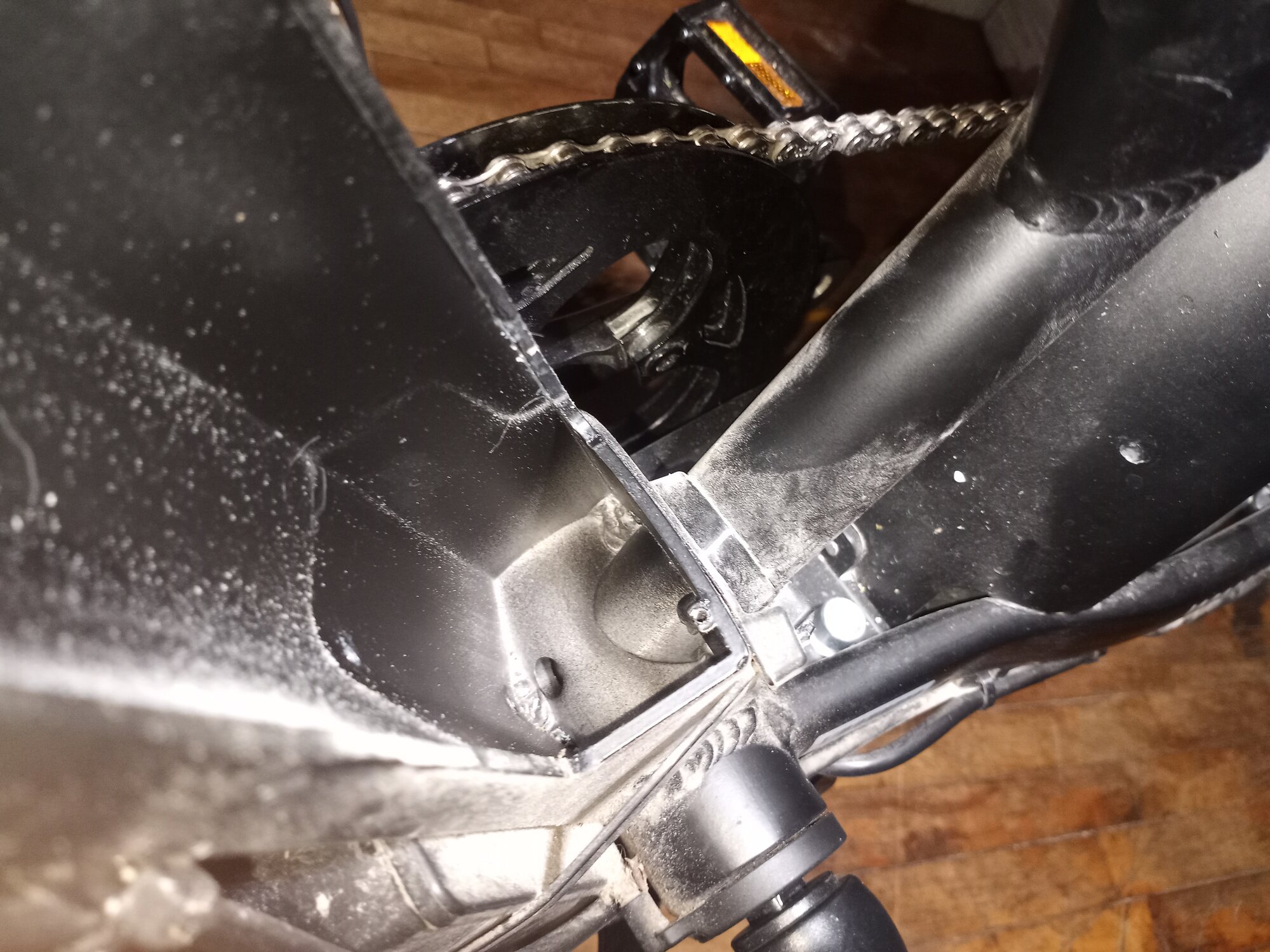

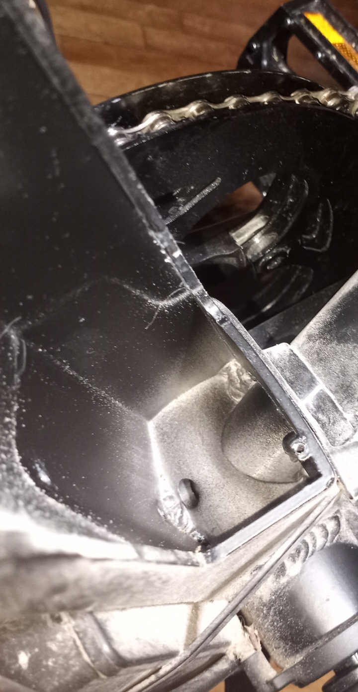

You can see how the dust blew in and got past the battery bracket.
I'm sure water would do the same.
Any water that gets past the battery bracket, drains into the bottom bracket where it would sit until it was 2" deep.
2 little screws to hold down a bouncing 10 pound battery.
Stupid.

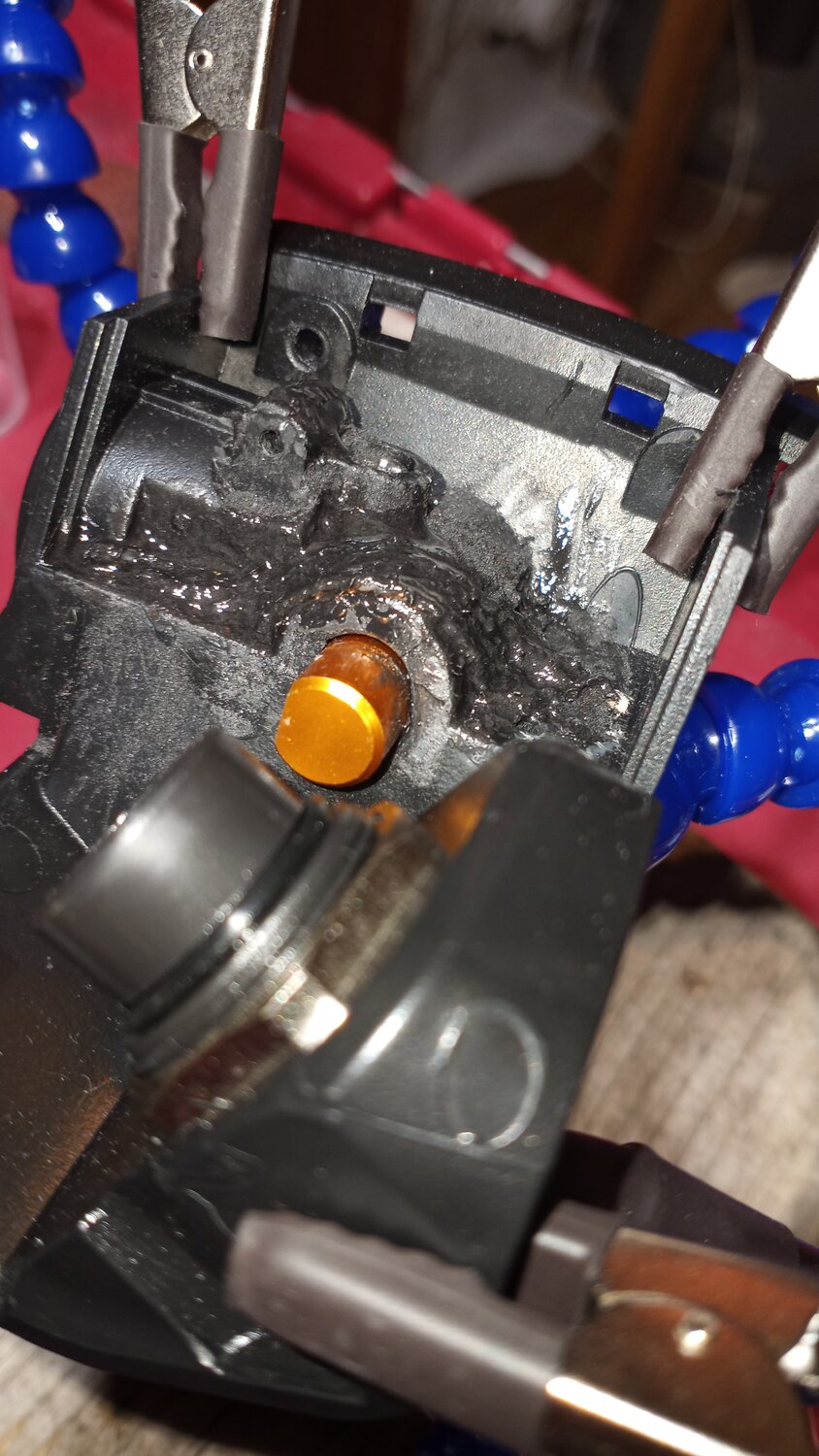

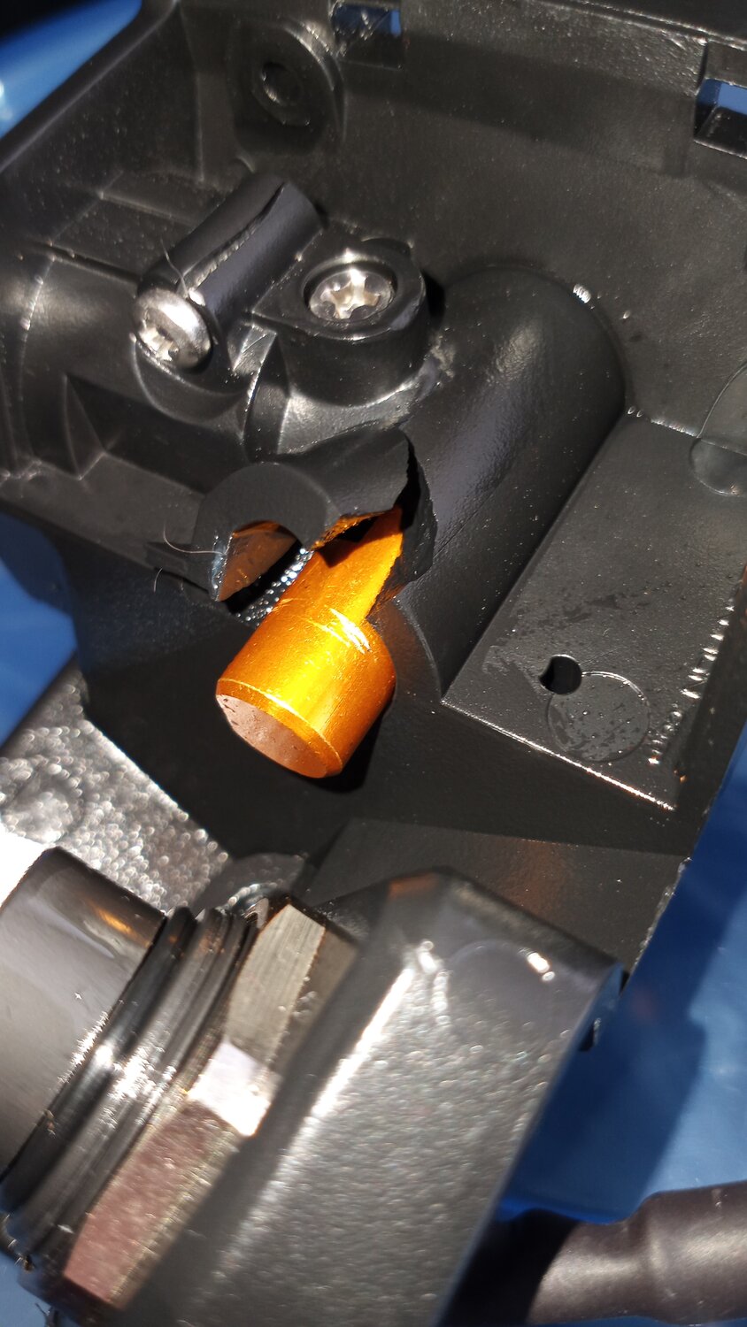

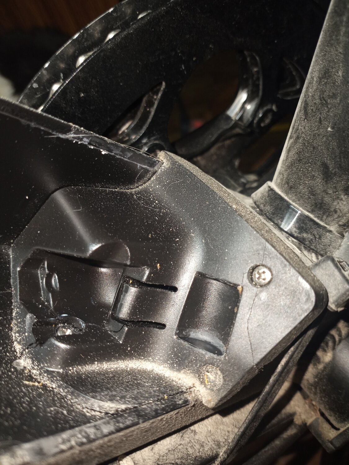

My top bracket was smashed.
I glued it back together with crazy glue mixed with pencil graphite shavings,..
Come On Reention !!!
It's time for a reinvention !!!
I'd pay for a proper cast aluminum or cnc pair of heavy duty battery brackets with big metric bolts to secure them.
And rubber cushioning too.
Your design works fine for 2 pound batteries.
Todays batteries are much heavier.

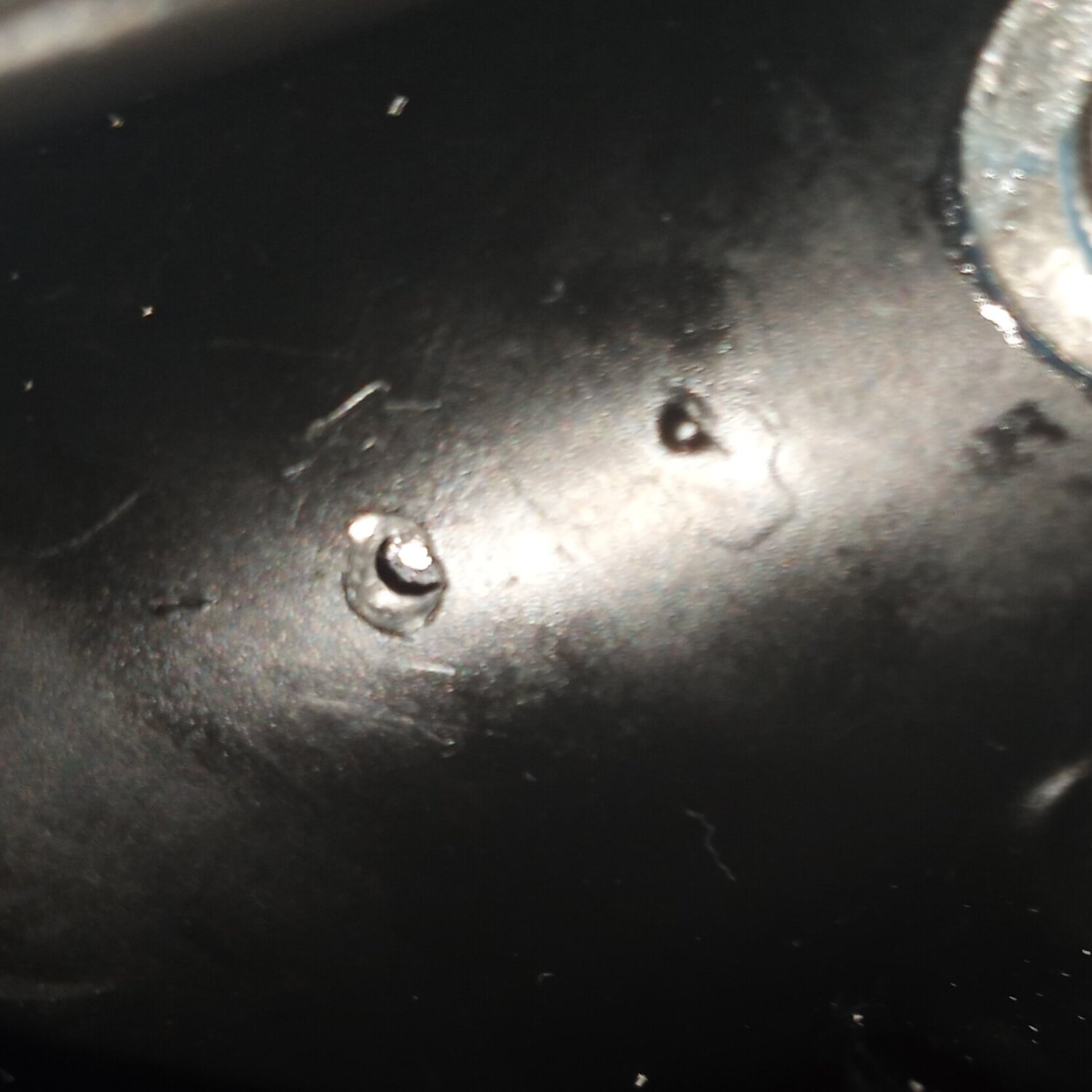

The bikes I had back in the 70's and 80's had water drain holes drilled in the bottom bracket or the chain stays (if the bracket drained into the chain stays.)
My bike has no weep holes ,. !!?
I fixed it.
I drilled a hole in my bottom bracket,..
I tested it by spraying lube into the drain hole in the bottom bracket, and it ran out the weep hole.
I wasn't about to test it with water.
It doesn't matter if the bottom bracket has sealed bearings.
A sealed bearing submerged in water will pull the water into the bearing.
Water can only drain out through the bearing along the axle.

If the bottom bracket doesn't have the hole in the bottom, drill one. Out in the middle away from the bearings. Even condensate will pool and cause rust, of either balls & races or sealed bearings. Been there, done that. Had a bike that the crank started squeaking. When removed the balls were embedded in piles of rust. Since my yuba has loose balls, I put a squirt of oil in the hole every time I turn the bike upside down to change a tube or tire.
Yup.
That's what I did.
I was just "winging it" and figured the hole should be in the middle.

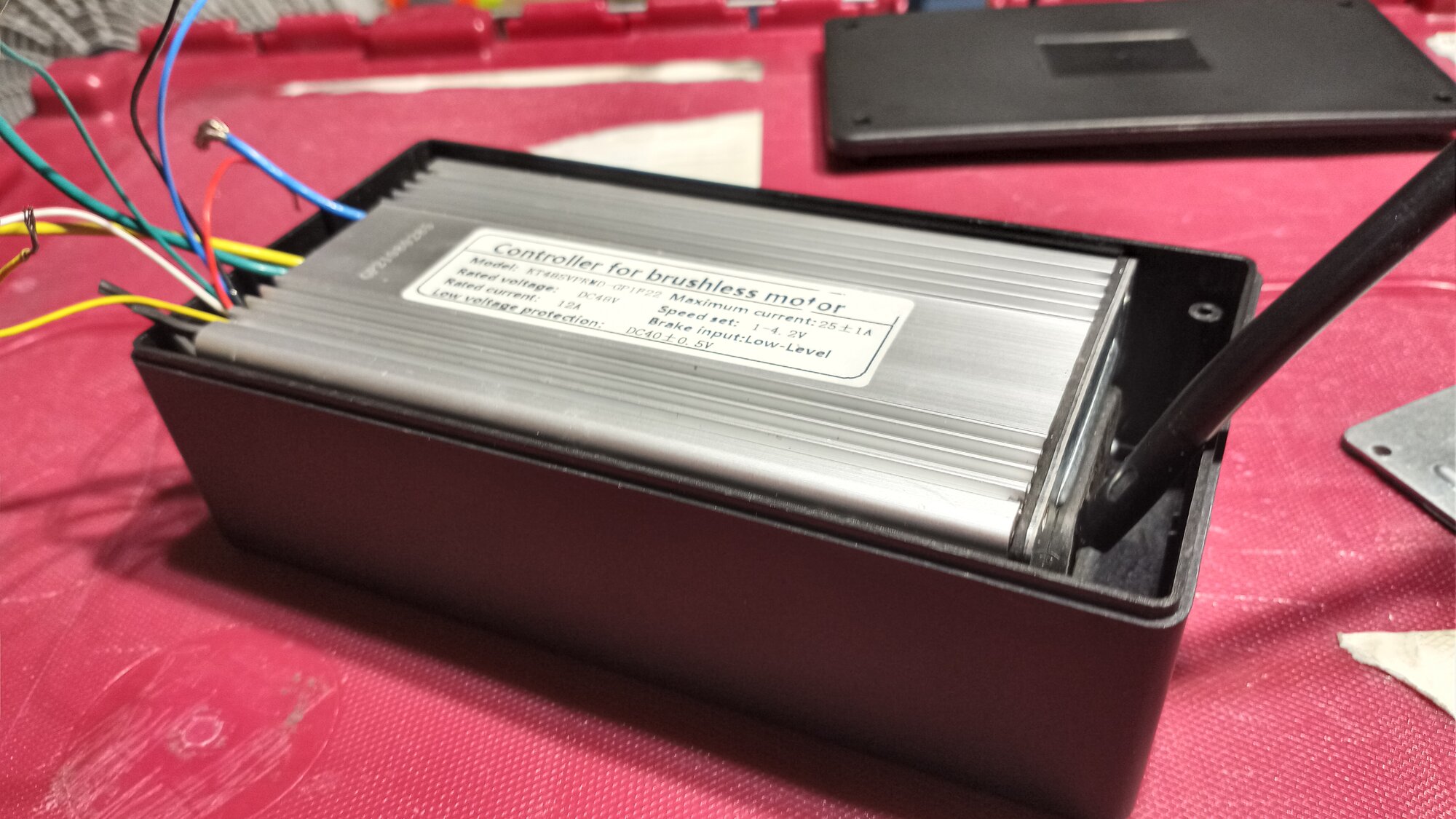

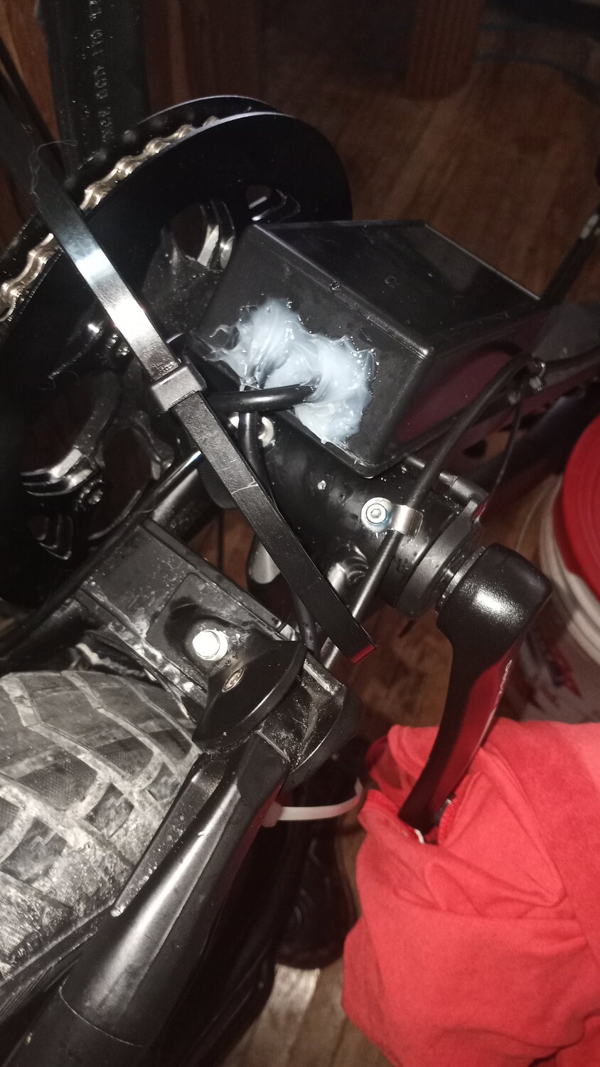

My battery and its brackets are not waterproof.
Water would get into the bottom bracket bearings easily.

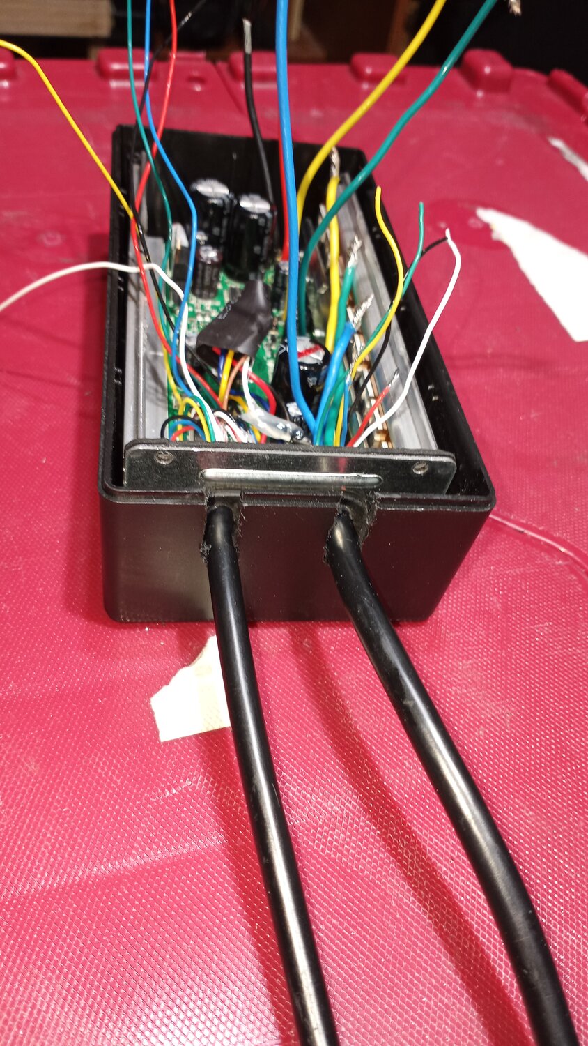

I drilled a hole in my controller box for the same reason.
(A hot needle to melt the hole actually.)

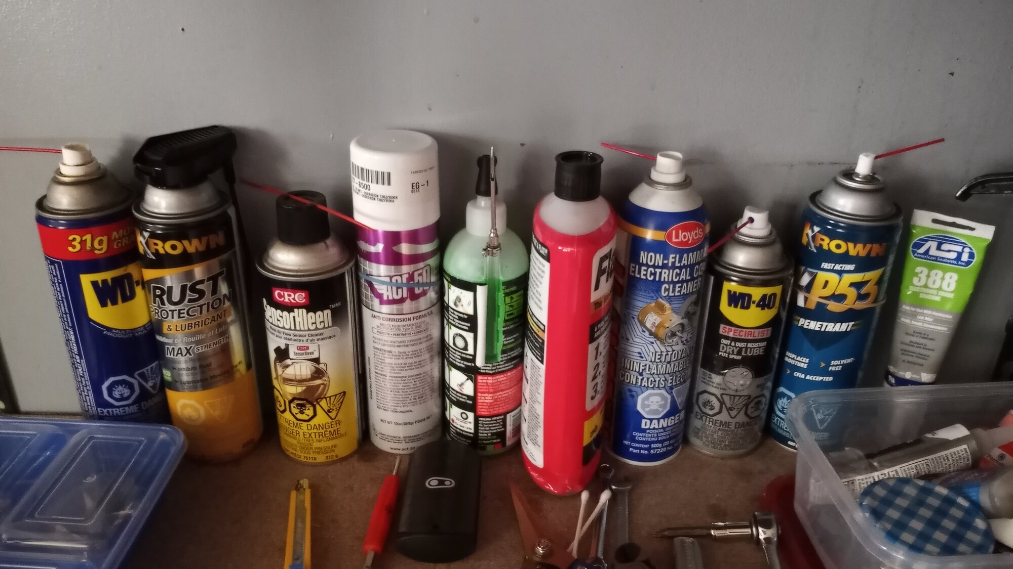

And I sprayed down the entire circuit board with Krown Rust Protection inside the box.
The Krown Rust Protection is more viscous than the ACF-50 and the Krown KP53, so I used it.
It has more staying power.
