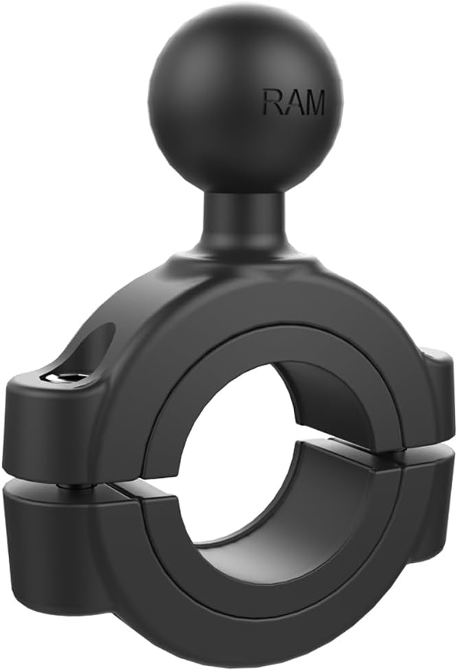

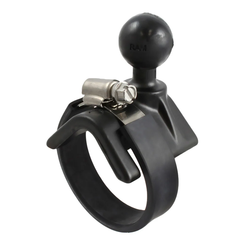

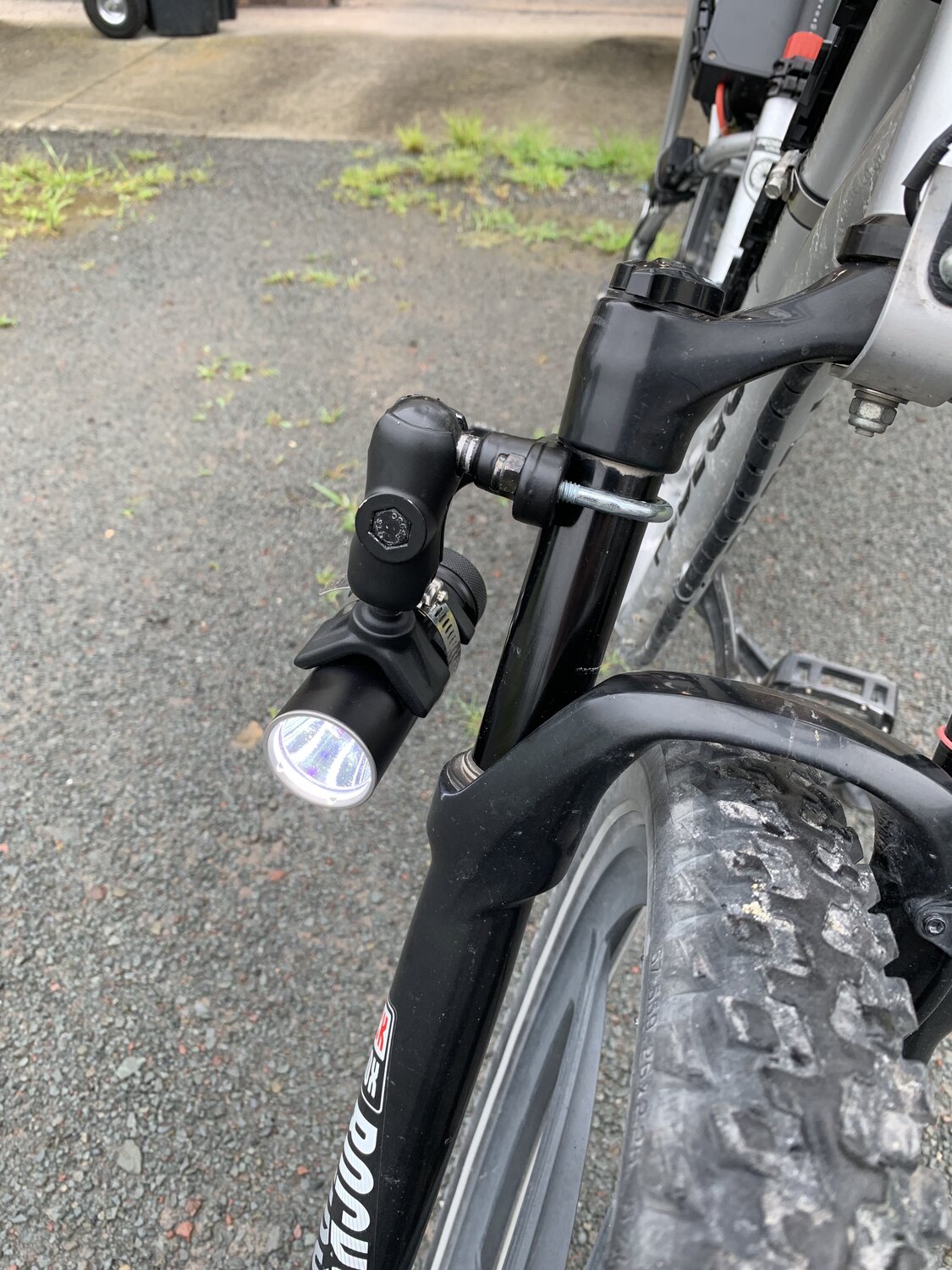

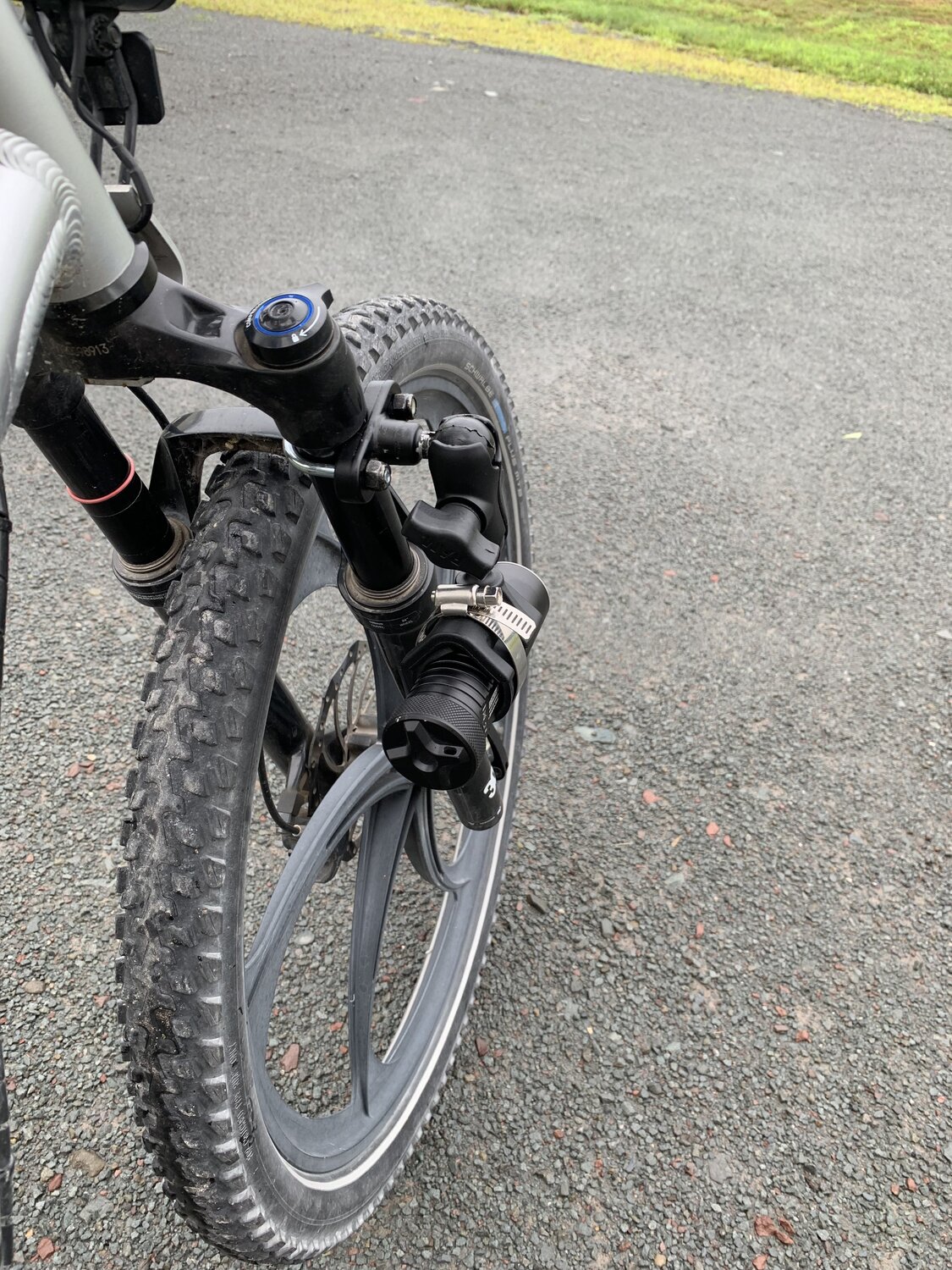

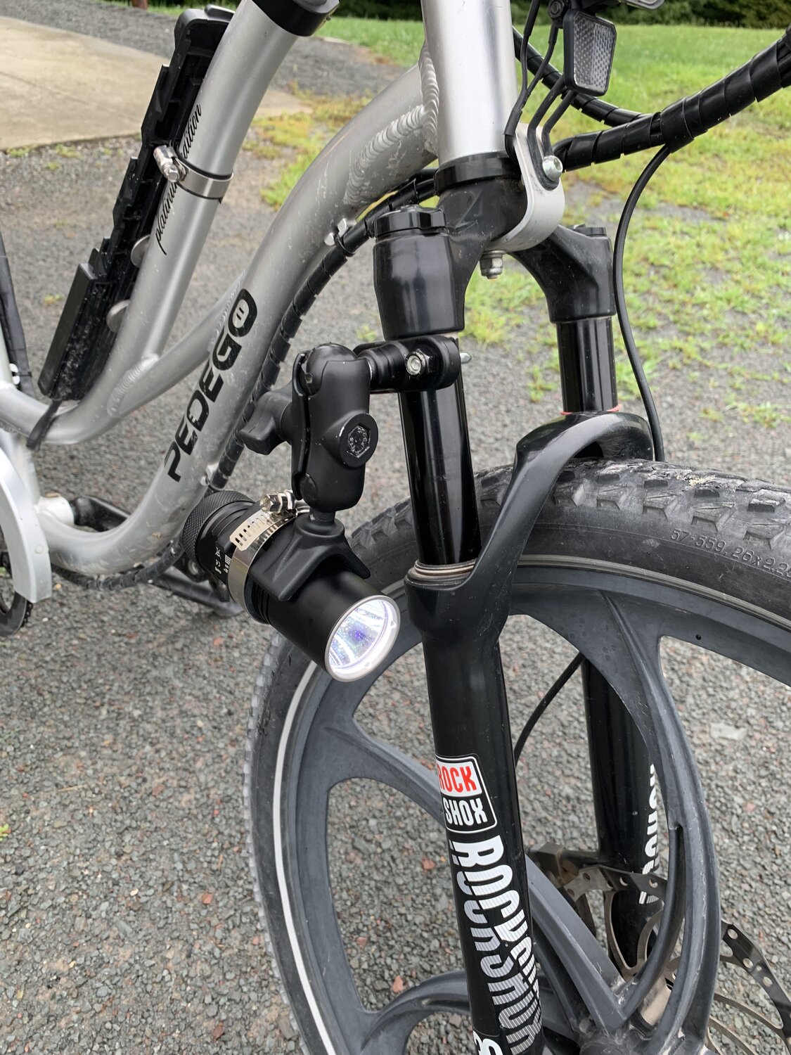

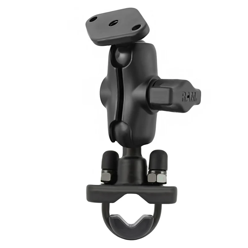

I do a lot of tunnel riding and my handlebar mounted lights don't show up small hazardous debris, like broken glass, tacks, nails, etc. My bikes don't have braze-on screw attachment points on the forks, so I use these RAM mount parts to attach lights, a GoPro camera, and even a mirror:
This "V" bracket will hold almost any flashlight:
I also use this clamp to mount the light lower on the fork but it's not on the bike right now. It will fit a fork tube up to 1.5" in diameter:
you can find variants of the light mounts I described that attach to QR skewers as well.

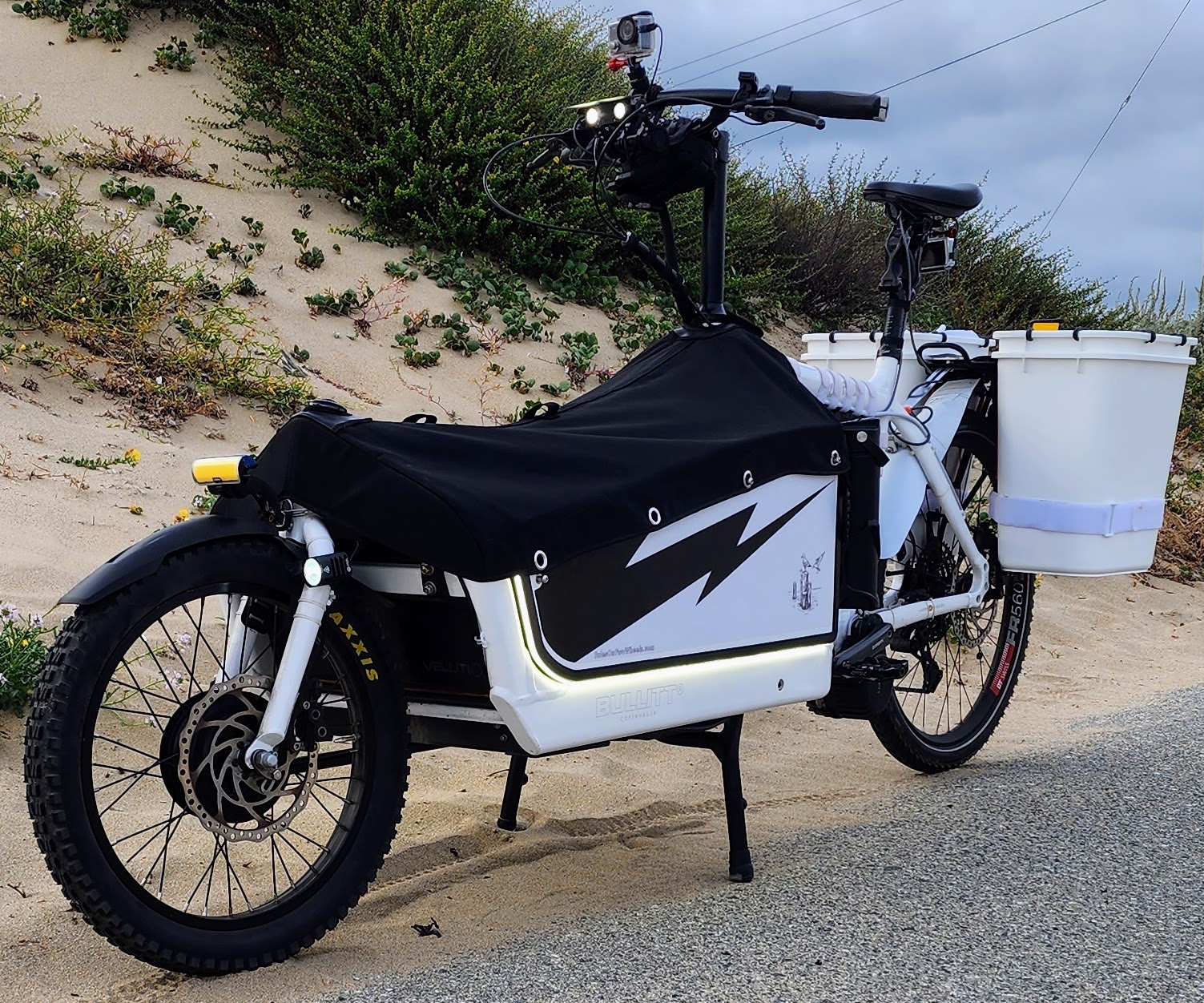

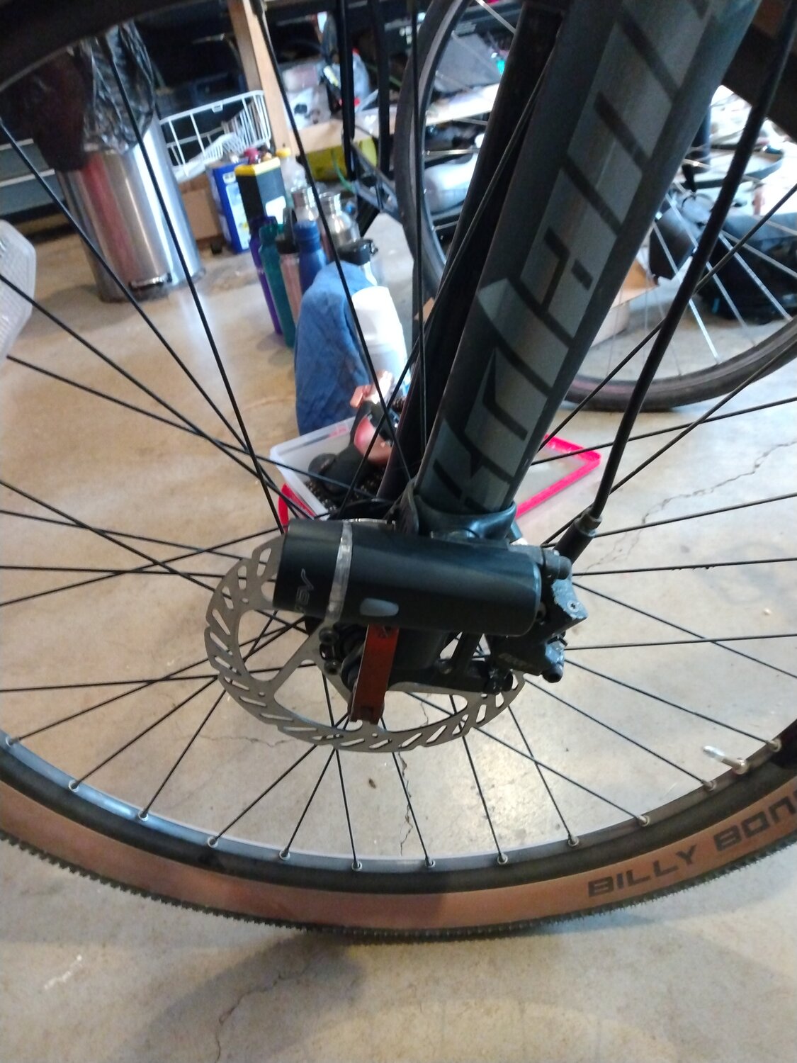

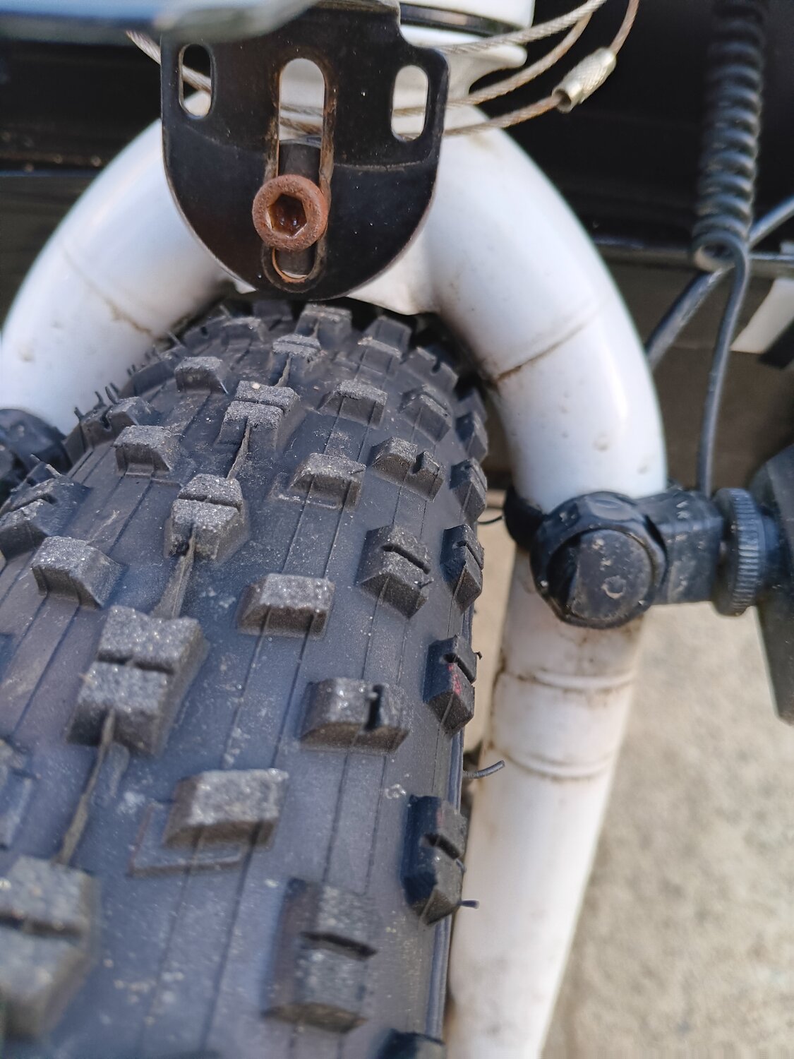

You can do fork-mounted lights with almost no added extra mounting hardware. You just have to find the ones with the right mounting mechanism. The fork lights I use have big batteries that last a long time, and don't cost a lot. I generally use them at their lowest power level, too.
I took these pics for a different reason, so the light mounts aren't quite the focus of the image but you'll get the idea well enough.
Almost zero loss of clearance inside the fork vs. the tire. I put one on each side. These lights project a narrow beam, so I use them specifically to go low and far forward. My top handlebar light provides a wider beam and projects closer to the bike, so I get a pear-shaped illuminated area with the base of the pear closest to me. I gave up long ago trying to get a desirable beam pattern out of a single light and instead have found my ideal is achieved with multiples.

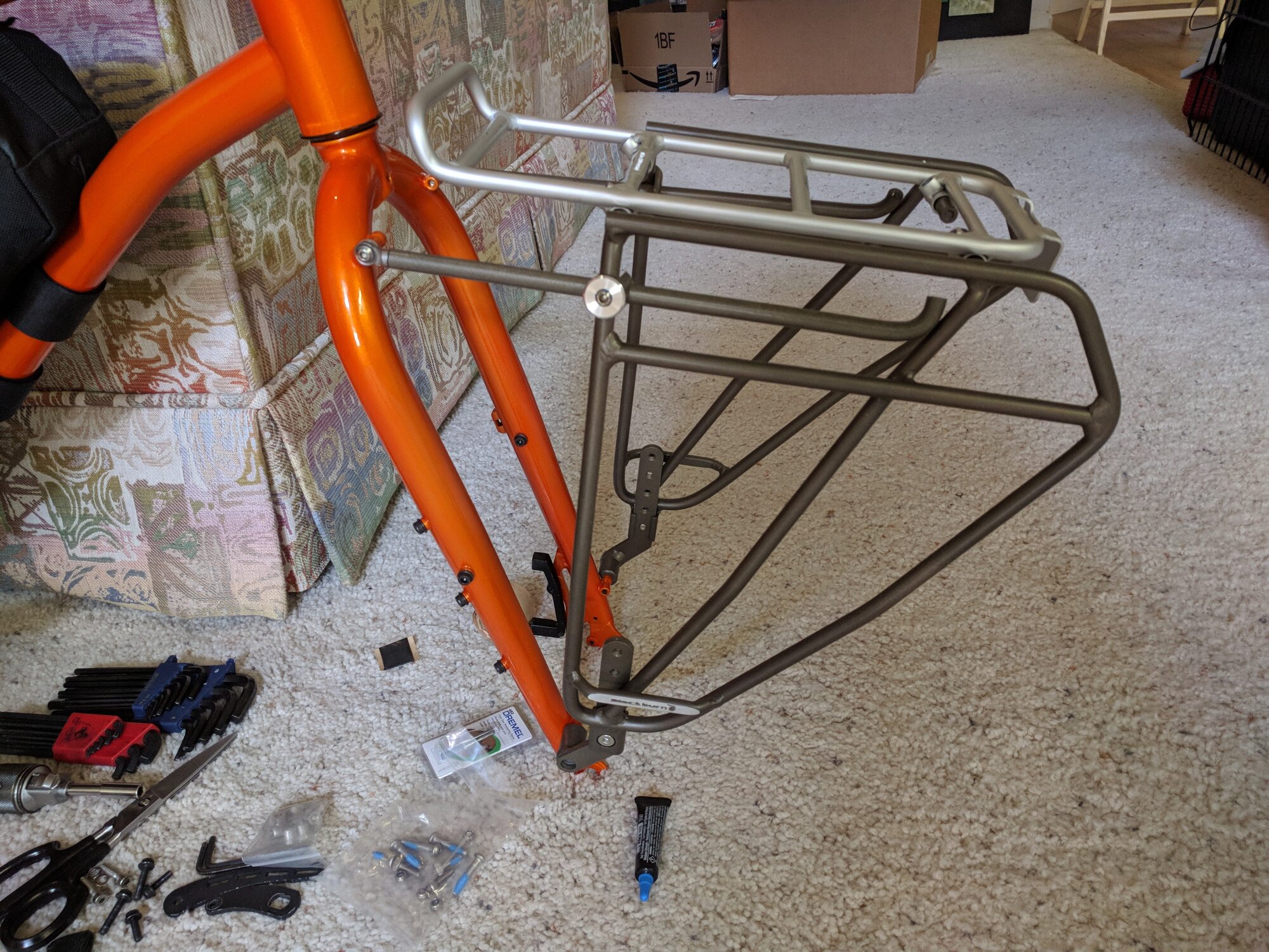

The PDW Light Nug seems like a good $15-each solution so long as you have M5 bosses on your fork blades. I am on the wait list to get a custom truss fork made for my white Bullitt, and one of the items I am specifying for the build are M5 bosses near the top of the forward set of fork blades, so I can do a couple of these Nugs screwed on for the fork lights. Or a Niterider Lumina Micro might be a good choice. I have a couple of those but they need something like a Nug to mount them on a fork.
Maybe I am biased in how I use bicycles but I don't see a lot of justification for not having M5 bosses on a fork. The cost is somewhere between zero and tiny and the added weight is also negligible. And there are so many damned useful things you can do with them if you have them on the bike.
Completely agree. Zero downside. I put a few Surly Ice Cream Truck forks to good use on a few fat bike builds. The barnacles they have encrusting them make for super clean, top-quality front rack mounts.
