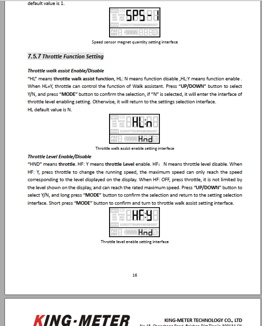

Actually they should have the function that enable the full speed for throttle. as what I know, we have that function for the throttle, as attached below.

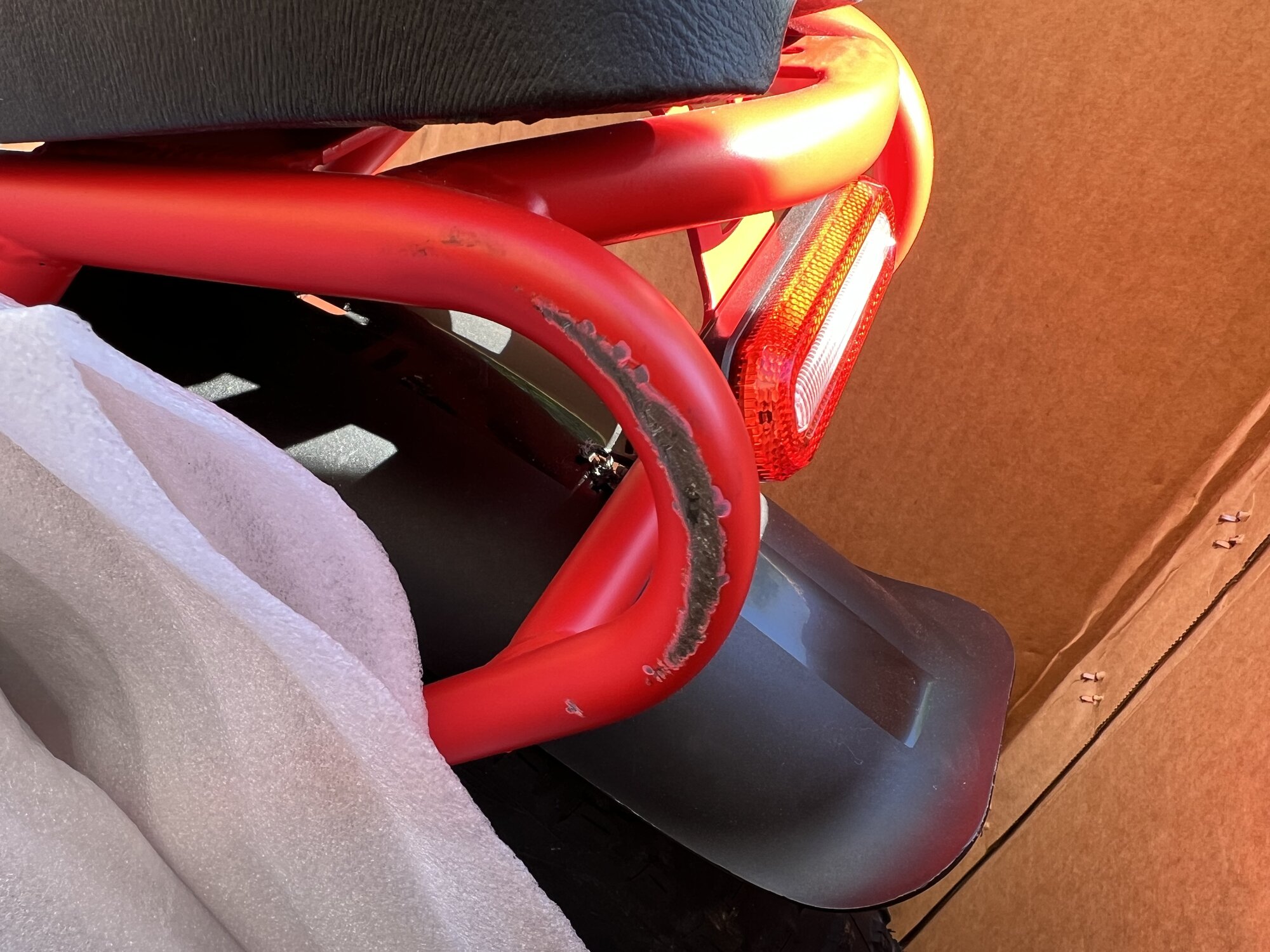

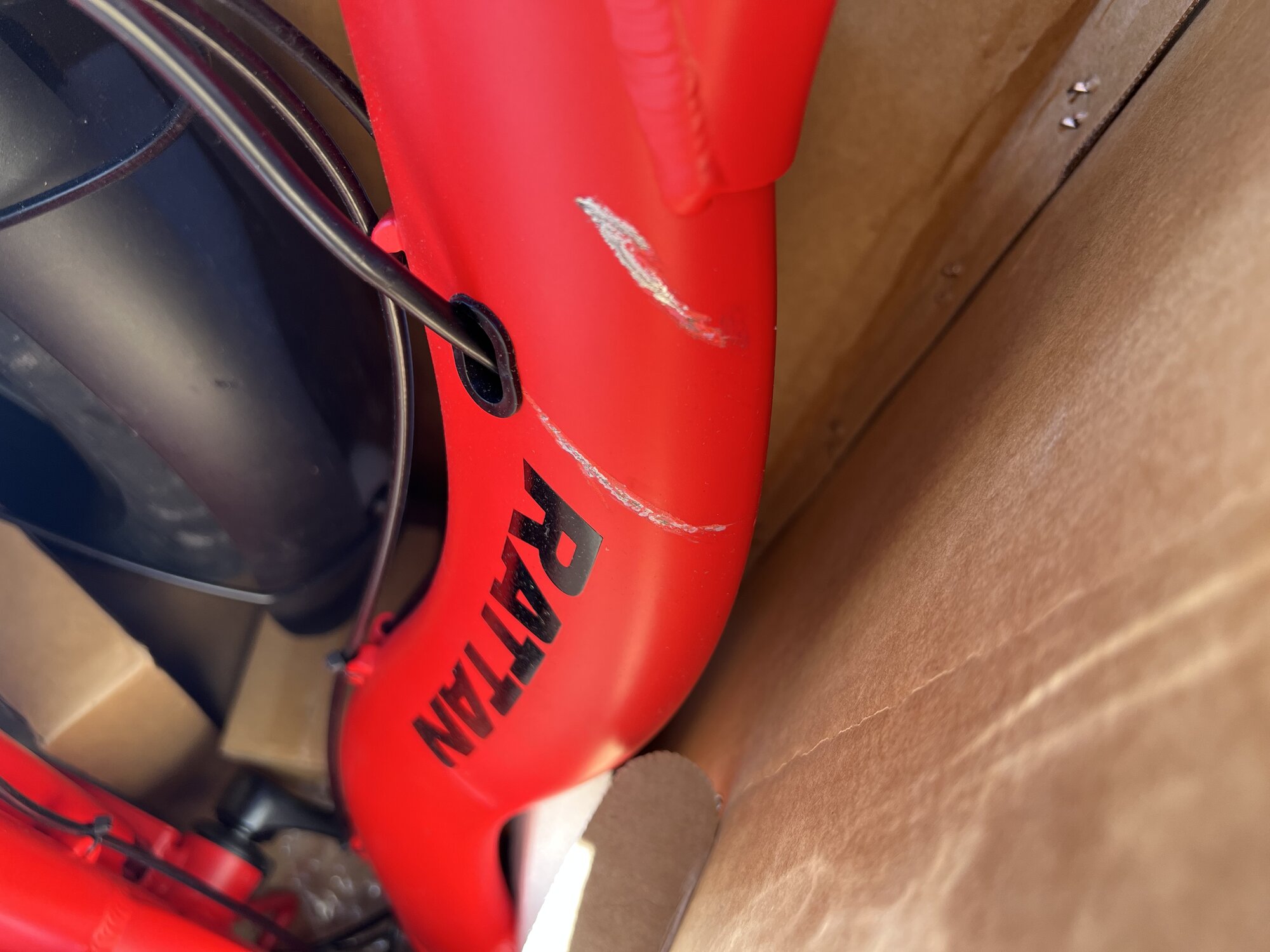

You're right that the 750 is a "turd". My display came blinking with no default settings inputted at all and I can get no help from Rattan. I bought mine in August and it's been sitting since my 3rd ride. I emailed Rattan immediately, which was 3 days after delivery, and they didn't respond for almost 2 weeks by which time they told me it was too late for a refund. I have been emailing, calling, texting...daily since August and just get different reps asking for the same pics and videos I've given them dozens of times. I can't even get an answer to what numbers to enter into the display. How am I supposed to know how many magnets the sensor has if they don't even know? Garbage product sold by garbage people
I have the same problem with them this is how the bike came. They are the worst customer service I have ever encountered
