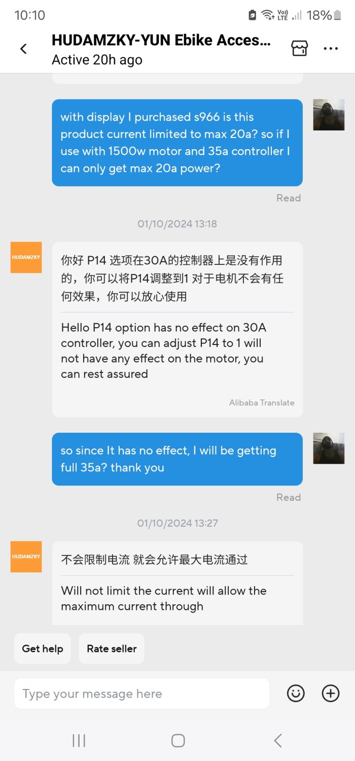

I purchased a 48v/22A controller from JN (DC Moto Controller by Lithium Battery) that came with an S900 display. After 1 month of waiting and hours of getting it into my bike, I see the S900 display limits the current to 20A. I see that JN also sells controllers that go up to 35A and they use the same displays. I looked up every display compatible with JN controllers that they list on their seller page and they all have a current limit of 20A in their manuals.
I do not understand this. Are people actually buying expensive 35A controllers with displays that limit them to 20A? or are there sellers that sell displays with modified parameters that remove the current limits?

Are there any sellers that sell modified versions of displays or displays with higher current limits? Is it possible to bypass the display current limit via modifying firmware or other methods?

The current limit is adjustable, just up to 20A. Doesn't go above that.

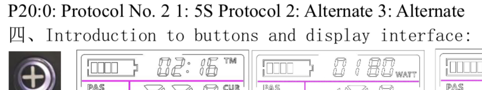

I have a similar kit with a 20 amp display limit. It’s a 23a (Brain Power) controller with an S866 display.
The above reply mentions “No. 2 Communication Protocol”. That is P20 on the S866 display.
I’m not at my display to check, but I wonder if the protocol (P20) is to “Protocol No. 2” then the 20A limit will be bypassed. The “Alternate” settings also interest me. Maybe one of those would bypass the 20A display limit.
