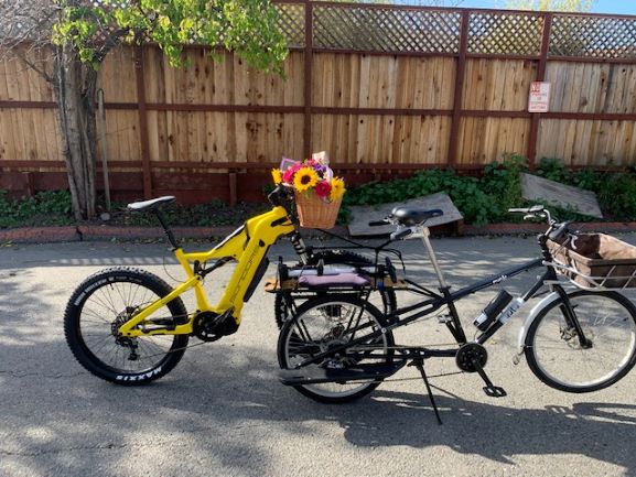

Last year I just went into the display to make it unrestricted. I do not know for '22. You can also put it into metric and tell the display that it has 40% smaller wheels (17").
