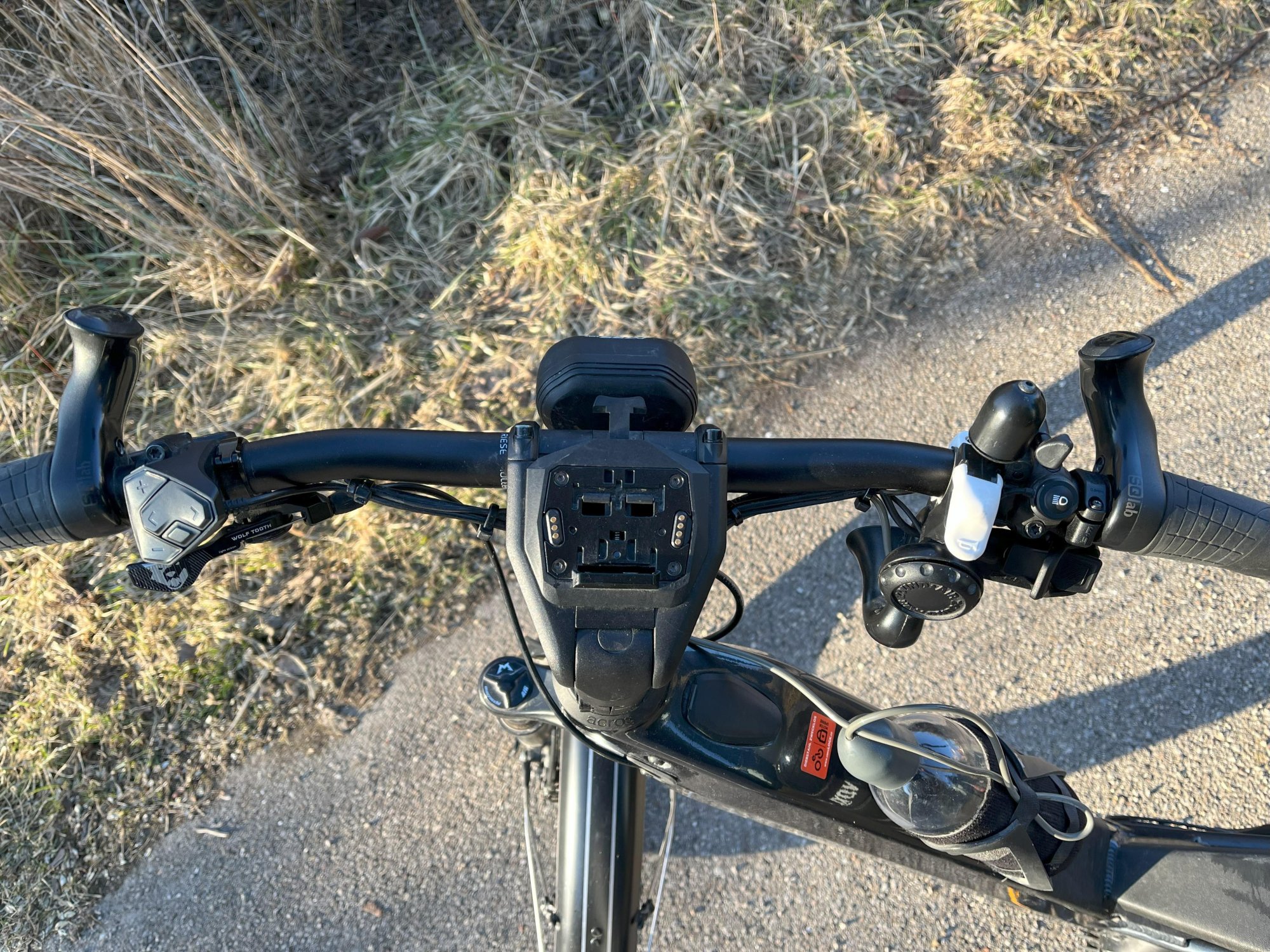

The replacement of the shifter is quite simple or let's say plug and play. But before you do that a firmware update of the shifter unit is necessary if you got the 1.0 Version. (2.0 I don't know.) This update must be done with the Rohloff classic 1.0 App, which is only available for Android devices. Details can be found here.
https://www.rohloff.de/en/service/handbook/e-14/maintenance/android-app
Don't worry, the update procedure works fine.
I have ordered the part, now I need to find someone with an android device. Many t hanks for your help.
Not always!
With my system, the app identifies the Rohloff device but stops while creating a connection. The Bosch unit is a Nyon.
Any suggestions would be appreciated.
I just did the update and installed the trigger shifter. I had to try a couple times to connect the app to my Rohloff. On my second attempt I switched off the SIM on my phone so the phone would only connect to my wifi. I linked a good Rohloff instruction...
