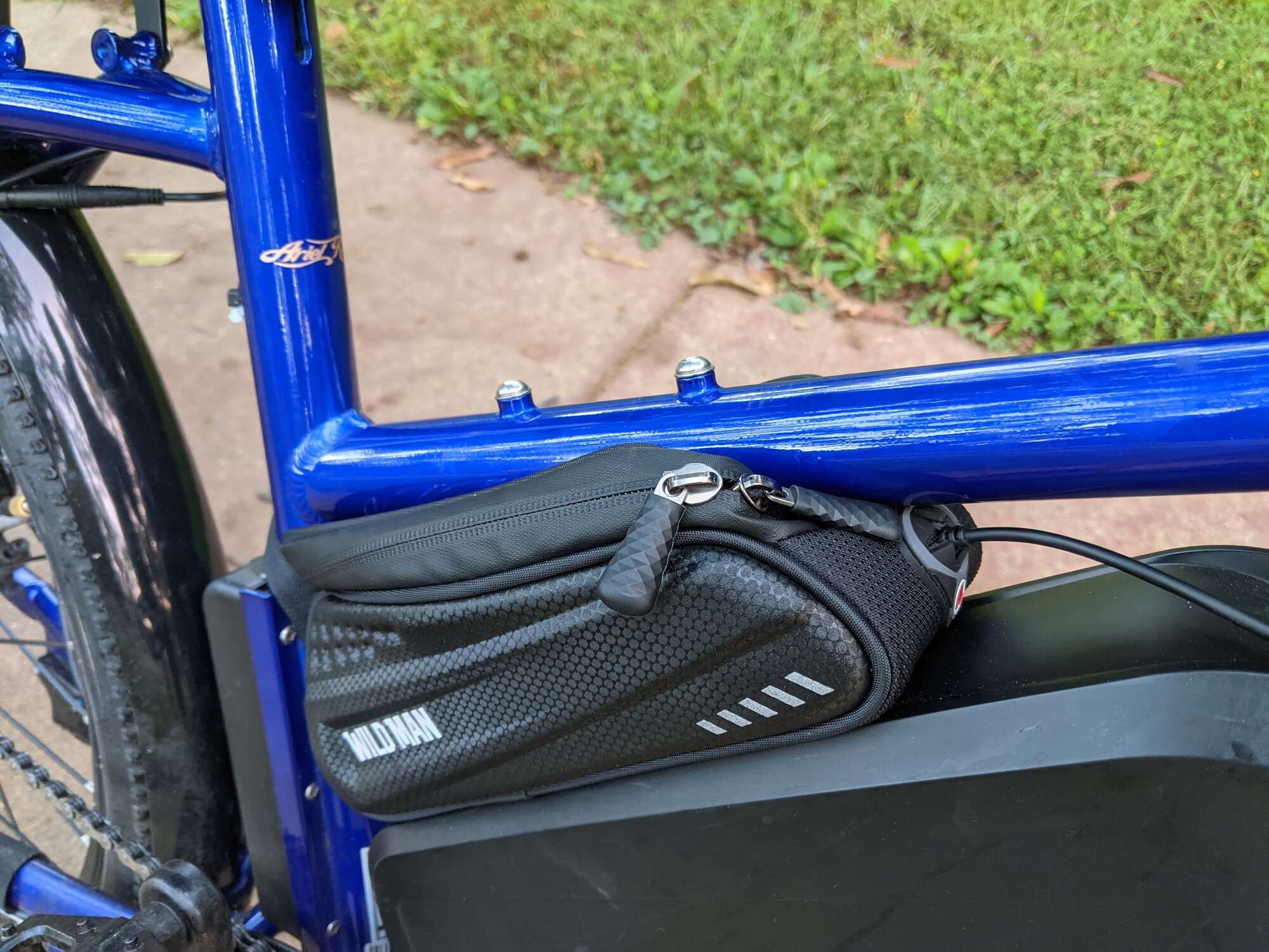

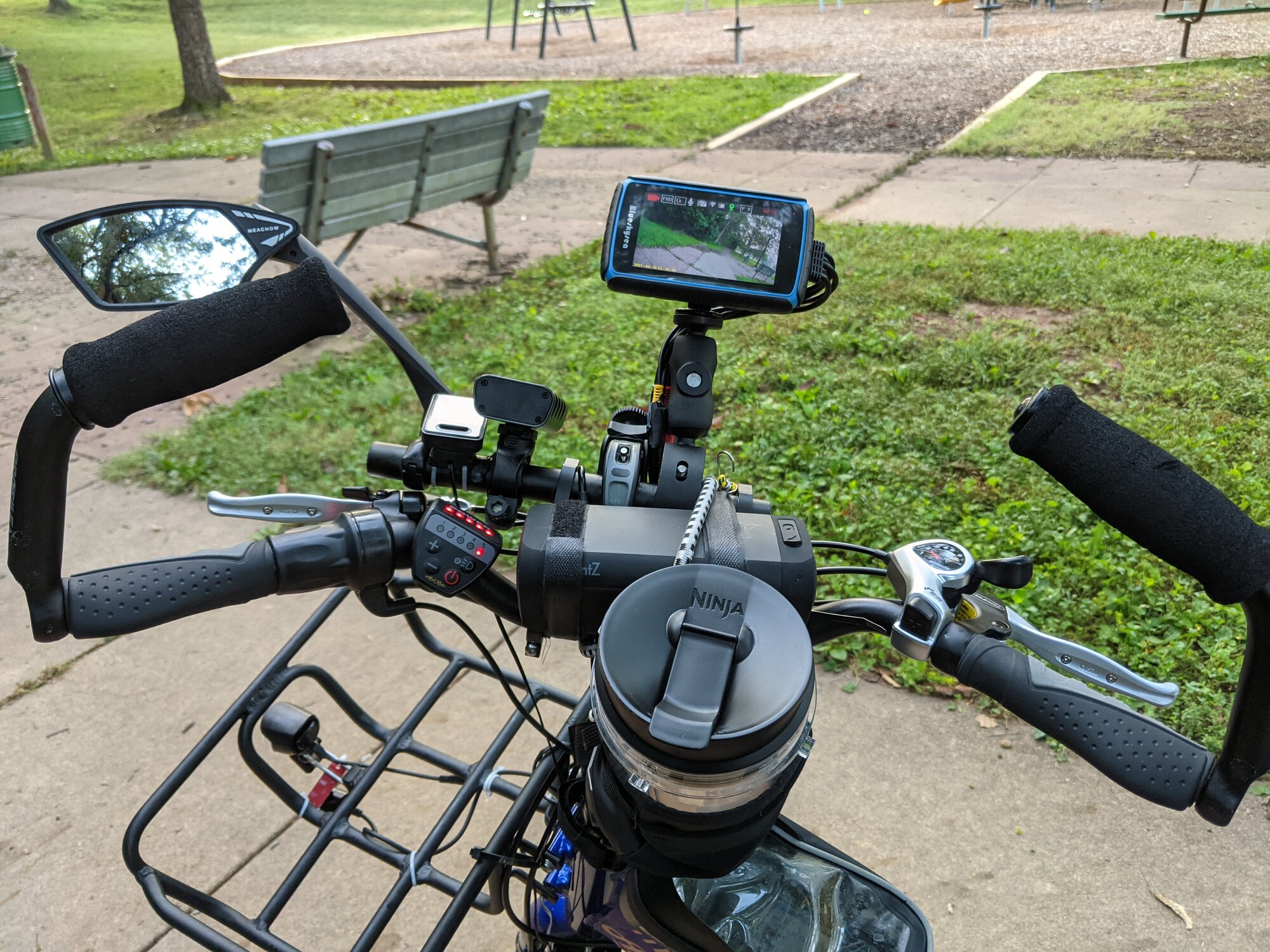

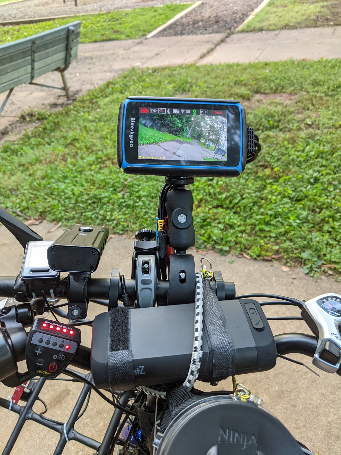

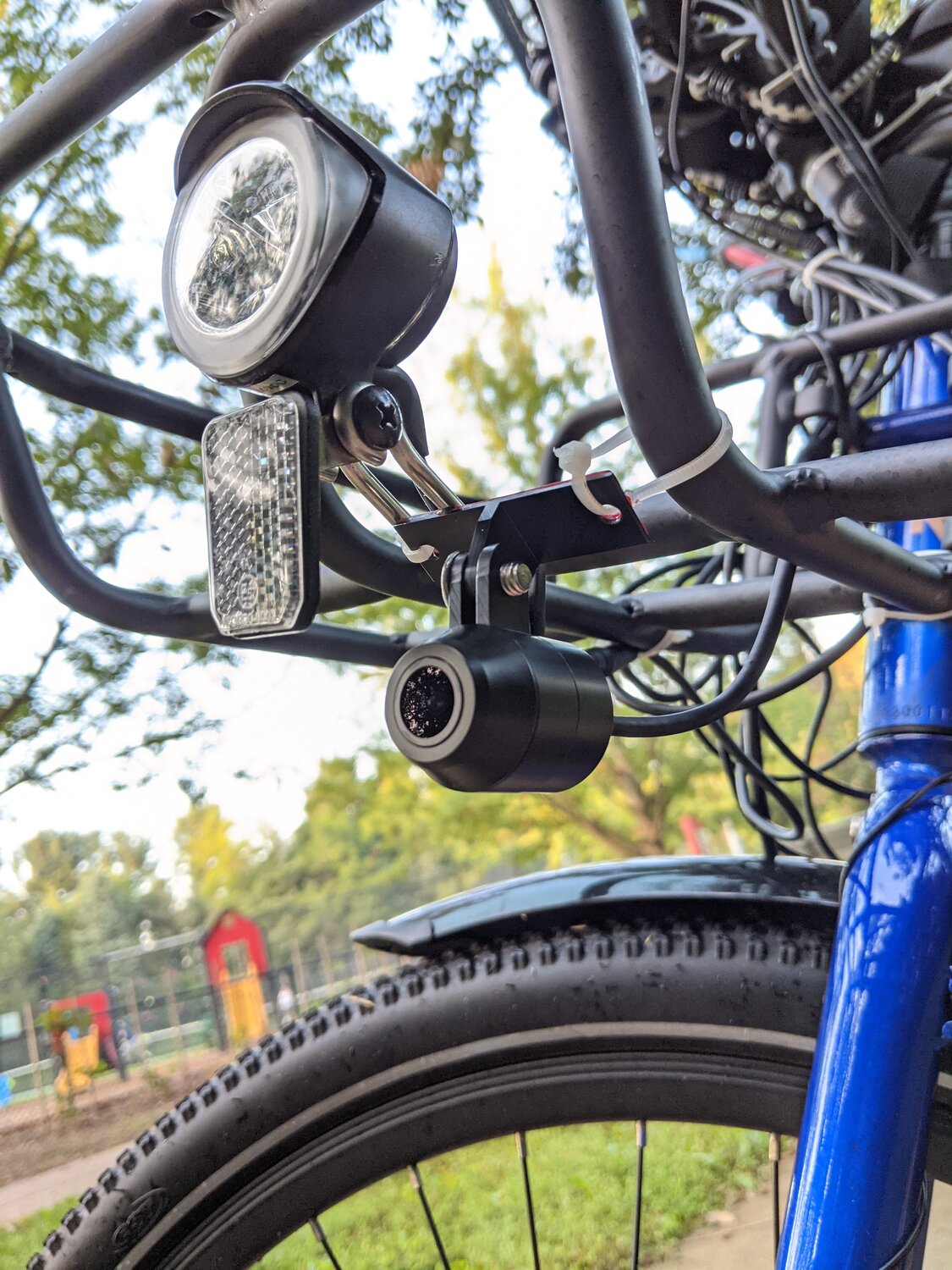

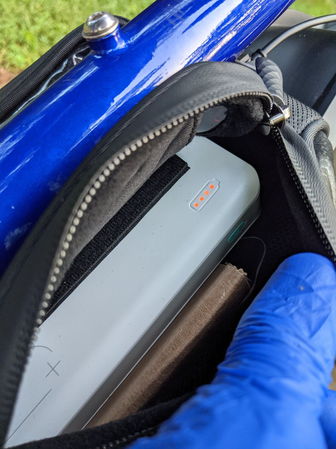

So after using it for a week, I LOVE it, and i really like the setup that im using. I use a 30,000 mAh battery that is in a bag above the bike's battery, it is protected from the elements there. the bag has a design to allow cable to come out (for headphones) so that is where the usb for the power to the device goes into the bag. I spent a week trying different connecting methods. This is the one i am most likely going to go with. The mount that holds the screen clamps onto my extended bike bar, and the mount has ball adjustments at the bottom and top so i can really get the screen to where i want it.
During the day it is pretty hard to see the screen at times and i just use the mirror. At night though i really like it over the mirror. There are times when i am not in my normal riding position (like when climbing hills, i go from upright position to a more normal "biker" position and my head goes towards the handlebars and using the mirror is not possible, so having the screen to see is really nice. I know that at night i can pretty safely see my back when looking at the monitor. It also is pretty bright at night in dim situations.
But the best feature is just having it auto record. With the 30,000 mAh battery i was able to make it the whole week while riding about 20 miles a day, everyday. When using the battery pack, i was not able to turn the system on using the power button. I had to open the bag where the battery is and hit the power button to turn it on, and the system auto turns on and records. Slightly inconvenient , where i would prefer to be able to hit the power button on the device and that would wake up the battery but i get why it doesn't work like that. I would seriously consider hooking this up to my bike's battery or controller if it did not void the warranty which i think it would. Only other downside was that there is no way to turn the screen off that i can find. It has a "screen Saver" mode but that just shows you your speed based on the GPS and its a bright gray screen. Sometimes i would want the screen off or hidden, and that is why i think the mount that i picked is best. I can quickly adjust it so the screen is facing down towards the bluetooth speaker that is below it, i could do that when im going into a store for a little while or its annoying me. Also i think sunshade might be helpful.

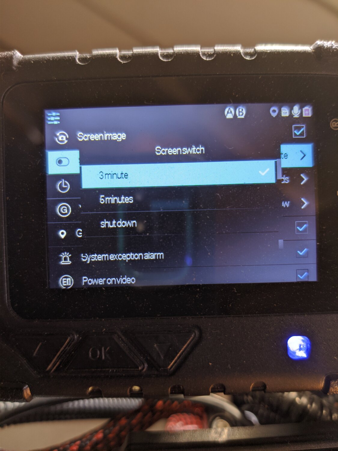

Have a look at the settings menu I'm pretty sure that there is a setting got the display to make it go to sleep if you're not using it.
To wake up the power bank you need to install a switch on the cable that plugs into it to make it think that you have just plugged in the cable, at least that's my take on it.
On my set up the bag containing the battery is mounted in front on top of the frame so before I get going I just plug in the power cable and that wakes up my power bank and the camera turns on and starts recording and after 30 seconds(when I set it up like that) the display goes to sleep but the camera continues to record.
We're looking forward to seeing your video or at least some clips of it.
Thanks, i will try to get some video later today or this week. A switch would be a great addition. I am also thinking about getting my main light, which is 1000w battery powered, to be hooked up to the battery as well. The other thing i was thinking about doing is just having the battery offset to the left or right of the frame, in the same bag, but with the button sticking straight up towards the sky and visible through the bag's phone cover. That way i could just hit the power button through the plastic cover and not have to unzip the bag. But i think the battery is too think to do that, but i will try it out. I like the usb kept plugged into the battery and having to unzip to power on the device is not that bad, but i do wish it were just a little easier.

On mine short pressing the power button turns the screen off, pressing it again wakes up the screen, there is a setting to make that happen automatically after 3 or 5 minutes.
Here's a picture of said setting.

Yeah mine calls it "Screen saver" and i have the option for 1 minute, 3 minutes or off and it just shows the speed and doesn't turn off. Also when i short press the power it goes to the mph and not screen off. I think with the newer version they changed it most likely.

Just an update, i've been using the DV988 for awhile now and i love it. Very wide angle and really helps see when cars are about to pass. I have hooked up a turn signal on the mount that holds the monitor and that allows the turn signal to be pretty high and lets me see if its actually working or not instantly.

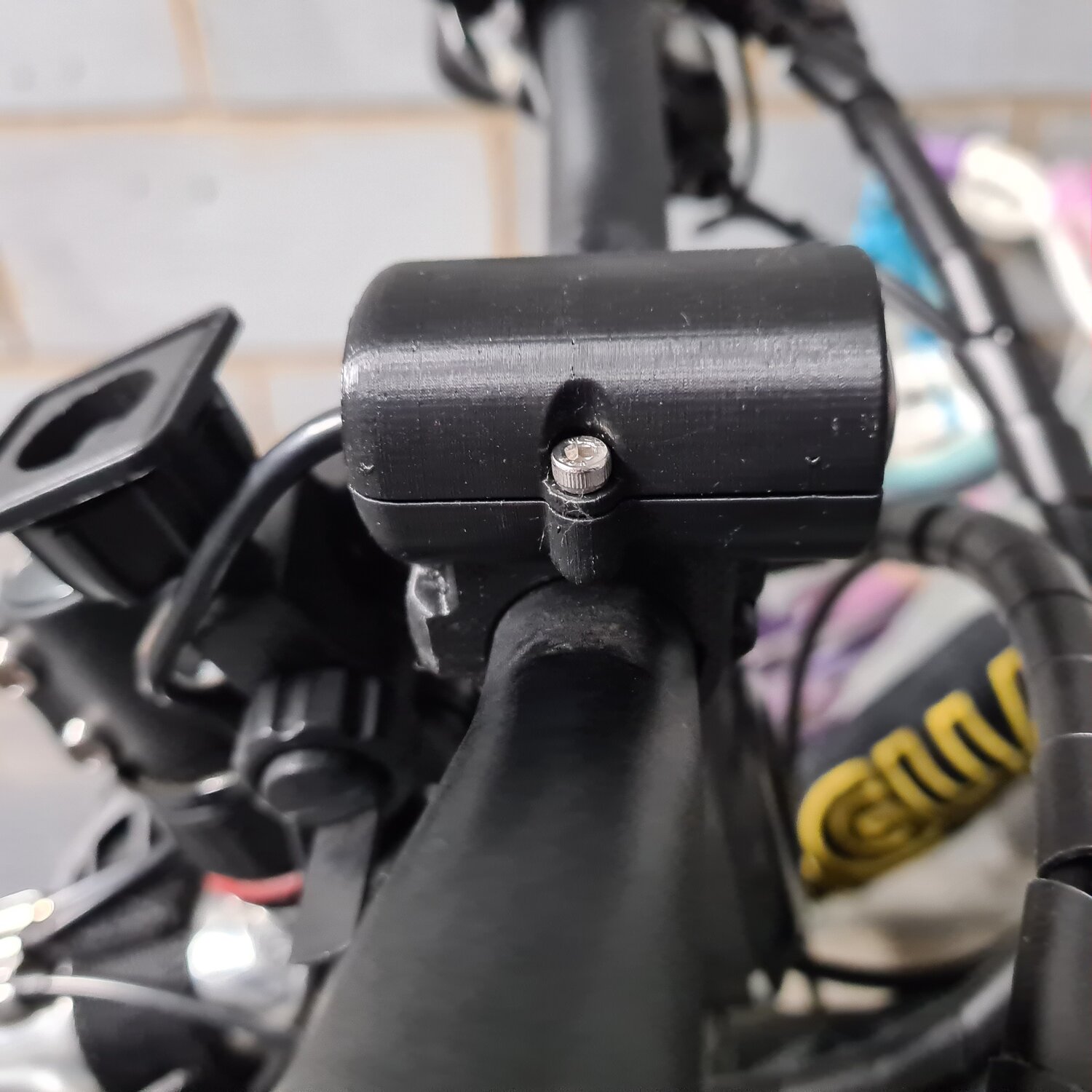

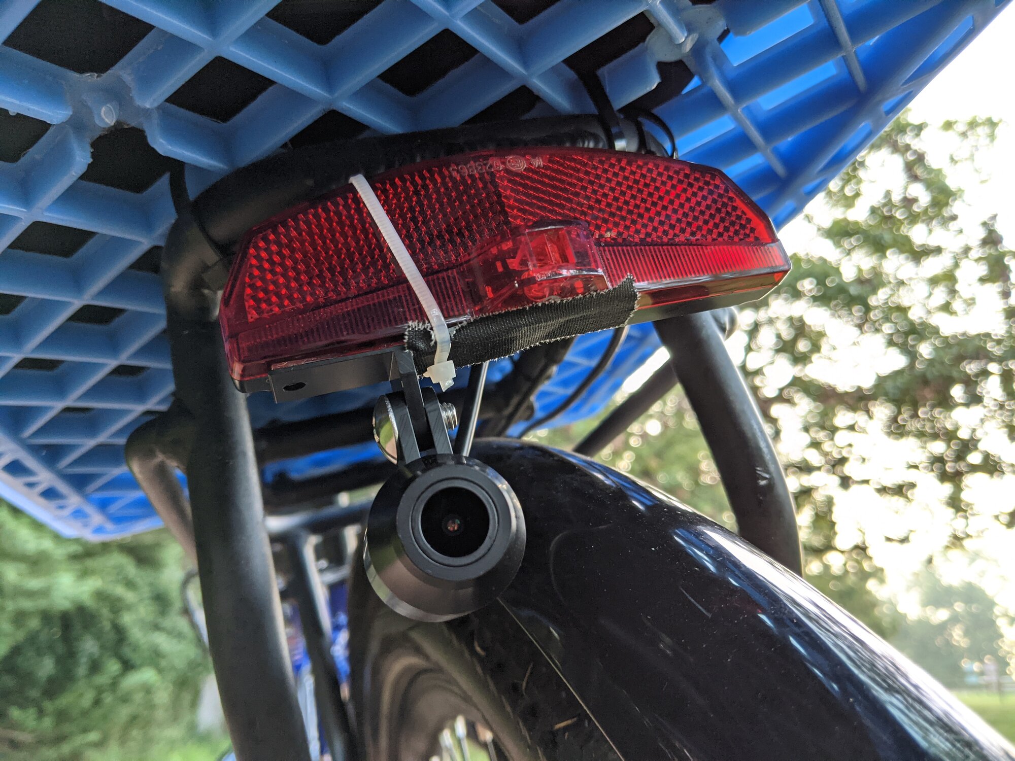

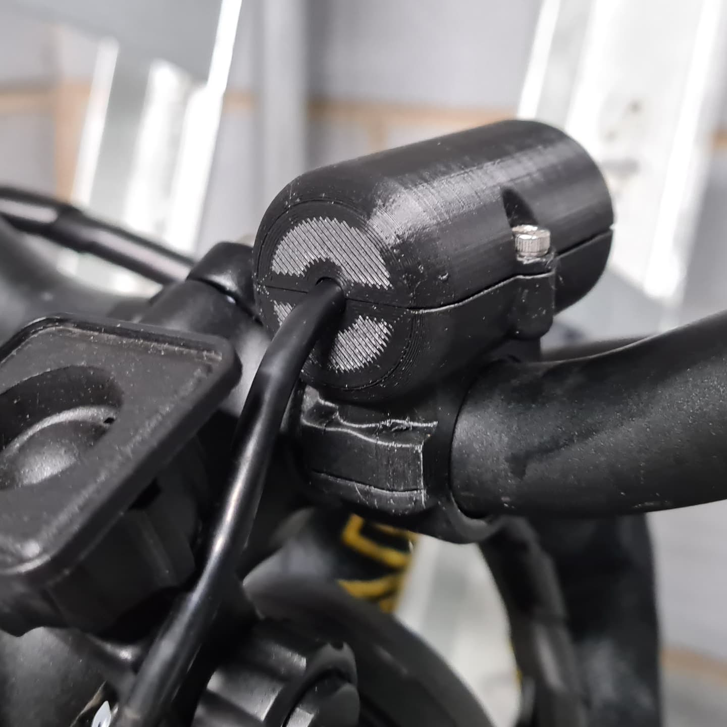

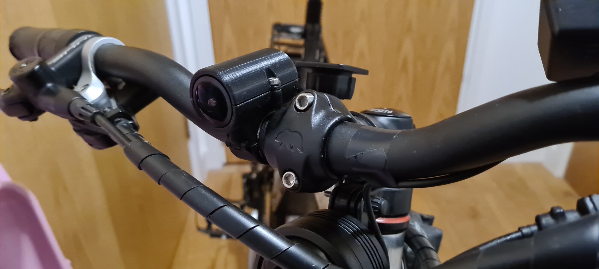

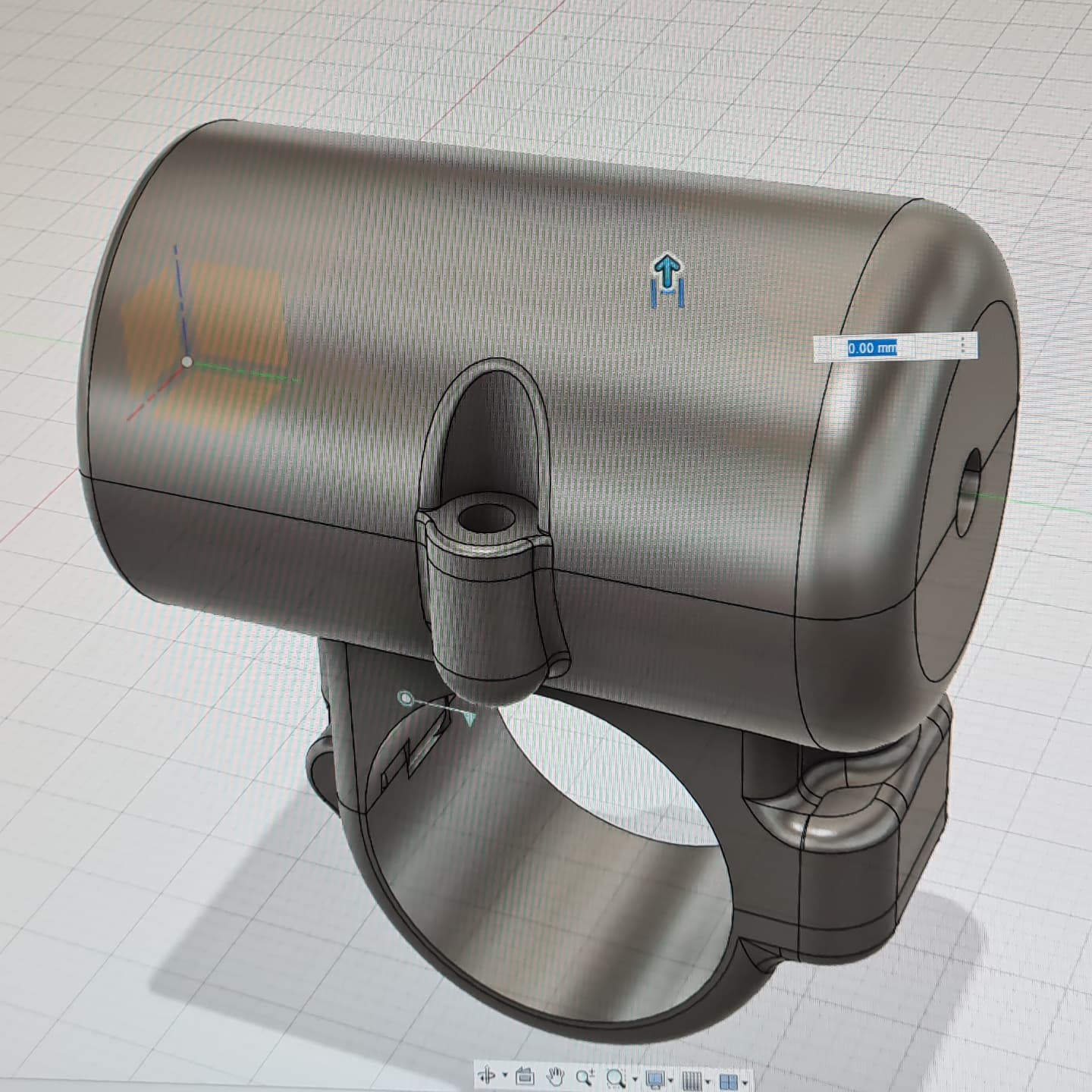

Just a quick update on my moto dash cam set up. I've been trying to clean up the front of my bike and the previous front camera mount was starting to look tired. It was a bit rudimentary anyway and had started to crack and the screws were rusty. I 3D printed a new one with an improved designed and simpler aesthetics. I'll be redoing the rear camera soon as my new saddle (Royal Selle) has tighter spacing meaning my previous setup of mounting to the rails won't work anymore.
