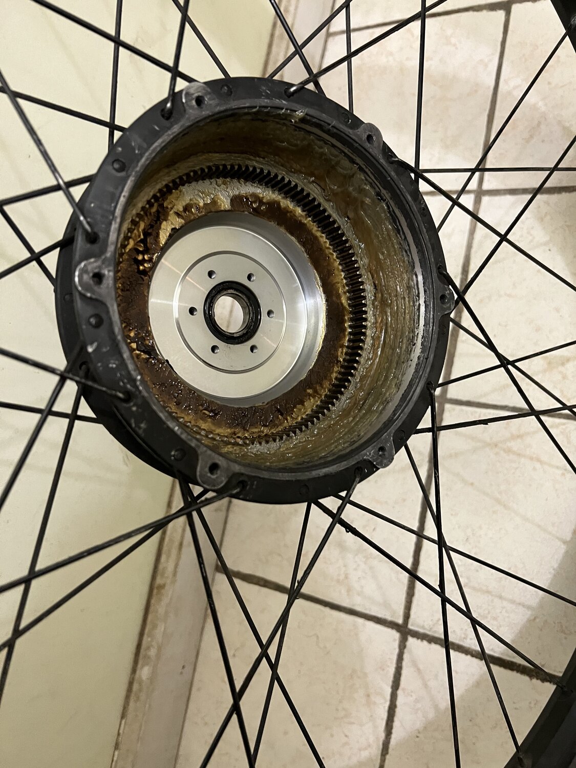

The wire going into one of my pedego latch dapu 20 inch wheel motors got pinched, it works with throttle but pas is intermittent and we need to replace the wire
Had no luck trying to find a dapu motor opening tool, unfortunately pedego never does this, they just swap out wheels or motors...

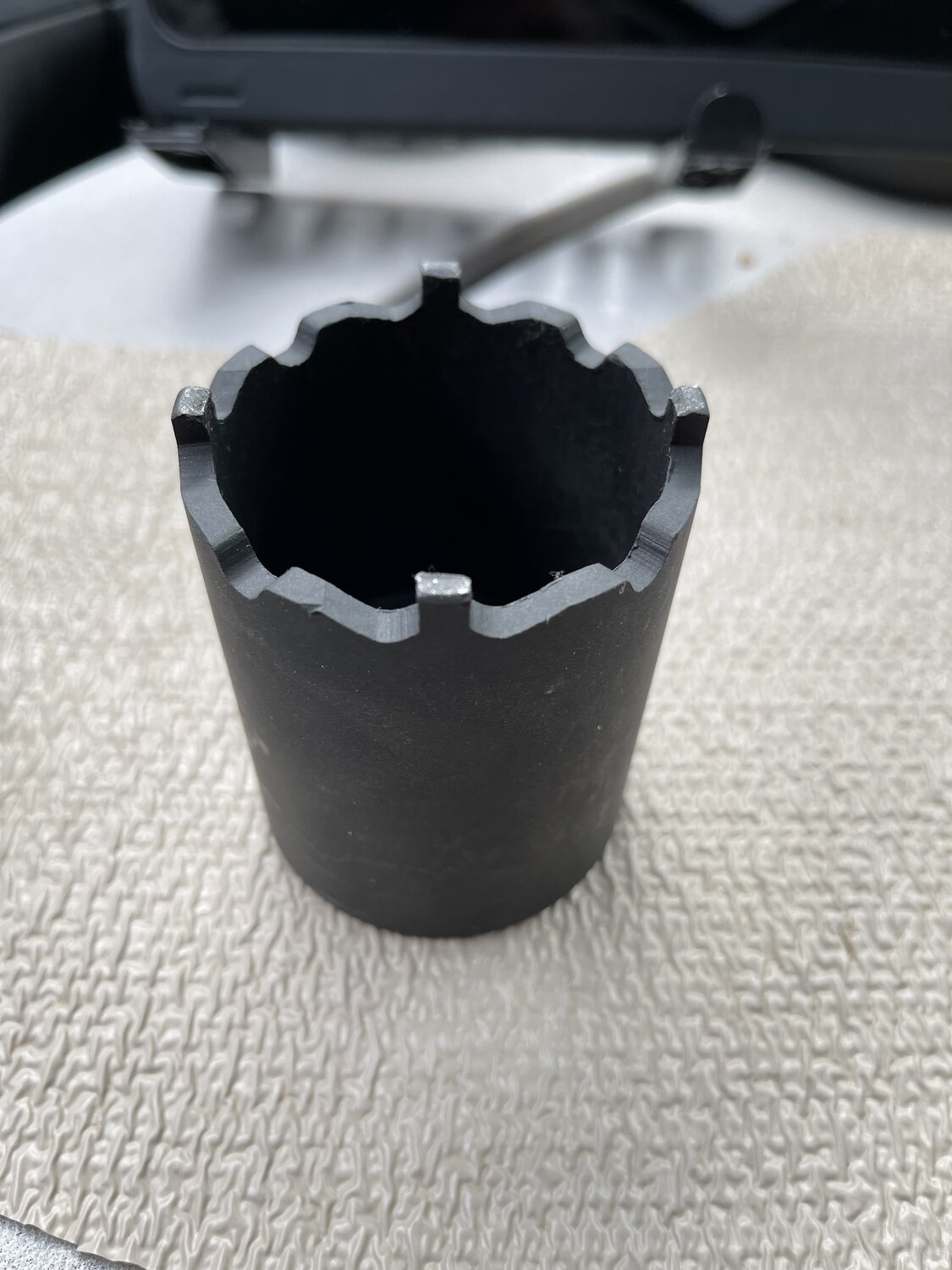

showed it to a friend who said it looks like a 4 wheel drive nut wrench would work
just picked one up for 25 at the auto parts shop that looks like it fits perfectly, there are a few different sizes
will have more feedback on this after i drop it off with the guy that helps me with repairs like this
going to try and post a couple of pictures of this tool

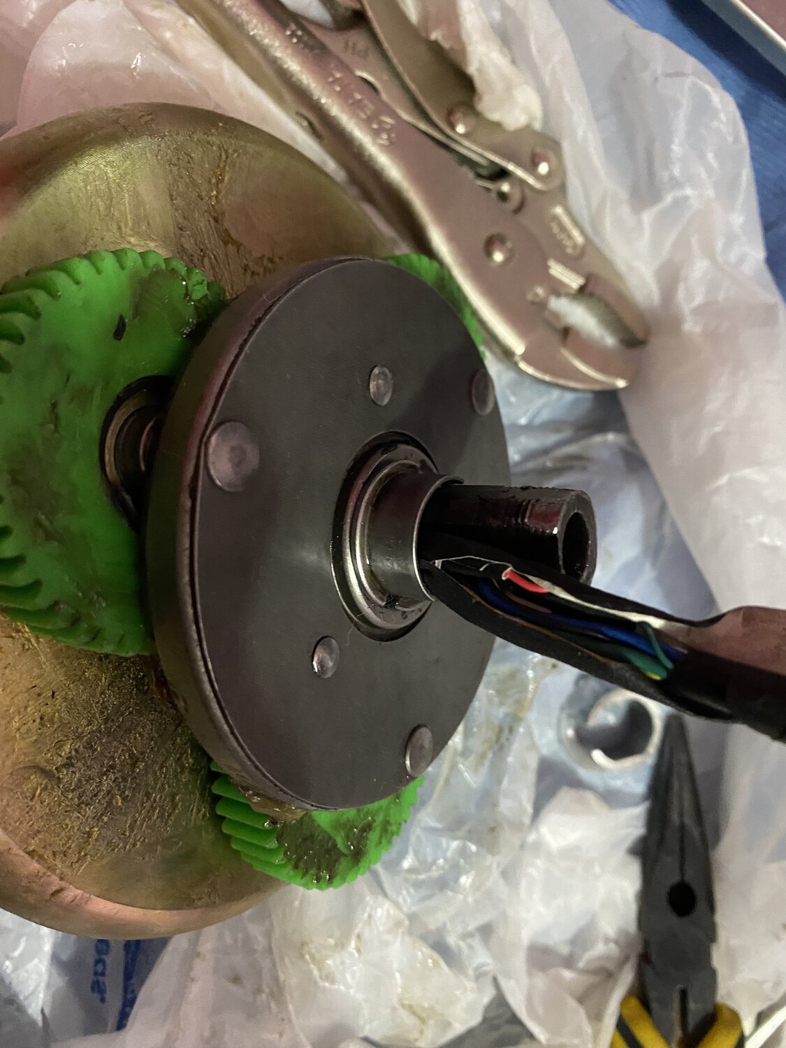

i just opened my BH Easy motion 500watts Dapu motor 2 days ago, 1 26awg broken wire after 17.000miles..
I used the angled clamp on one side+cone wrench on other side in order to open it.

Wanted to update that this tool worked perfectly for that motor, my bike mechanic cut a notch in it so the wire could go through that and not get damaged but these may be a good option for these motors that have to be opened this way

to update this, the tool is perfect for opening the motor
he had to replace the broken wire but he also had to replace the motor hall sensor? was fried probably from being shorted on the frame originally when someone put the wheel back on wrong and caught the wire
it now fixed and running great
