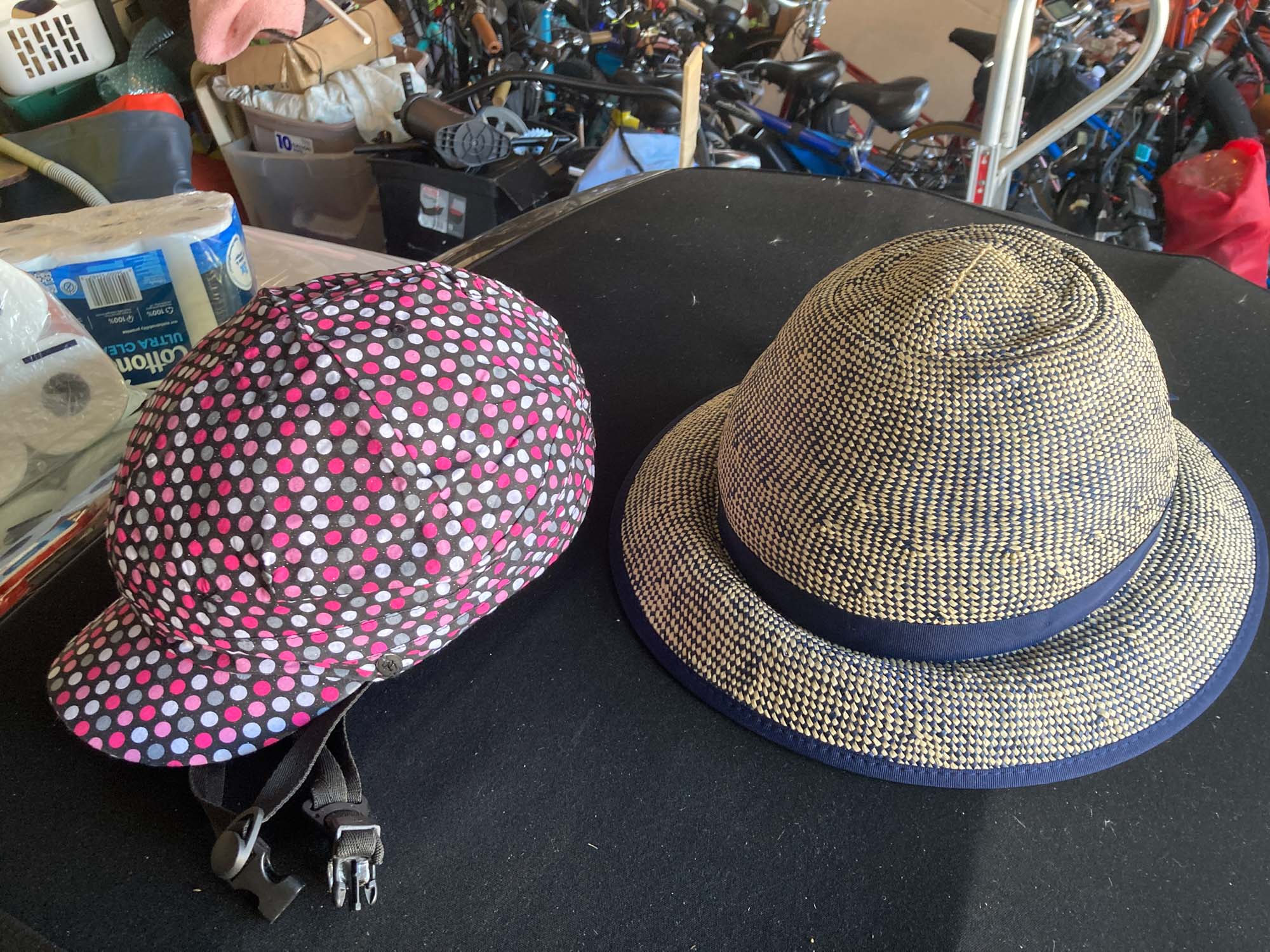

Bought my wife a $29 pinkish knit helmet cover off Etsy. It works to keep the sun out of eyes. The other one is pretty expensive from bikepretty as it's sold with a $120 helmet, Ladies love their fashion.

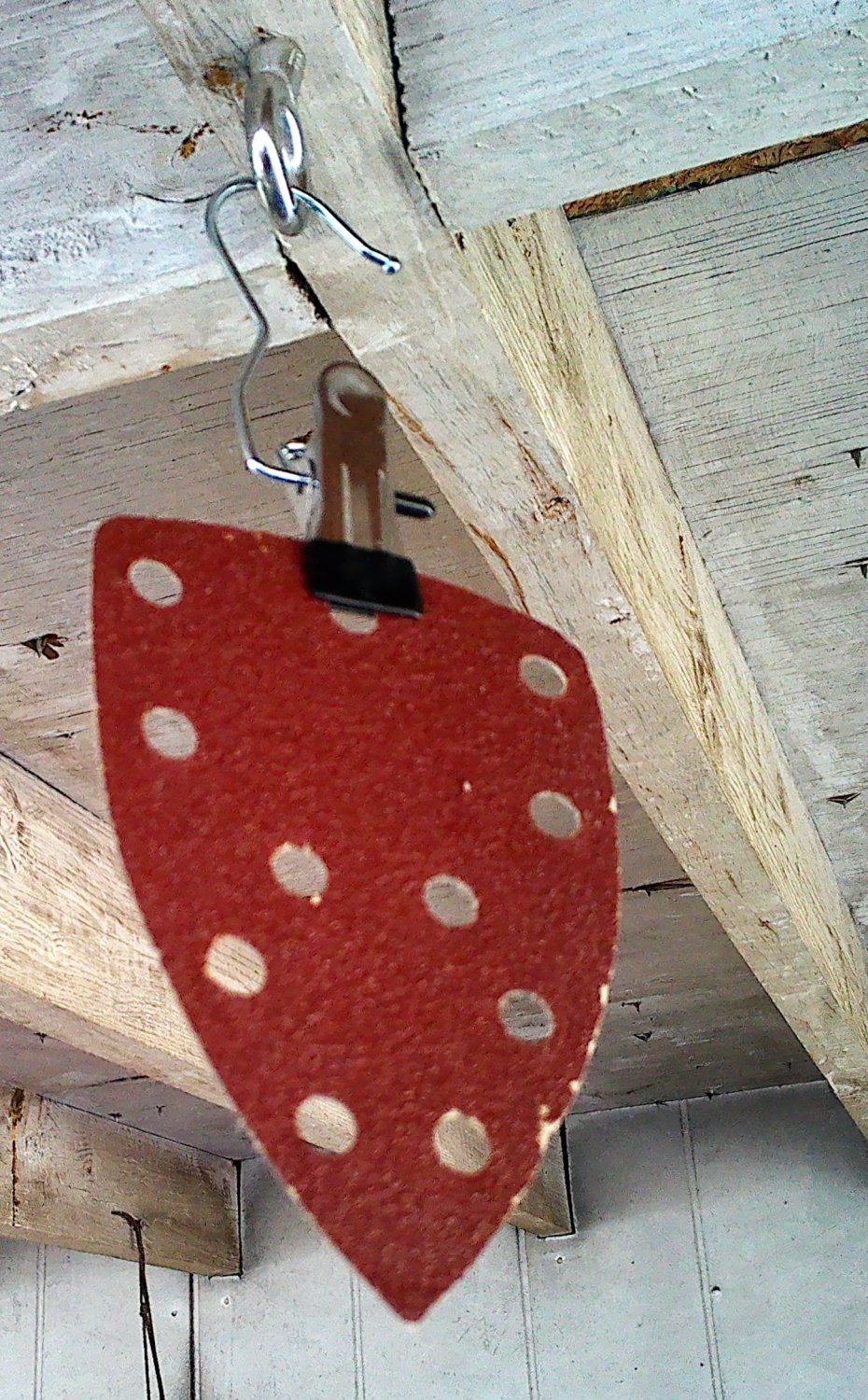

It's a polypropylene cutting board that I sand occasionally so cuts won't harbor pathogens. I tried 240 and 60 grit. In both cases, powder quickly accumulated. Maybe I could have cleaned them dry with a toothbrush, but I washed them and hung them to dry with hanger clips. I bought 24 two weeks ago, and they're so useful that I just ordered 24 more.
Maybe your sanding belt throws off powder on those sharp turns around pulleys.

It weighs 2.8 pounds and covers 12 square inches, so it's 0.23 psi plus a little hand weight. I don't press.
Yes, the belt does throw off grit. The machine has a vacuum port which also sucks the stuff off.
