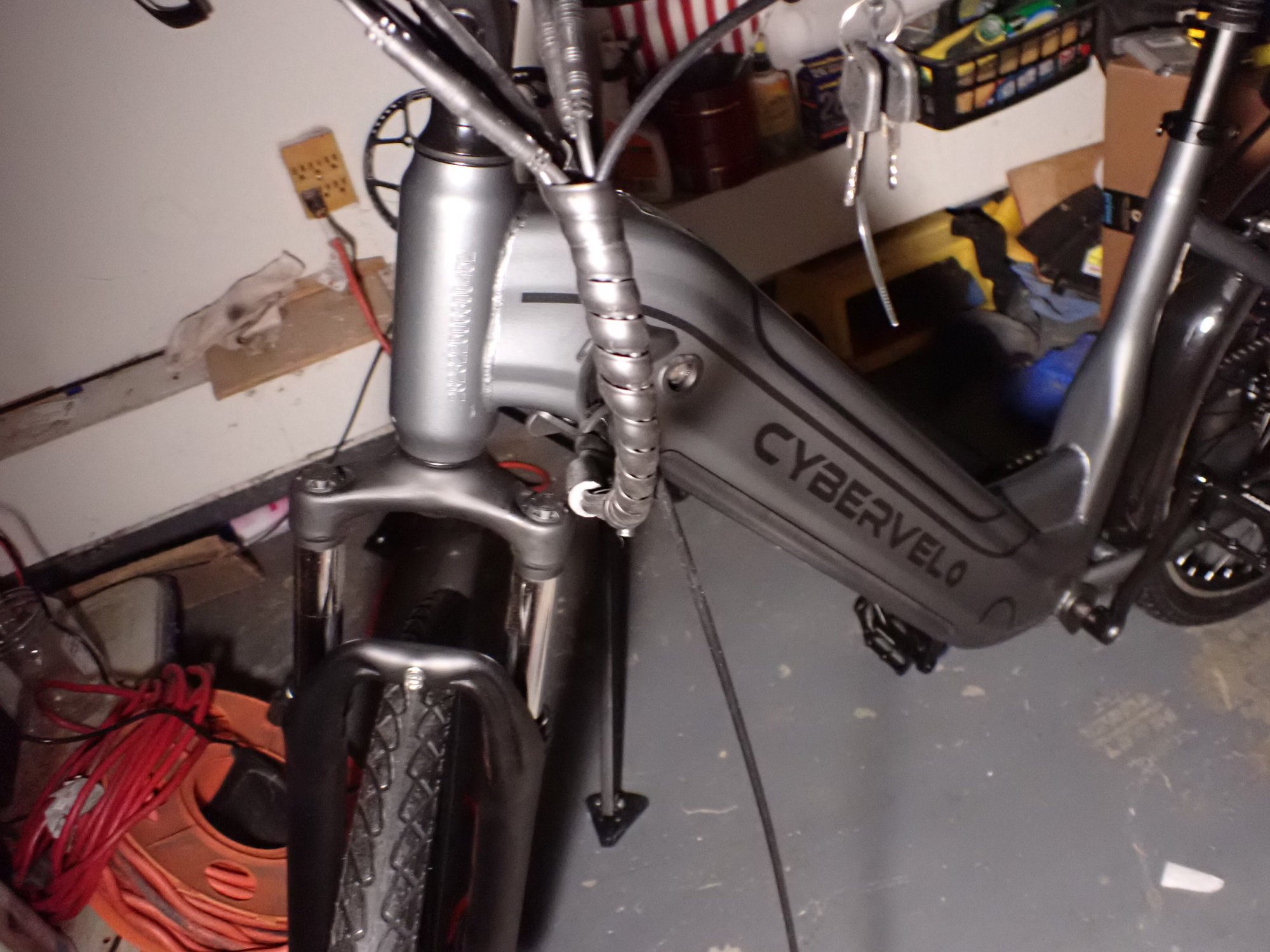

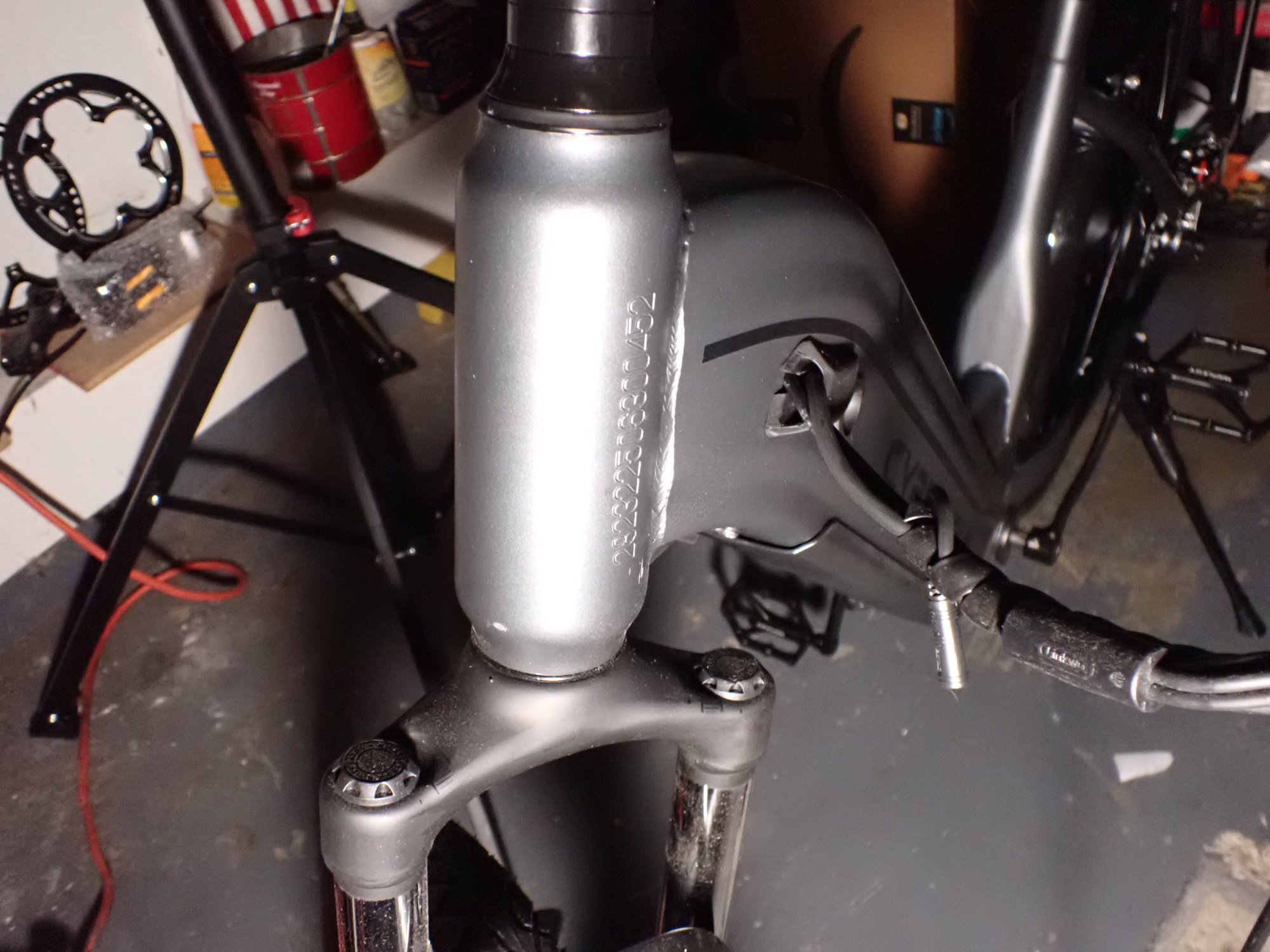

The Cybervelo EK7 showed that it had the four mounting screws on the head tube to frame mount a front basket. I had bought the basket but when the bike arrived it did not have the mounting plate welded on..

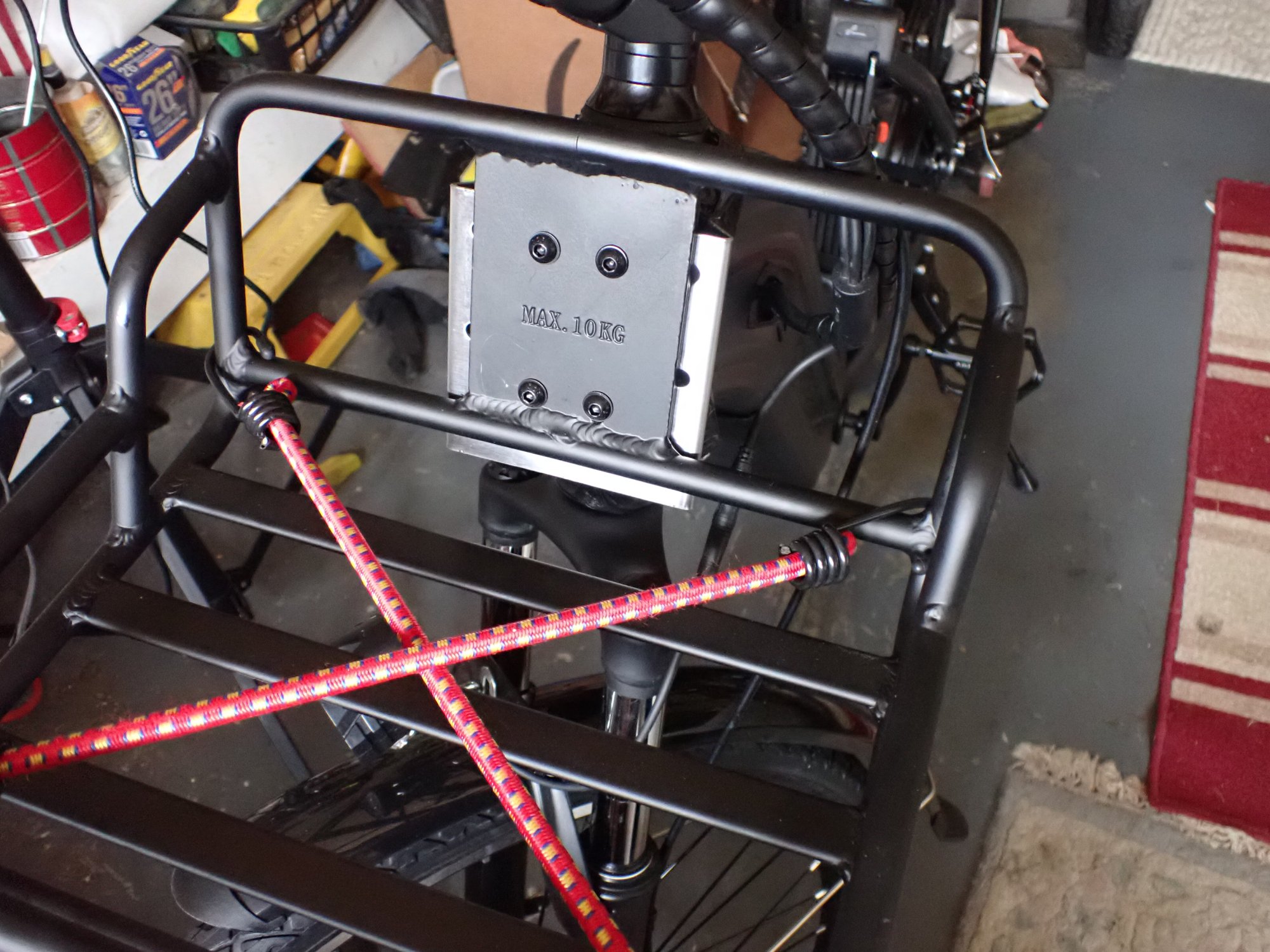

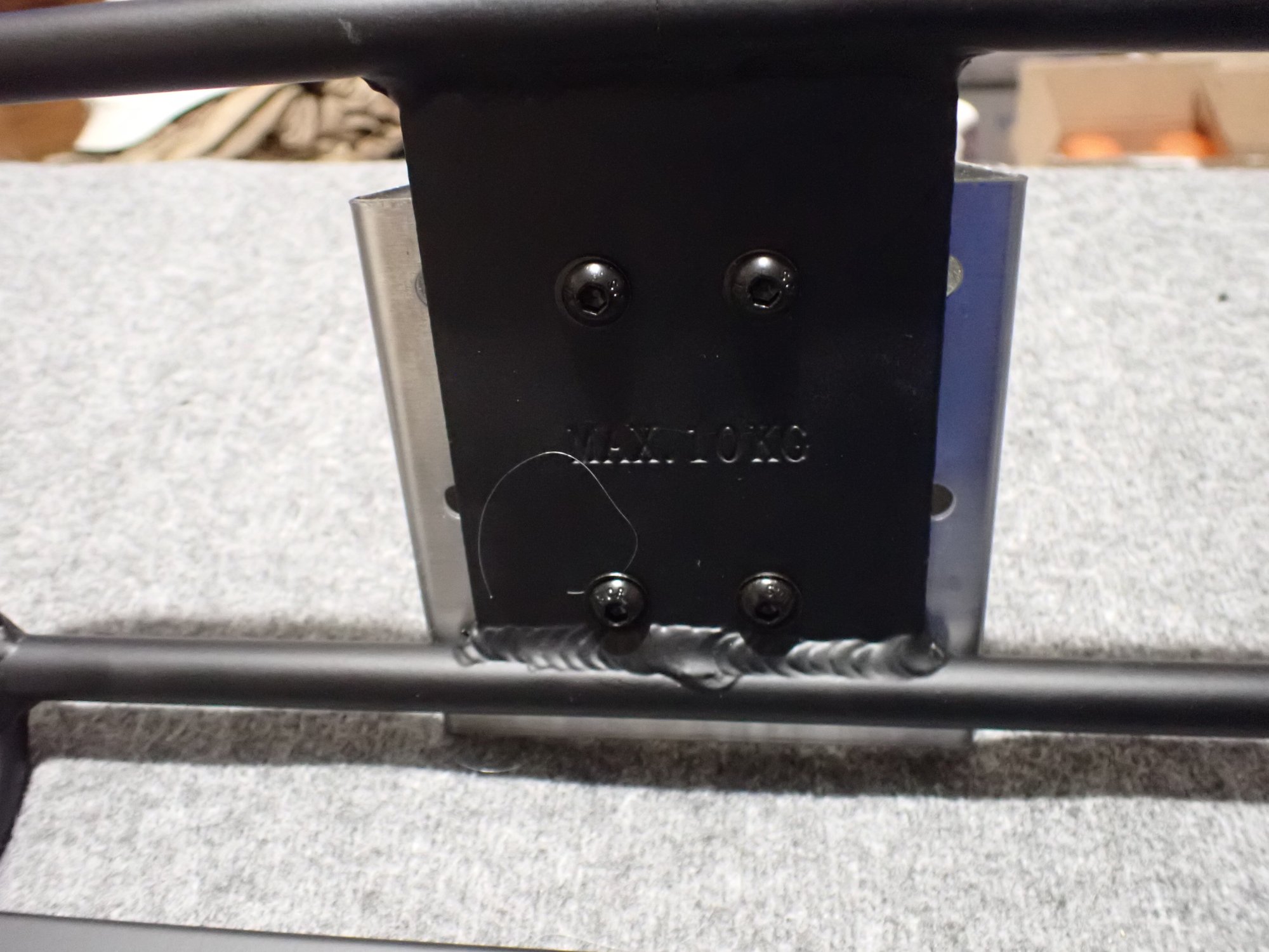

In order to center the basket on the mount I needed to drill two new holes and enlarge two holes.
The included clamps were way too long so I made two custom clamps using this kit

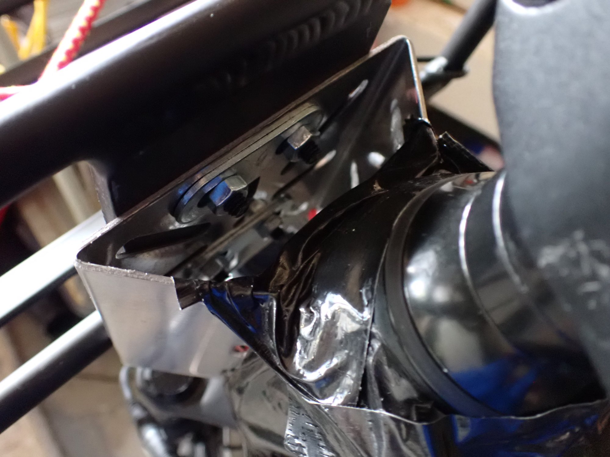

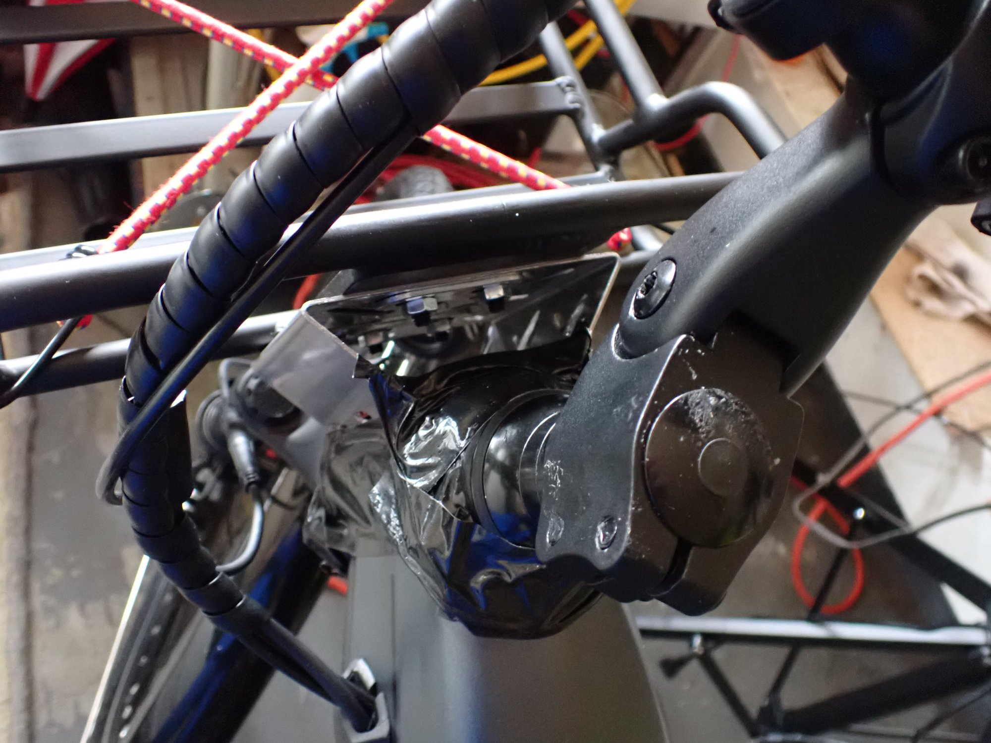

One clamp on top and one clamp on the bottom of the head tube and tightened them up. I covered the head tube with duck tape first for some protection then attached the clamps, tightened and covered with more duck tape. Solid and secure now....
Might not be the prettiest look with the tape but a solid mount is functional where none was before.
