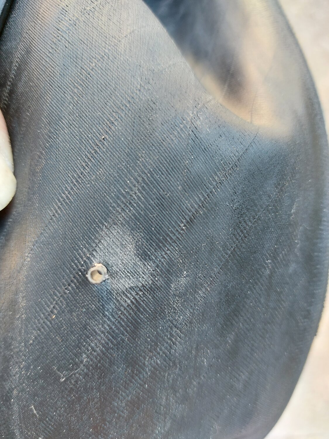

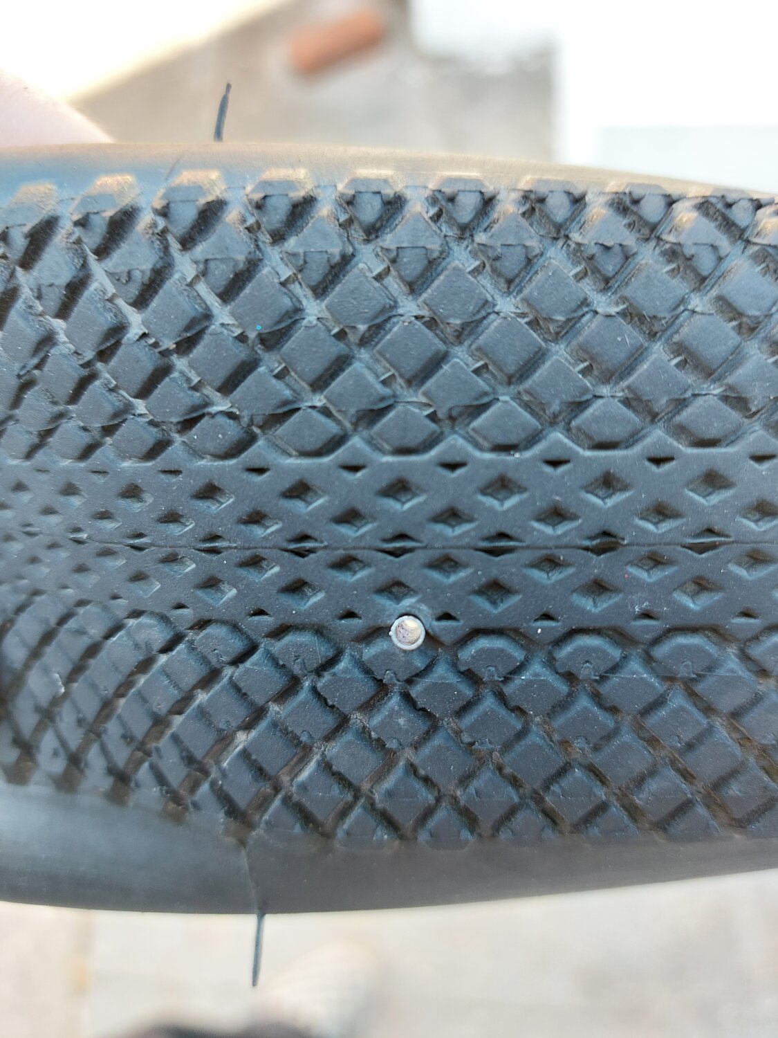

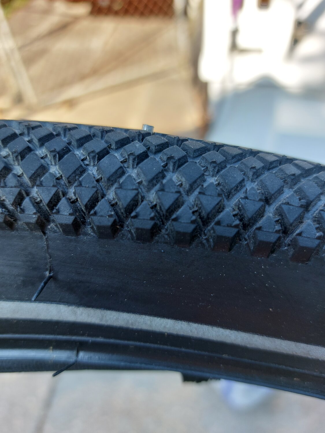

I wasn't a pinch flat. I ran over the smallest little hollow metal tube. I need to try and post the pictures. It was incredible in how perfect it went into the tire and tube! I know the rear wheel is actually easy to remove on the E-Lux now, but I still hate flats! I checked the clearance and I think I can go a bit wider on tires if needed. Still considering Big Bens but the Marathons get better puncture reviews.

I hope the pictures worked! On my new phone, still learning! Hollow steel tube got me good.
That was a freak occurrence, comes under the "STUFF Happens" clause.....
I doubt there is much that would have saved you in preventing that flat....
