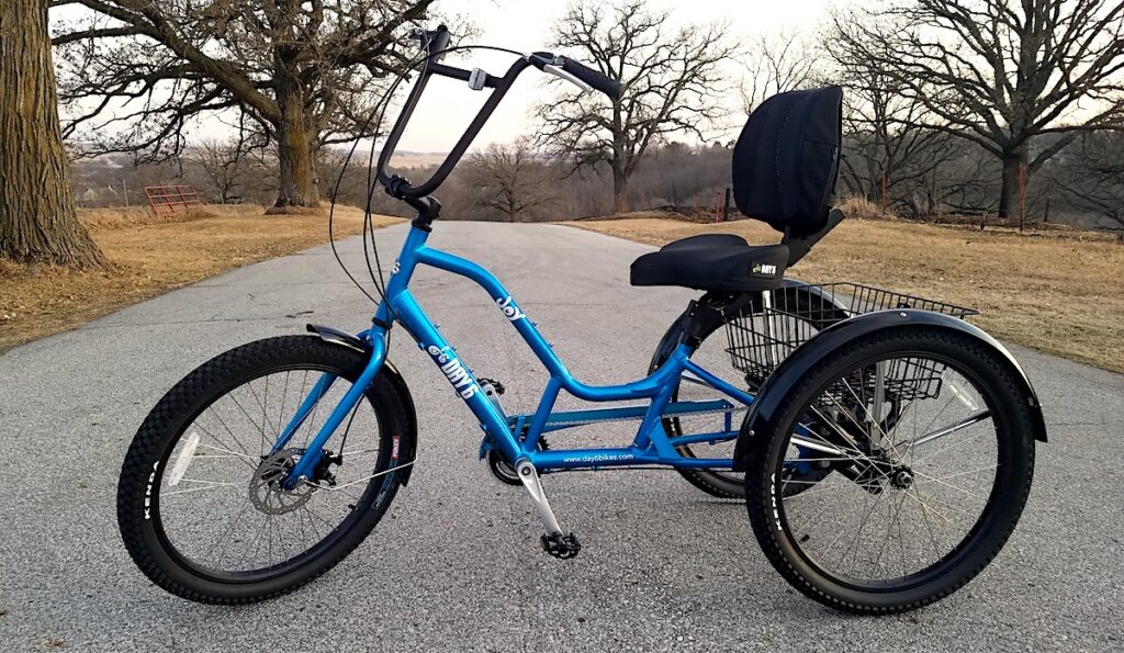

Q1 Delta trikes are easy to flip. Speed must be limited.
Q2 A conversion trike IME can be a much better build.
Day6 builds a real nice eTrike. Link

I agree with Tom. (Pardon this brief veer off topic. Tom, I need your advice: Is a BBS02 shift sensor directional?) Back on topic. Most moderately priced trikes drive only the right wheel. There is no complex and expensive differential, so steering is different left, and right. It takes practice. And yes, they are two dimensional objects. Leaning can flip. Extending your arm forward while steering will change your body mass center making one rear wheel lift. Again practice will help with this.
