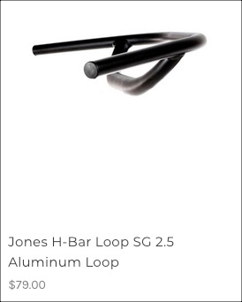

So.. wondering what specific high rise bars and stems anyone has used successfully to get a really upright riding position on the CrossCurrent. I have researched this more than I care to admit.. and the CrossCurrent looks to be the perfect bike in my price range IF I can fix the riding position.
I would love to do something like this bar
and one of the adjustable angle stem extenders.. Just don't have any way of knowing if this would work.. as it is hard to know how much slack is really in the cables..
I suppose I could (??) get longer hydraulic brake lines and electric motor control cable extenders too... but that seems like a lot of work..
