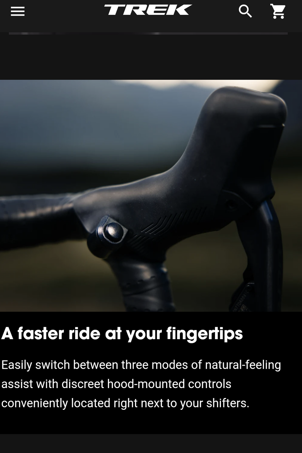

I would take the Creo over any e road bike because it is the only one (I believe) that let's you control the level of assist from the drops (or wherever you want). Having to cycle through a button on the top tube will get old very quickly. If you found me a bike lighter than an S-Works Creo, that assisted to 28mph, and that let me control assist with hands on the brake hoods, I would consider it.
Changed my mind! They closed the gap. Now I'd rather have a Trek Domane+ SLR 9 Project One Shimano except for dealer issues. At least, the Creo needs constant updates. My Specialized dealer does these for me on the spot, while I wait, for free, in 5 minutes. My Trek dealer (who also does Specialized) takes 2 weeks and charges $25 for an update. If my Trek dealer were good, I'd look very hard at it.
