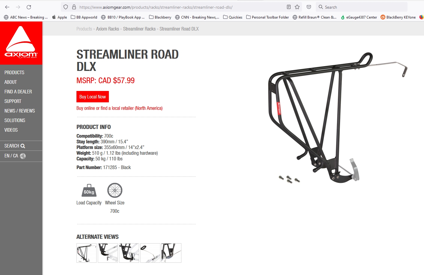

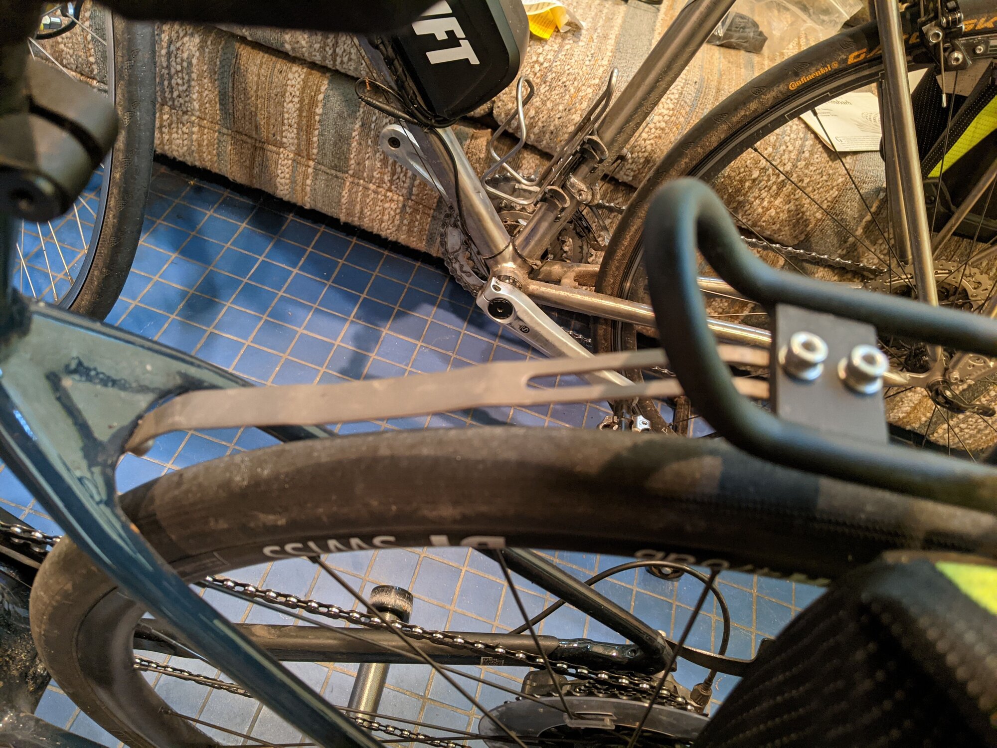

I got mine at the local shop. I believe this one is mine:

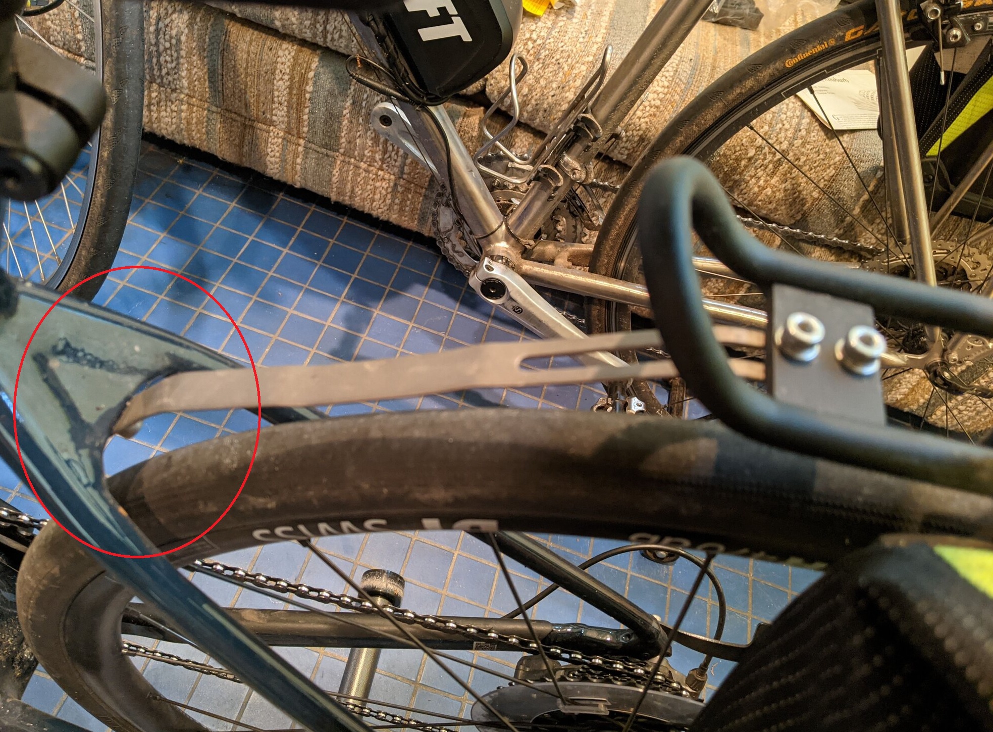

Is this creo?
Mine does not have this one here.
I have the aluminum Creo. It might be there but you have to feel for it. Good luck. Otherwise, I think there are collars that can fit on the seat post that provide attachment points.
With a carbon frame I'd personally want to go with the seat post mount, instead of using the fender mount. Heck, if the seat post can support the entire weight of the bike on a bike stand I doubt the attachment for the rack will over-tax it.
correct - and there is no “fender” mount on the carbon frame. even for fenders, you have you use the seat-post adapter collar. also beware that the seatpost is obviously capable of supporting a lot of load, but like all carbon parts is not designed for very high clamping or eccentric loads relative to the long axis. i’d be pretty conservative about loading a rack on a carbon bike, even a sturdy one like the creo.

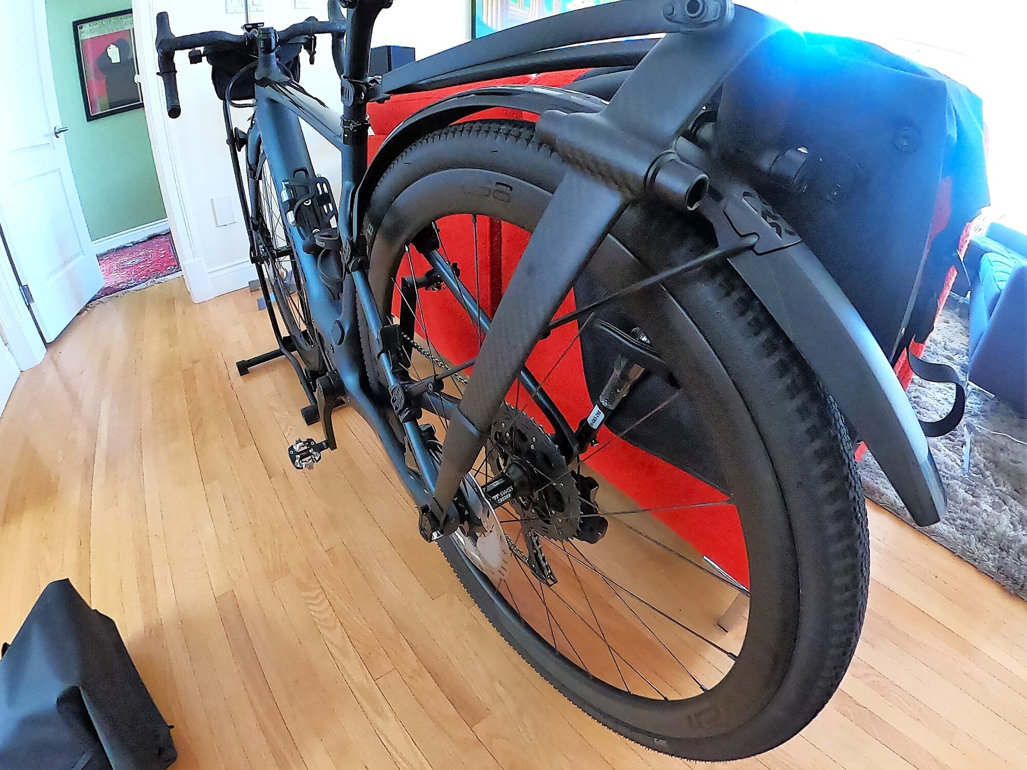

I have the Tailfin they are very well built and constructed. The weight of the rack sits on the through axle with the seat post attachment to keep it steady.

Yes it's a 5mm. I think they have added to their axle offerings but at the time they recommended the universal which is two pieces. It is easier to install on the non-drive and remove on the drive side. I went with the Carbon Aeropack with pannier mounts and fast release dropouts. I also have a set of frame mounted adapters on a second bike. It is cheaper to get the small accessories with your main order due to shipping. I went with a set of the mini panniers assuming I could use their pannier adaptors if I need a larger bag. The Aeropack is nice because it's easy attach it just before a ride if you need to carry more clothes or a RE battery. Everything is extremely well made with excellent fit and finish and they do not cut any corners to make sure it all does what it is supposed to do.

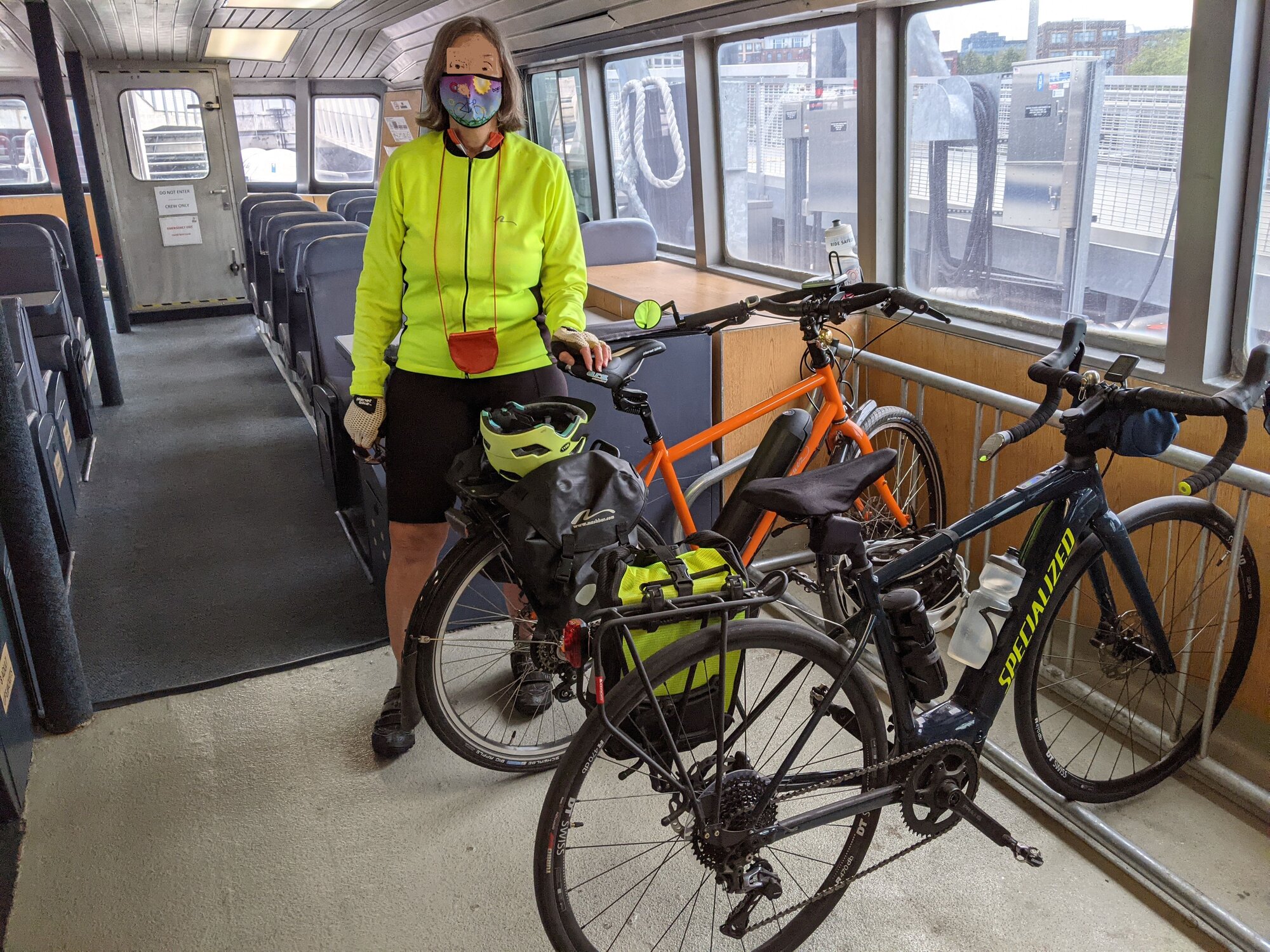

I bought the 10L panniers but have yet to use them. The last tour I did several years ago was using ultralight weight backpacking sleeping gear (tent, sleeping bag, air mattress) in one small Ortlieb pannier (front bags used on the rear) and one with clothes on the other side. I had a small Ortlieb duffel bag I could use on the top of the rack to hold daily food. We did all eating in villages or towns and did not need cooking gear. The light weight and the easy on and off with the Aerorack was the main use case for me and I do not like seat bags. I bought the panniers for future use hoping to do another tour and I still have a set of Ortlieb panniers if I needed something larger.

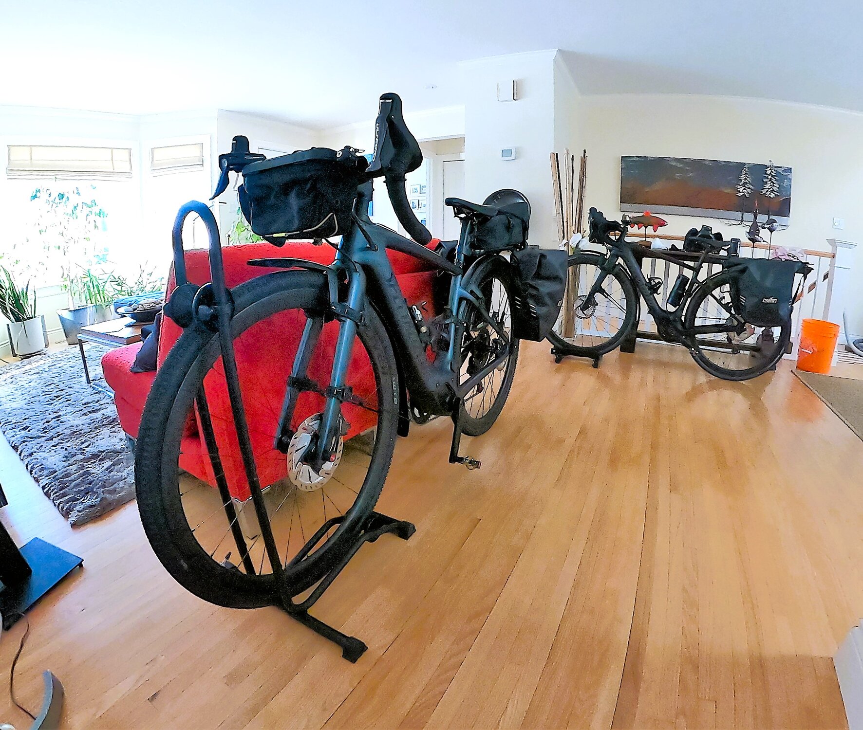

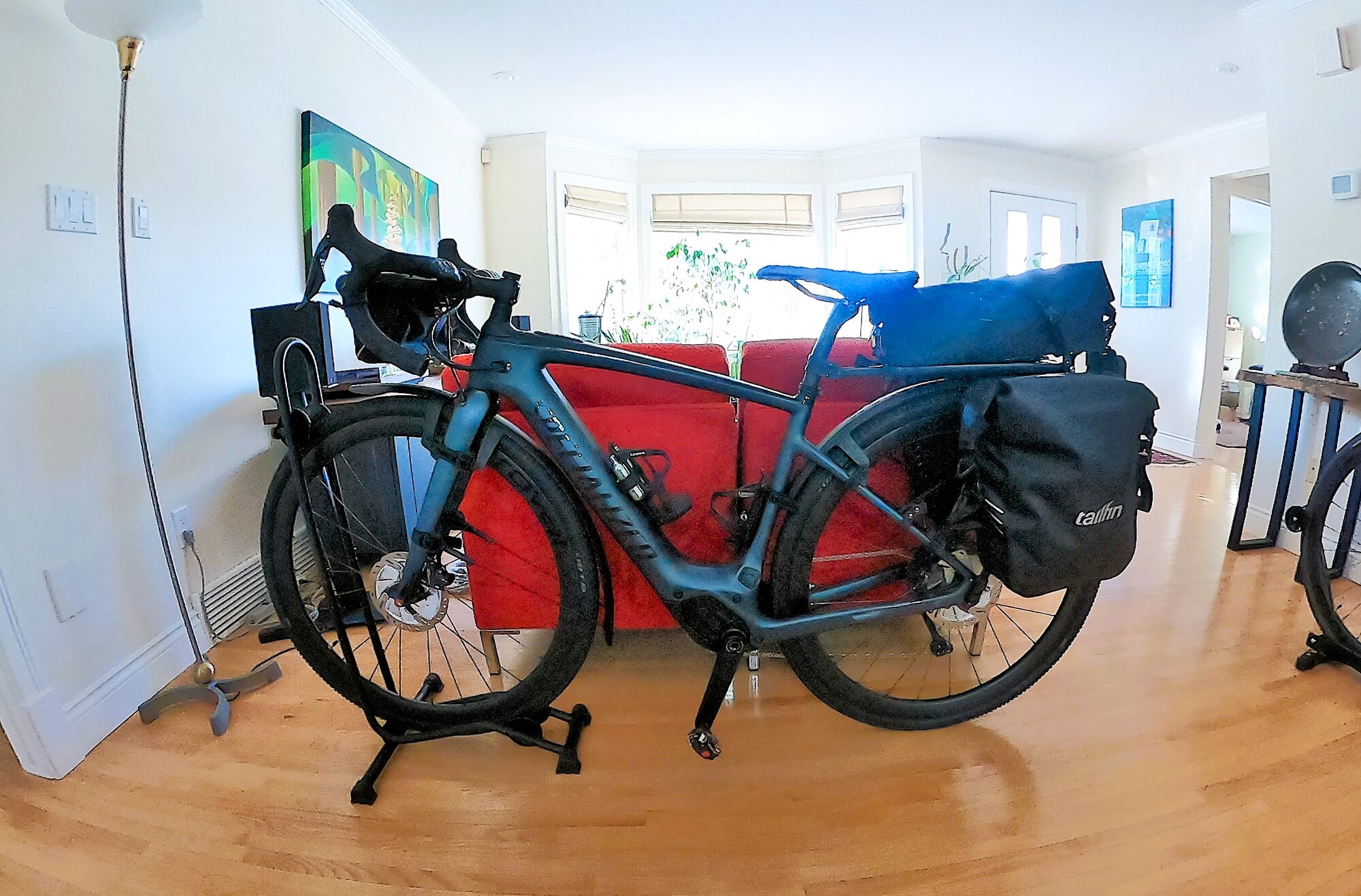

We spent the last few days going over details for our west coast trip including sorting out the packing protocol for the Tailfin bags. We still have yet to nail down a departure date but it’s looking more like June as my wife expressed interest that she would like to visit family overseas in the fall.

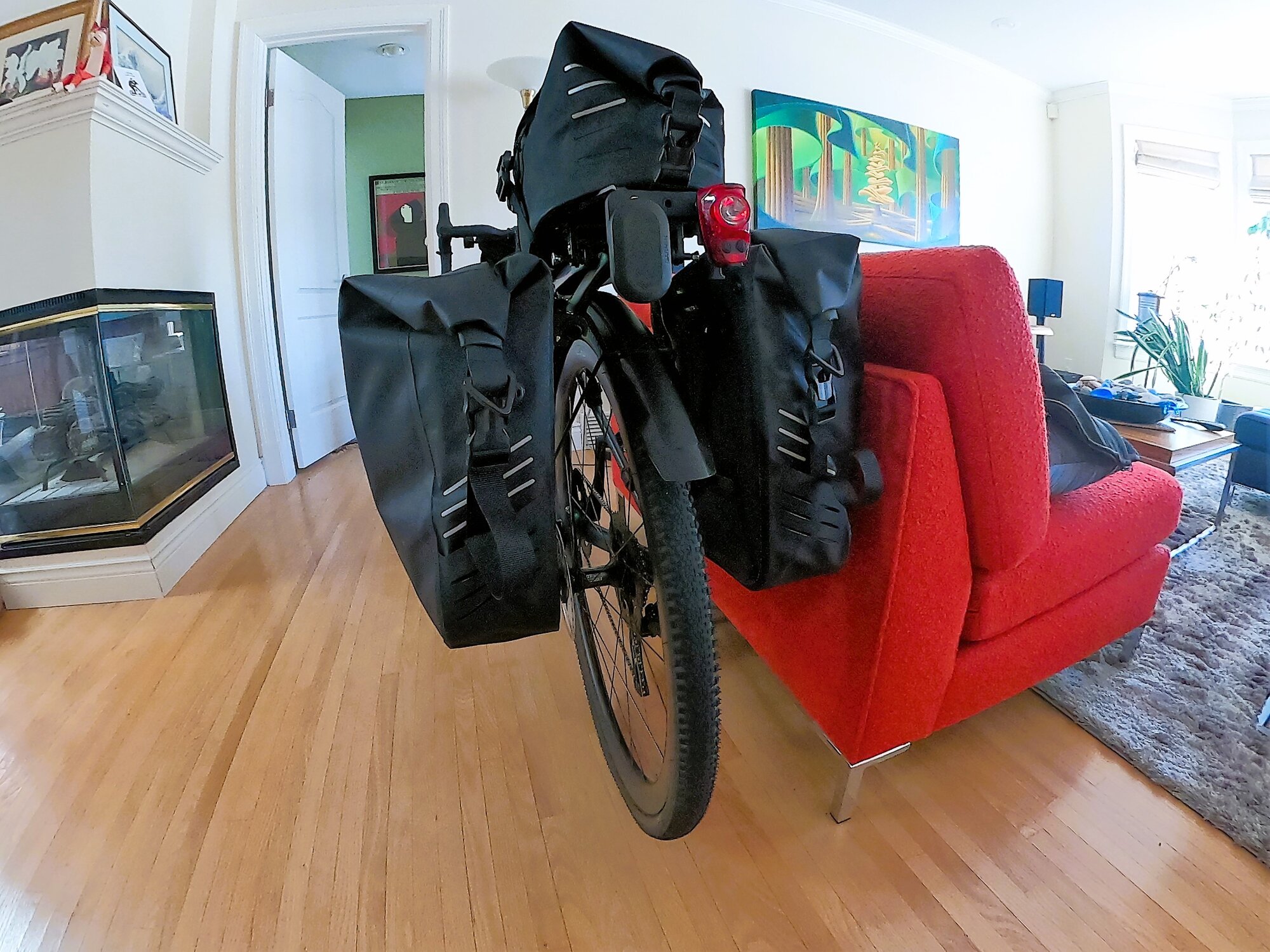

My wife decided that she didn’t require the 20L trunk bag but I’ll likely make use of it to haul around camera gear and light snacks for the ride.

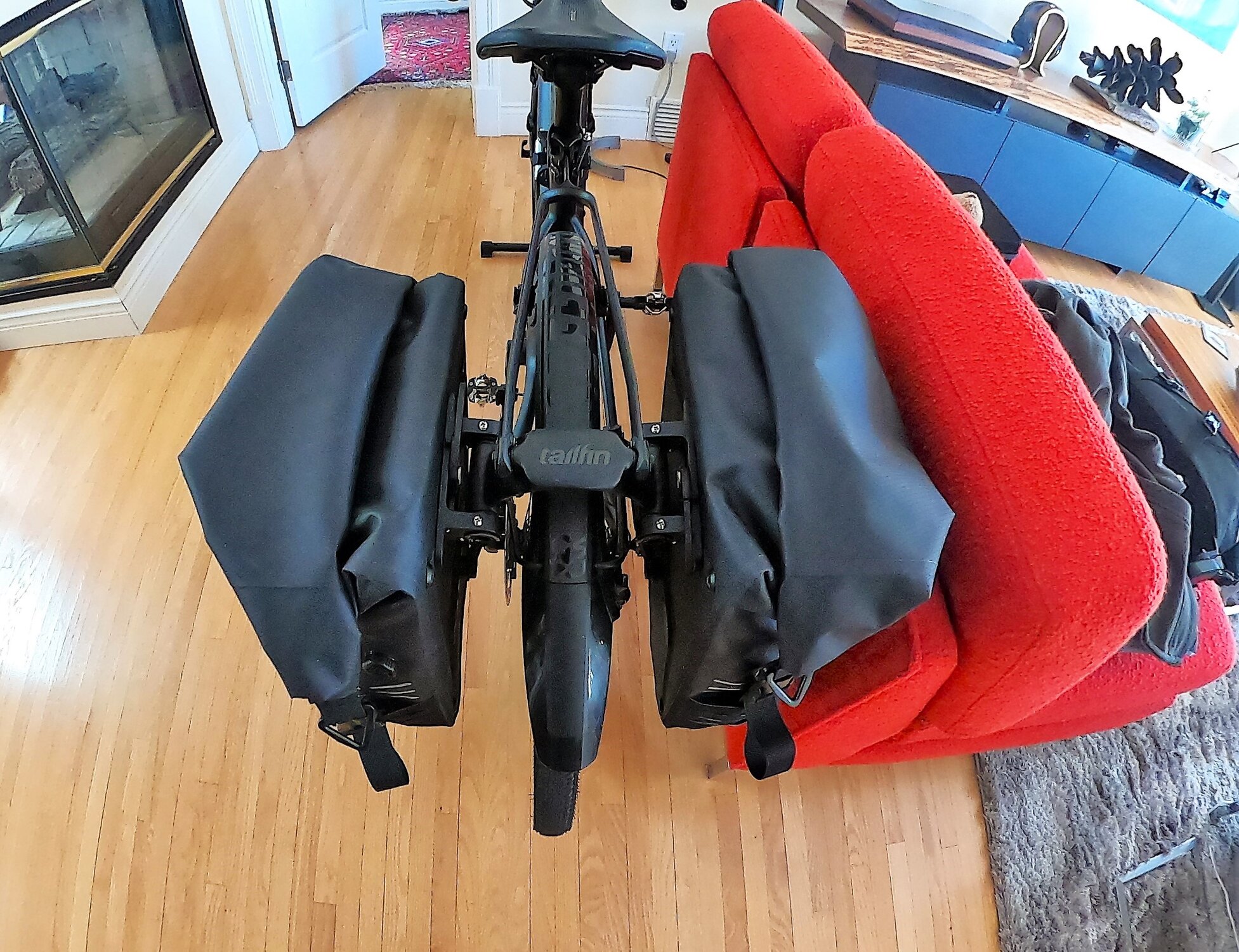

With that said, I’m really impressed at the amount of detail that has gone into the design and manufacture of Tailfin’s products as everything fits together in such precise manner. There was absolutely no jiggling of loose parts/components and the panniers in particular with their clamps are held solidly onto the mounts. All of the bags and rack are easily removed in matter of seconds. A thru-axle setup means that virtually all of the weight transfer occurs at that point and does not impact the frame whatsoever.
We both opted for the roomy 22L ultralight panniers and there’s no doubt that we’ll come to appreciate the additional capacity. I performed a mock packing session and filled all three bags with what I would likely be bringing along on the trip including cycling/civilian apparel, sneakers, toiletry case, rain gear, electronics (including a 13” laptop), charger for the Creo/RE, first aid kit, field repair kit……
Tailfin’s max weight capacity for each 22L pannier as well as the 20L trunk back is reported to be 9kg (20lbs)/bag. Each of my panniers tipped the scales at around 8lbs and the trunk bag came in slightly less at 7lbs so there was still plenty of weight tolerance for items that I may have neglected to pack. I know that I won’t be achieving the max limits that Tailfin has prescribed but will continue to try and keep the weight down to a minimum over the long haul without sacrificing essential/practical items.

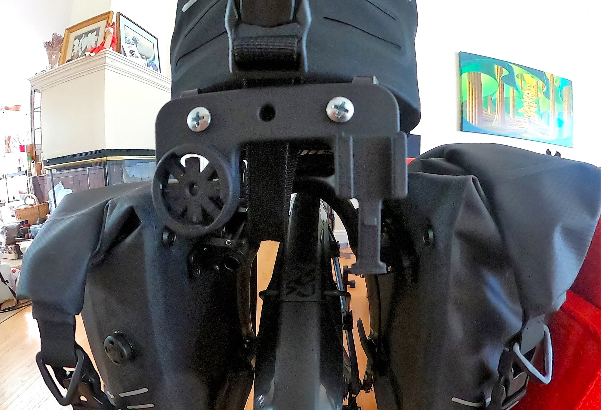

A Shapeways 3D printed mount for a Varia and Cygolite Hotshot gets bolted on to Tailfin’s fixed light mount which is screwed to bottom of the trunk bag. I’ll likely be fabricating a closed cell foam/plastic mount setup for my wife’s light and radar that will wrap around the top of the rack’s arch.

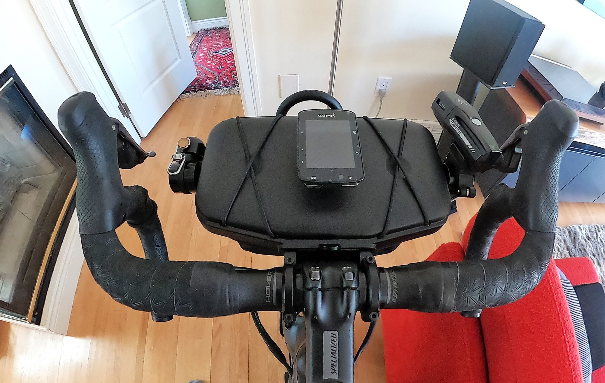

We’ve also paired the rear bags with a uber functional handlebar bag from Routewerks. I’ve written a review of it here.
