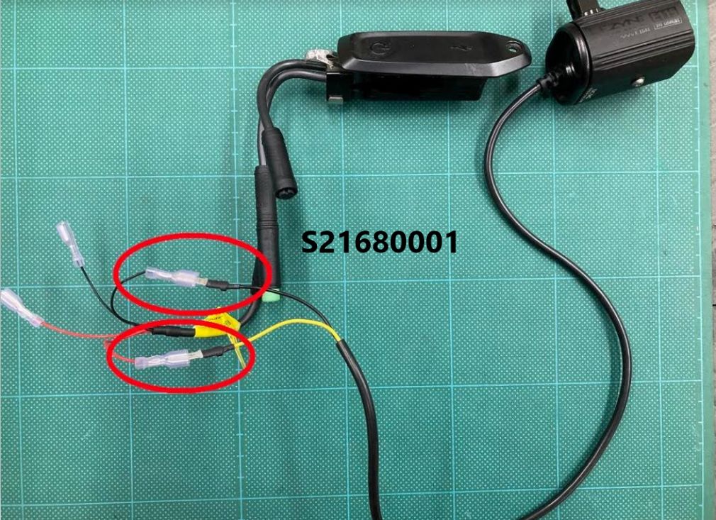

Finally I got the front light that I ordered from Germany. Cateye GE100 which is made in Japan. I have tried to find 12V pins on the splitter cable S196800022 . I only found 3.2V. Anyone know how to hook up the 12V power lines from the light to the splitter cable?
I contacted Specialized customer support yesterday and figured out what my problem was. The split cable S196800022 is not correct part for the CREO. I looked at the same page in the manual. The part number is now S206800003 and it all makes sense.
