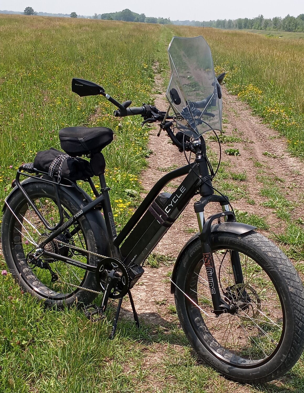

I ride my cruiser as much as I can stand under power of my feet. 73 year old heart+lungs need the exercise. But when the wind in my face drags me down to 4.2 mph and it takes me 6+ hours to ride 30 miles, on goes the power. I do not have a choice of riding a shorter route; not if I want to eat & sleep in my destination house that night. 3.7 hours of >128 bpm exercise is enough.
Indianajo: Thank you. You just inspired me to tackle the job. I have a pedal assist eBike and also go to the gym regularity to exercise for my 80 year old heart and lungs, (got you beat)—this throttle-only conversion job will be designed to give me a little pleasure break from 75 years of pedaling. And heh, I get your point—for certain, pedaling 30 miles in six hours is WORK.

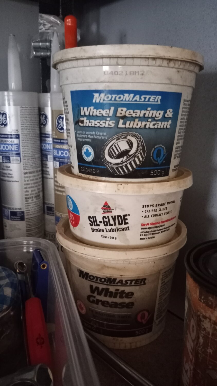

I used bearing grease on my old Raleigh 10-speed.
It was a 3 piece crank, but there was no bearing cage, just loose balls.
NGLI #2 automobile grease is waaaay to thick for bicycles. Suitable for 140 F use at 100 mph, or on truck wheels carrying 8000 lb at 75 mph. I ride at 0 deg F, I cannot imagine fighting that compound. I use petroleum jelly on the bicycle wheel bearings also, at my 10000 mile lubrication. I have never seen any sign of wear on the balls or race.
Lubriplate might be okay but I have not seen it for sale for decades.
