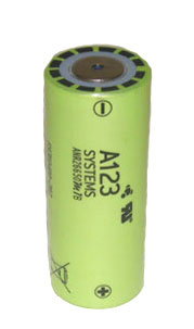

Ping batteries are highly respected but significantly more expensive. (Looks like he’s gone off line) :oops: I’m going to build an LiFePo4 with A123 style cells.
I've used these exact cells in radio control, where they are considered top shelf stuff. Sometimes hard to locate A123....

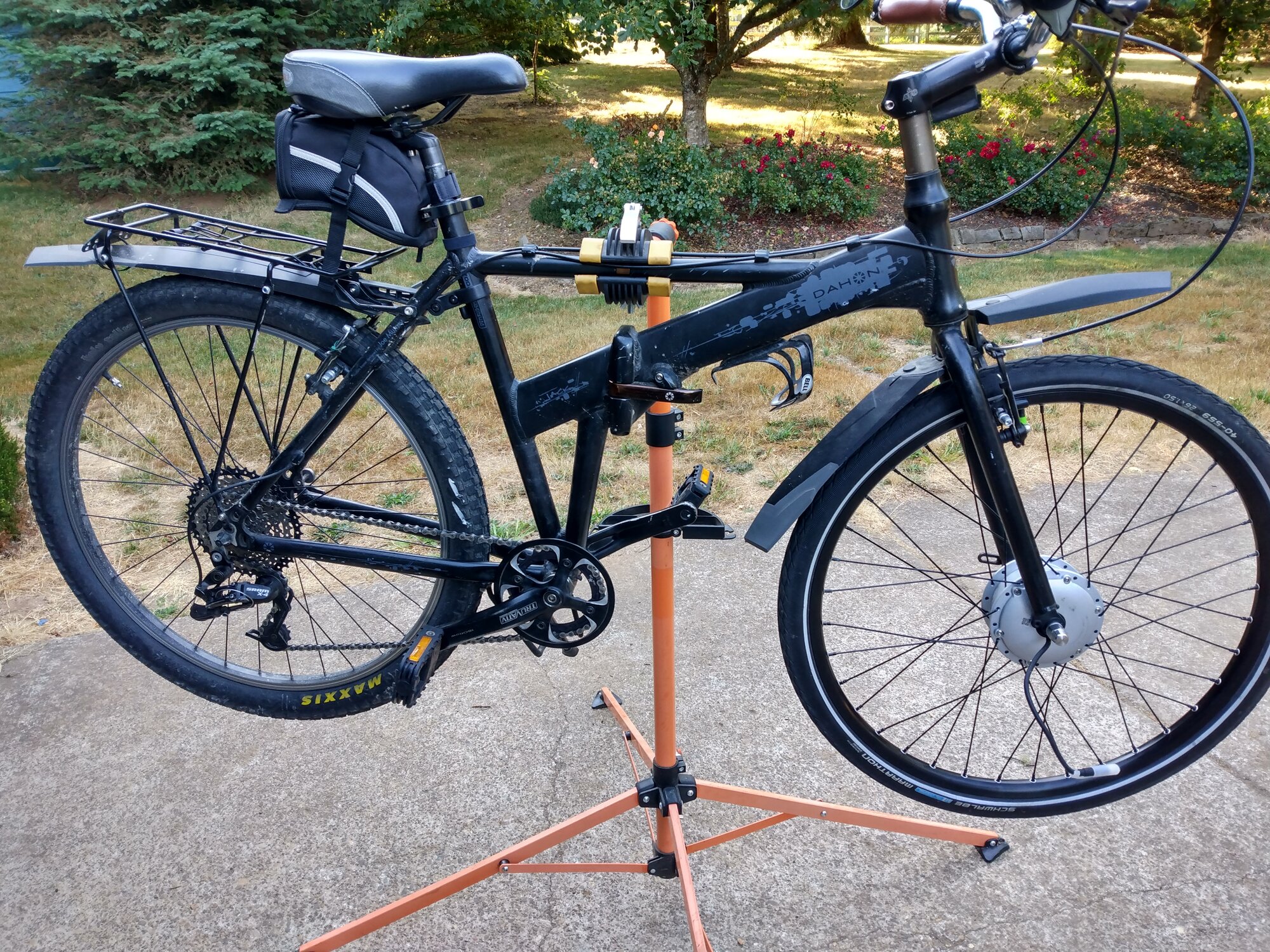

I'm putting the $60 bafang front geared front hub motor on my Dahon Jack folder. Scavenging the controller and peripherals from my mountain bike. Need to get torque arms and lawyer lip spacers then see how it does. Might bring this bike for my upcoming crater lake ride along with the stock front wheel to switch out and have a lighter non assist bike to ride.
I'd take a good close look at the front dropouts. If they look good (nice and thick and undamaged) I'd consider filing out the lawyer lips and getting a good solid pair of the tabbed washers like these instead - https://ebikes.ca/tabwasher.html. This way you'd have a nice solid and perpendicular surface for the outside washer/bolt to stay in contact with (providing a good solid clamping effect). I've always found that the washers that build up the lawyer lips never seem to end up with a perpendicular surface, plus they take up some valuable axle space.
