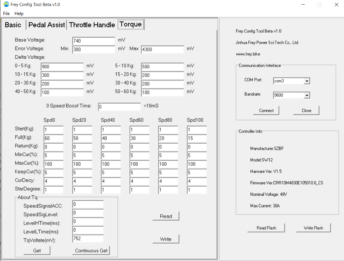

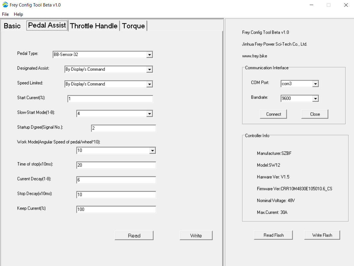

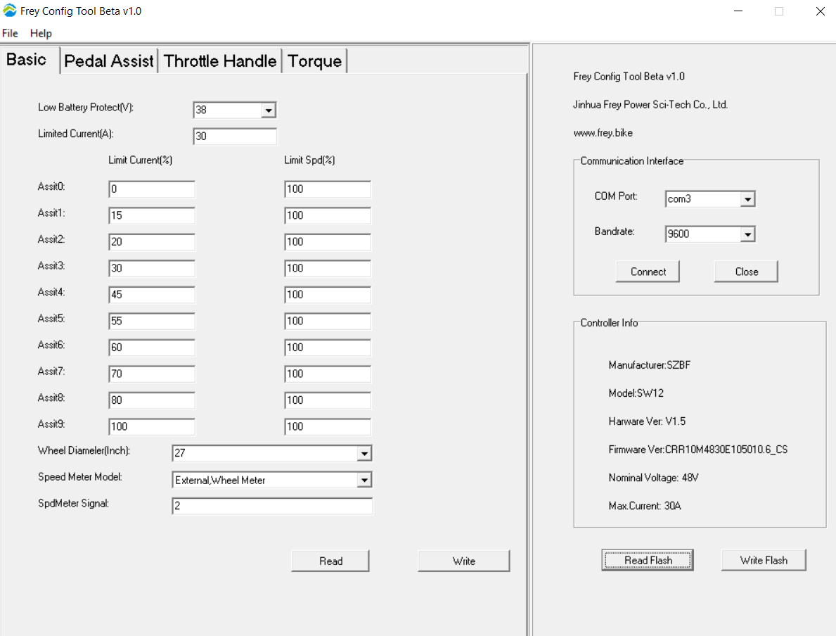

In the first note, I posted this link to the article containing the following screen shots, which are the "Smooth Tune" :

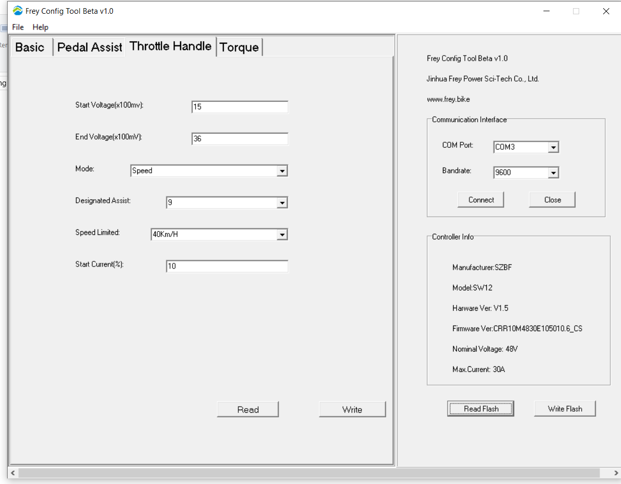

Note that there is no "throttle handle" screen included in the "Smooth Tune". I assumed that was the same as in the article/information above the "Smooth Tune" info. I've pasted that page last to try to keep the known "Smooth" settings together.
