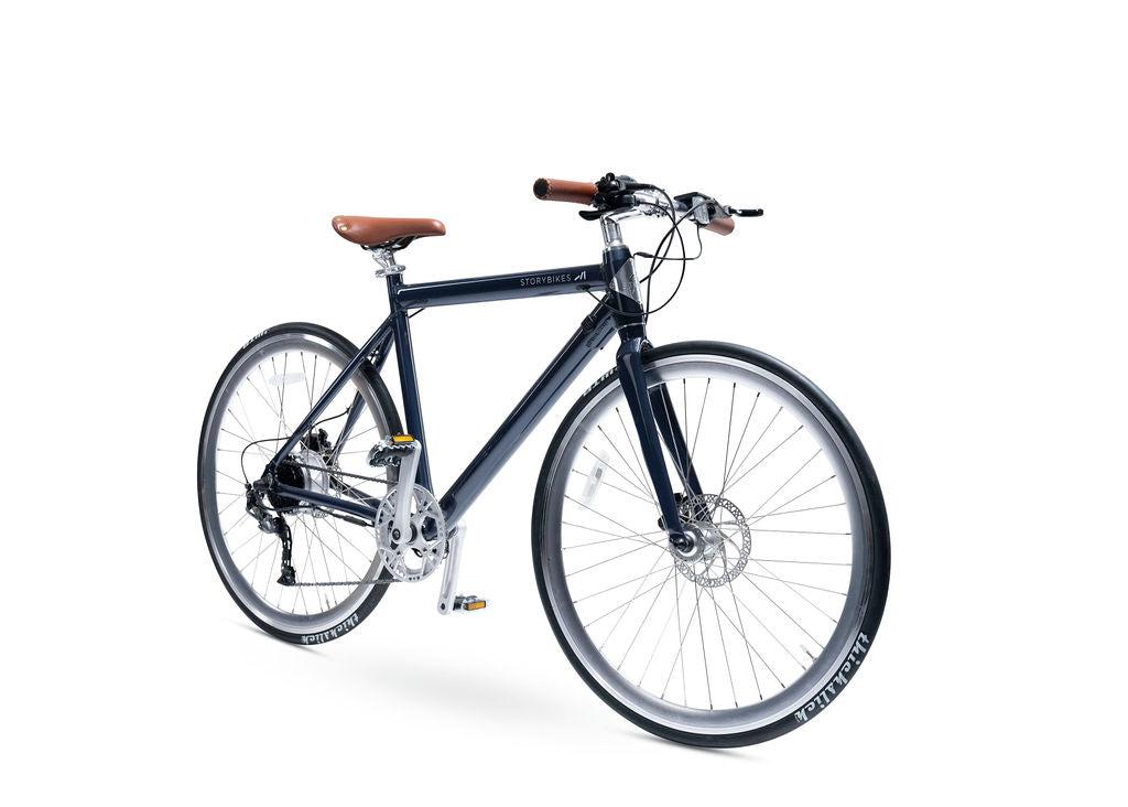

Don't know anything about the brand, but it looks nice and minimalist at 33lbs with a large frame option.

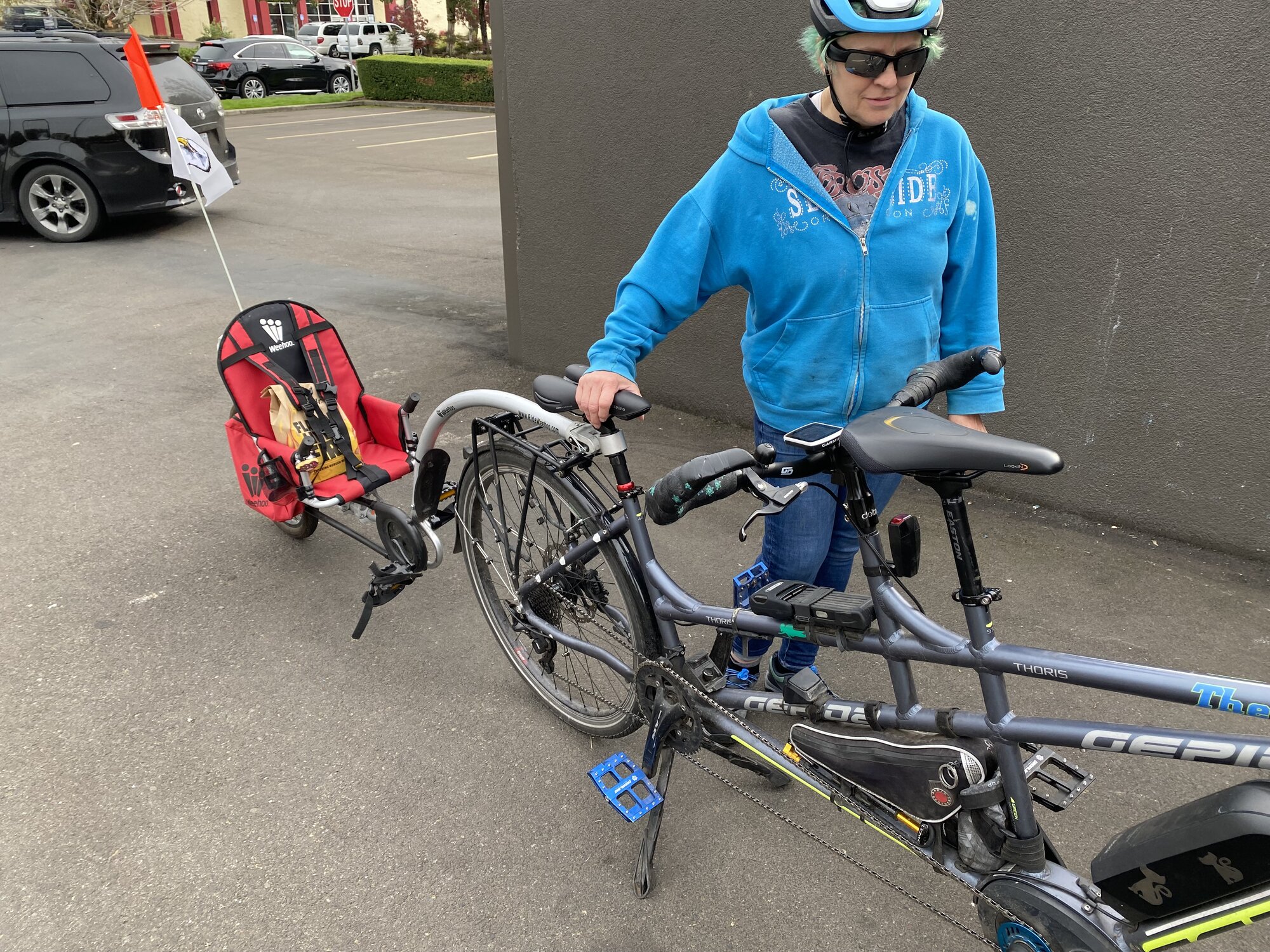

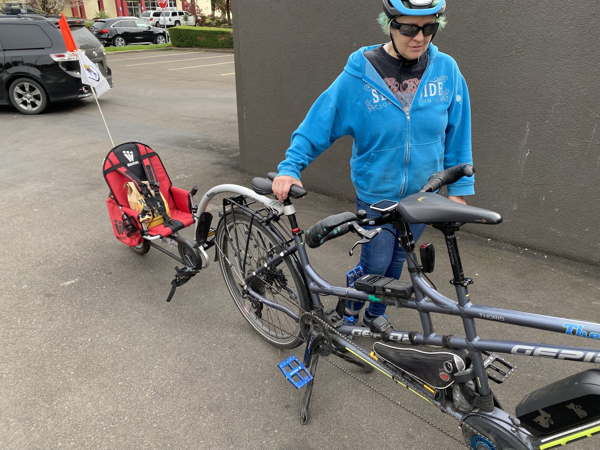

Tag along bikes ... I didn't know these existed 😳 Golly, what will they think of next ?
we have the weehoo fits even little kids and no chance of falling off.

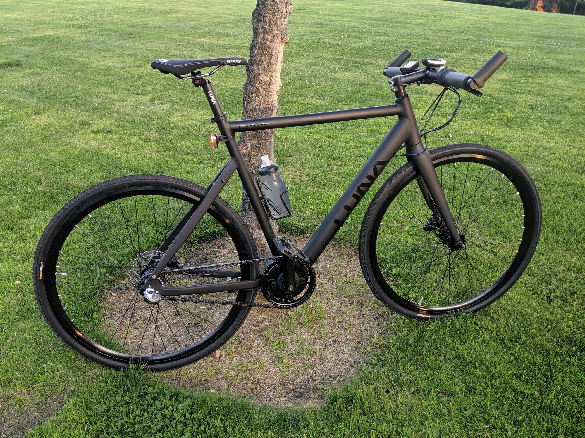

@mschwett it sounds like you are describing the Luna Fixed. I used to own one myself.
  • $1750 but if you are like me you will want to put in a proper set of wheels and customize bars, saddle etc. Saddle was actually pretty good but I had something specific (SDG Fly) I wanted to use.
  • 39 lb
  • 250wh battery
  • Battery integrated into frame
  • Gates belt
  • Shimano 3 spd IGH
  • 700C wheels (I had some wheels with DT rims built that were a bit wider and gave me a better profile and larger tires)
  • 500w mid motor that is really more like peaking at 400w unless they beefed it up. Mine was one of the first batch and they said 400w back then.
  • 35Nm sounds about right. Its not a powerful motor. Can't be with a 250wh battery. But it climbed hills surprisingly well in its lowest gear.
  • Size L (which is what I had) will fit a 6'2" rider. Has a 33" standover. I am 6' with a 33 or 34 inseam and you can see from the pic how my seat was set up.
  • Straight bars. I set mine up with extra narrow ones and bar ends.
  • Torque sensing. No throttle. Stealth appearance. Hydraulic brakes work fine.
Child seat? The bike has rack bosses but what is essentially a flat bar road bike should never be considered for a child carrier, and certainly never was by any designer stressing the frame. I'll leave that to you to decide.
Its the only ebike I have ever owned that felt like a real bicycle. Ebikes are generally bicycle shaped objects only. but this one was essentially a bike.
Pic below is from shortly after I bought the bike. The album linked below shows the bike in its final form when I put it up for sale. Has the built wheels, different bars and stem, flatproof Conti tires.

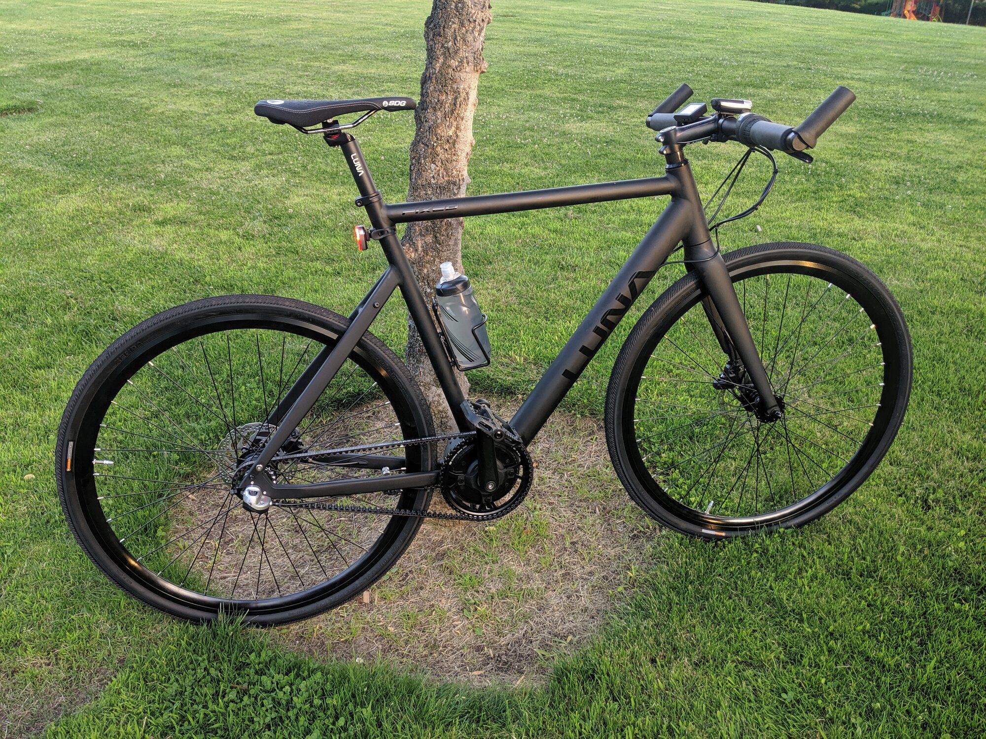

  • 39 lb
  • 250wh battery
  • Gates belt
  • Shimano 3 spd IGH
glad to find someone who has owned one of these! it was pretty much the closest thing i could find too, but i've never seen one IRL. very similar design in some ways to the van moof, but a bit lighter, mid drive, belt. nice!
i'll see if luna has anything to say about a frame mount child seat. not sure about the geometry with the dropped seat stays.
how come you sold yours?
