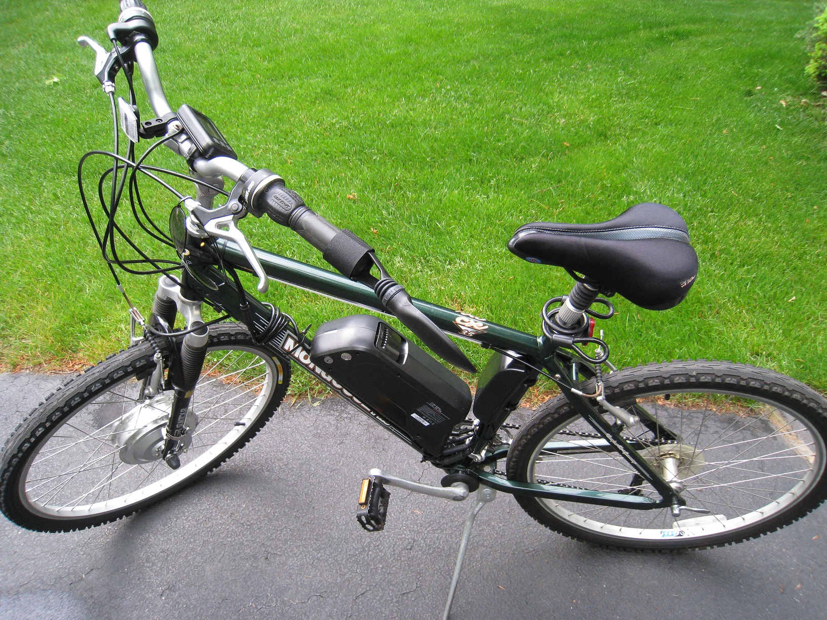

This past spring, I converted my Mongoose hybrid mountain bike to a front drive electric using a 500w motor. Most of my riding is in a mountainous region with lots of hills, so the power is a necessity. There is no perceivable drag on the bike, and I have ridden it on relatively flat terrain with no pedal assist. The only difference is the added weight of the motor and battery (about 21 lbs.). I average about 12-14 mph but the bike can do 22 mph. It also has a dual throttle. While pedaling, it acts as a full speed booster. While coasting, it is variable, which gives you flexibility.
The top end to the battery assist will depend on the gear you are in. In higher gears, you may be able to do 20 mph, while in lower gears, 12 mph may be all it will do.

Sorry for the delayed response. Leed makes the kit. The motor is an 8Fun geared type.
Thanks Tom. The parts work well together. I haven't experienced any glitches, and I really appreciate the much lighter weight compared to my Evelo, which is an excellent bike, but a bear to lift onto the rack. Leed is an excellent company as far as customer service goes.
