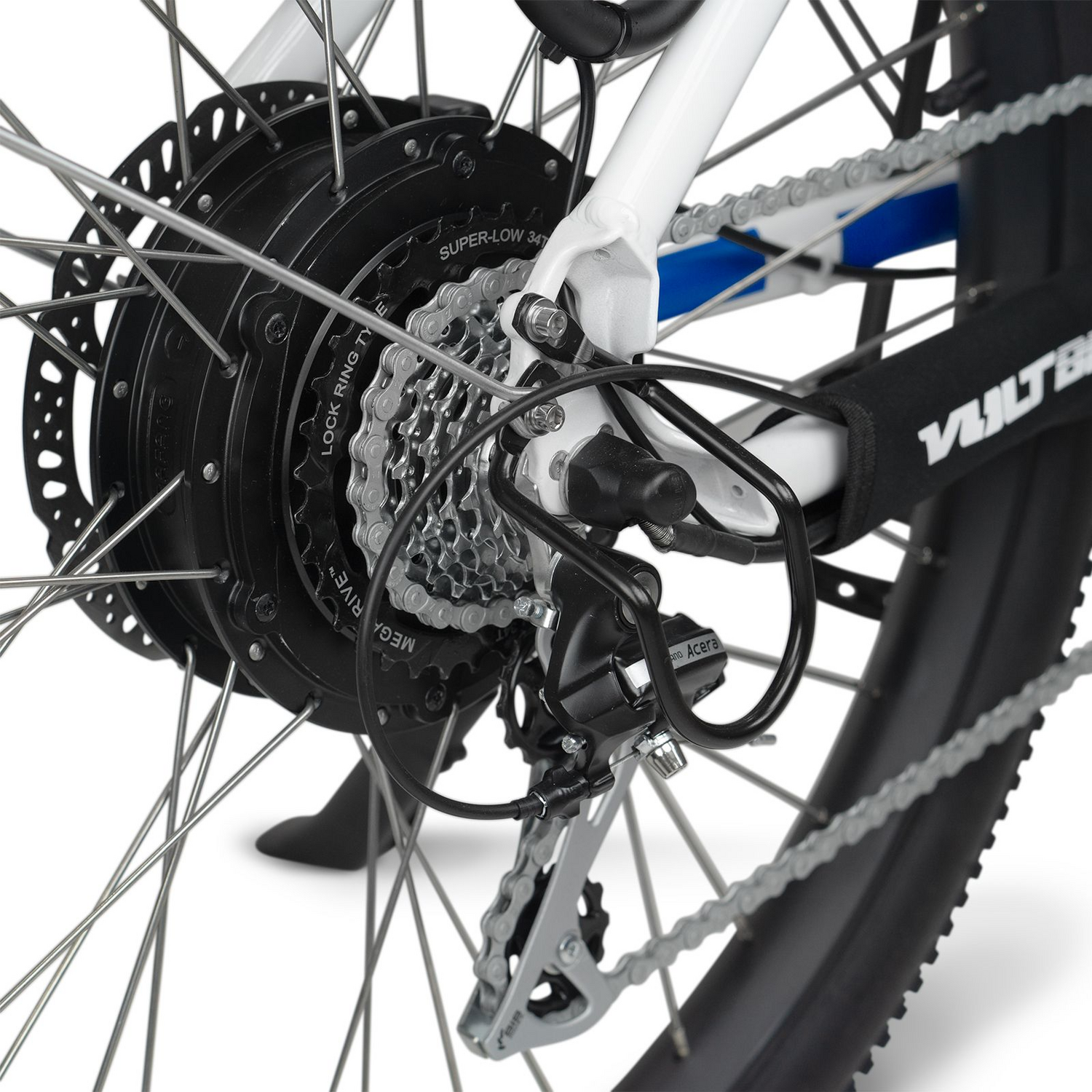

I own a 2023 Voltbike Bravo, and was wondering if it would be possible to convert it from a 7 speed to an 8 speed by replacing the freewheel and the shifter?

If the Voltbike Bravo used a cassette, you could redo the gears, but the spec says SunRace M2 Freewheel, One thing about going to an 8 speed freewheel is that it's a few mm wider, so you will likely have to pull the frame a bit everytime to re-install the wheel, and that is a pain-in-the-neck.

no because you have the wrong hub. a freewheel. 8 speed and up and usually free hubs. Plus you would have to have a new detailer too.

Shimano RD-410 derailleur is 7 or 8 speed compatible so you would need a 8 speed shifter and a 8 speed freewheel, as you noted.
But axle length may not allow for clearance between the highest gear/smallest cog and the right side dropout. You might be able to tell by eyeballing your current setup to see if it appears there would be enough clearance for the additional cog of a 8 speed freewheel, and chain (outboard of your current 7 speed freewheel to the frame dropout).
Thanks for this great info. Now I know what to look for. 👍
Looking at this image it doesn't appear to have enough clearance but due to the angle the picture is taken from can't tell for sure.
It is possible to fit 8 speeds on a freehub without pulling the frame fork spacing more than 135 mm. It is not possible with a freewheel. It is not possible with a hub motor in there too. It is easier to buy a wheel with a free hub and an 8 speed sprocket cluster, but I don't know anybody that sells them that way but bike shops. The parts houses have all the components, but not assembled. Because I hated the 7 sprocket set speed so much, I moved to a front hub motor, with a free hub 8 speed rear wheel and no motor back there. 7 lb in front balances the bike better rolling it out of the garage & over the step, too.
