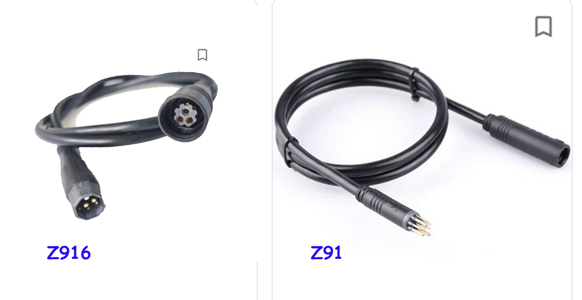

You've got a 48V25A controller, although it says 12A nominal. What does the motor connector look like? If it's the 9 pin plug, is it the large or small version. The motors that really support 25A use the bigger one,

Expect that none of the connectors for brakes, throttle, PAS sensor or speed sensor will match, Most controller swaps require lots of splicing/soldering. Hardly any are plug/play,
