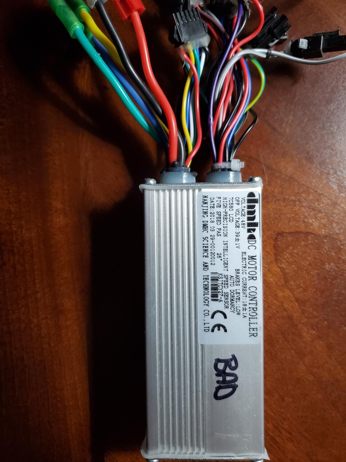

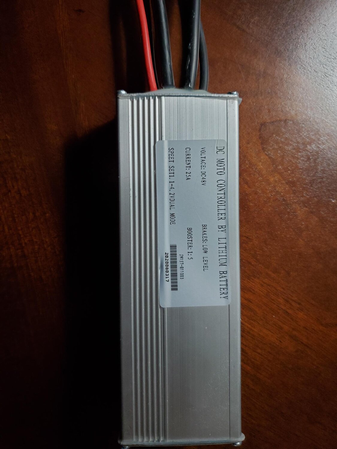

It reads like you had a 17.5AH battery that would shut down on your trike, but you have a bigger BTR pack that runs it OK now. I replied that you don't need to change the controller because it has its own current limiter.

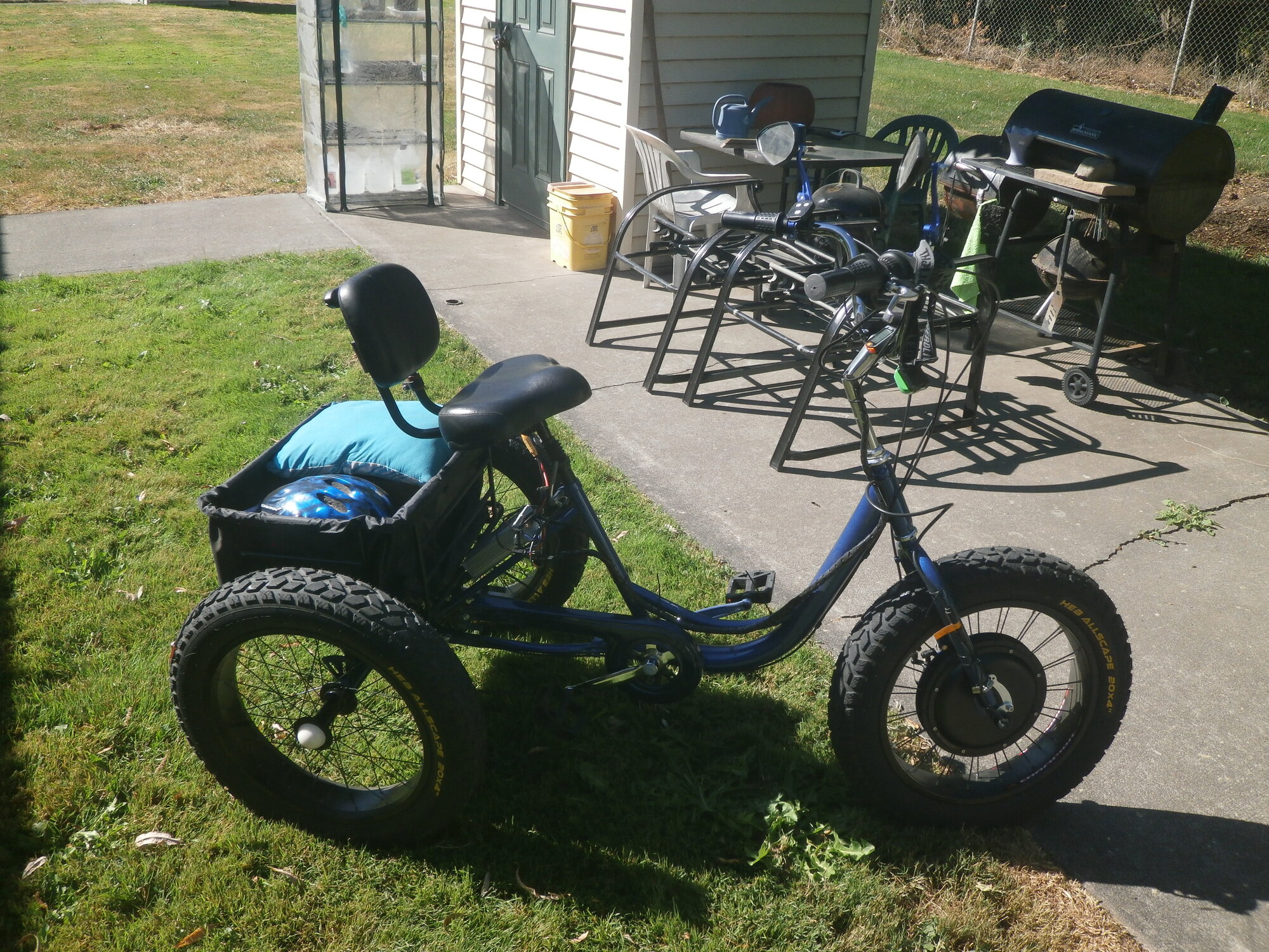

Well, I appreciate the answer about trikes cornering. I thought about building one for a lady I know that can't bakance a regular bike, but I think she would flip it, unless I limit the speed to 8 mph,

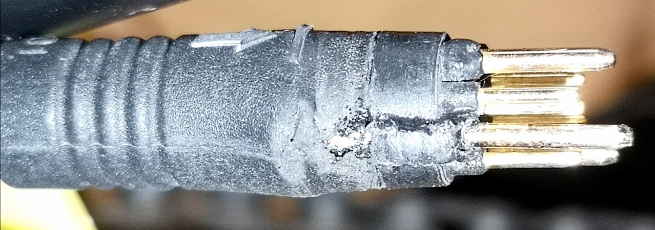

My advice is to take some pictures of what wires broke on that first battery and go to a place like endless sphere where you will get advice on whether you can put those broken wires bacl on.
