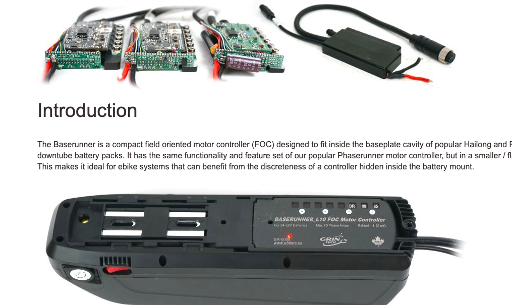

So you don’t think there is a better controller that’ll fit in the box ? One of the members posted a link for a Grin controller that’s supposed to fit but I can’t find the measurements on it.

Let's not forget about the display you would need to run with any of the Grin products....
