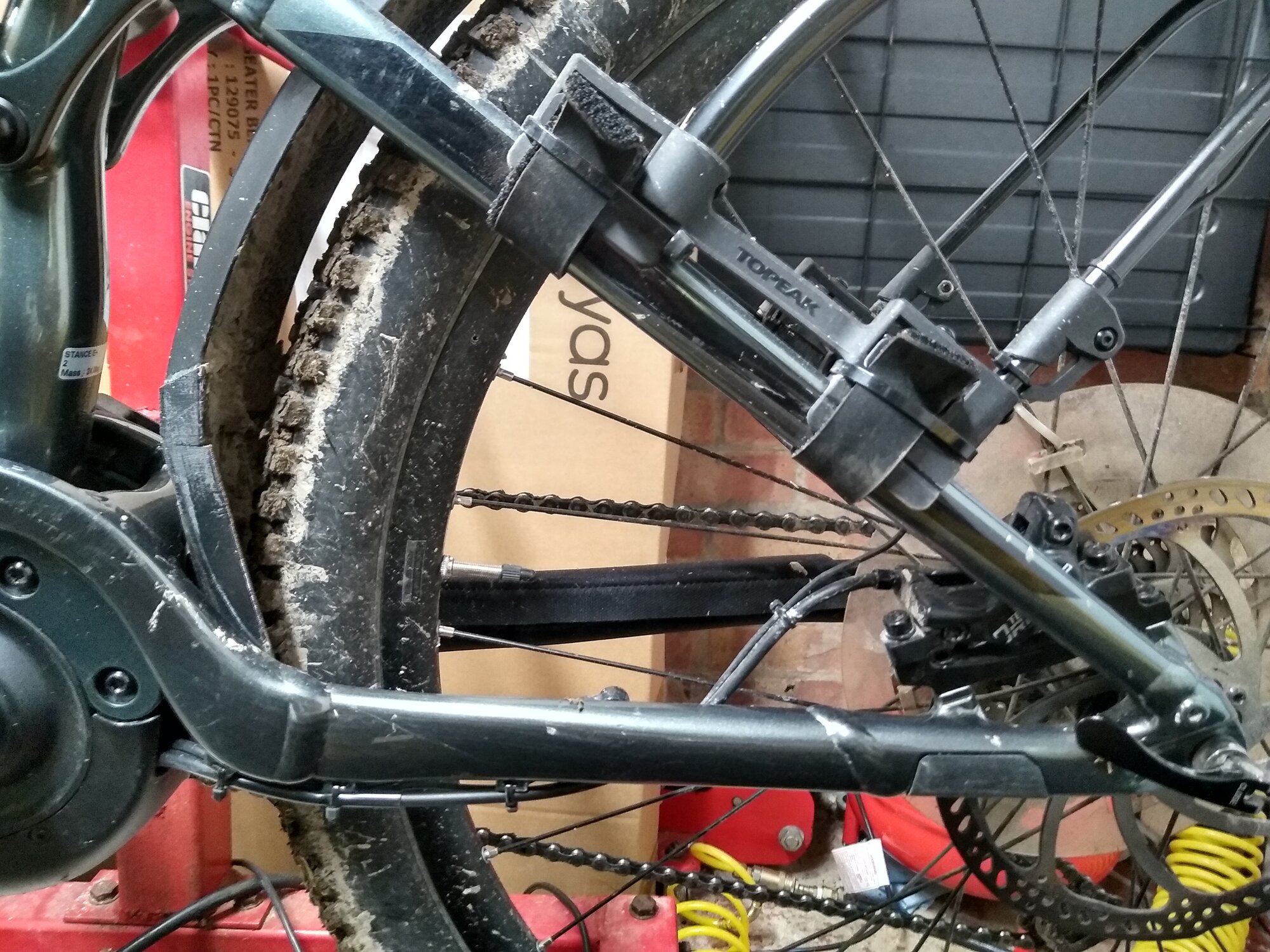

I’m happy with this one:
I fed it down the down tube behind the battery then under the motor (I removed the plastic cover under the motor). Then out the hole at the back with the rear brake pipe an up the a carrier onto the back
