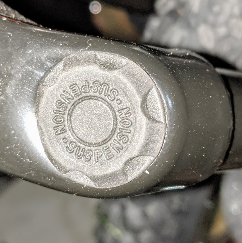

I am sure most are familar with the style I am talking about seems to be quite popular these days. It’s 350watt. I wasn’t expecting high end performance but there is an issue with the suspension. I assembled it went for a ride on the street and it clunks on bumps. I have made sure the stem is tight and all of the other Allen bolts are snug related to the suspension. One thing I just noticed as well, the dial to turn the suspension off works, but the one on the left barely turns. I though it was an adjuster that should turn much more that say what seems to be like 10-15 degrees of that makes sense. Could this just be a case of a bike that should have never passed inspection?

Yes the quick release was right and through the wheel correctly. I don’t know what type of suspension it is. (Cheap). Has a thing to shut the suspension off on one side and an adjuster on the other. I should mention the adjuster does not really turn at all.

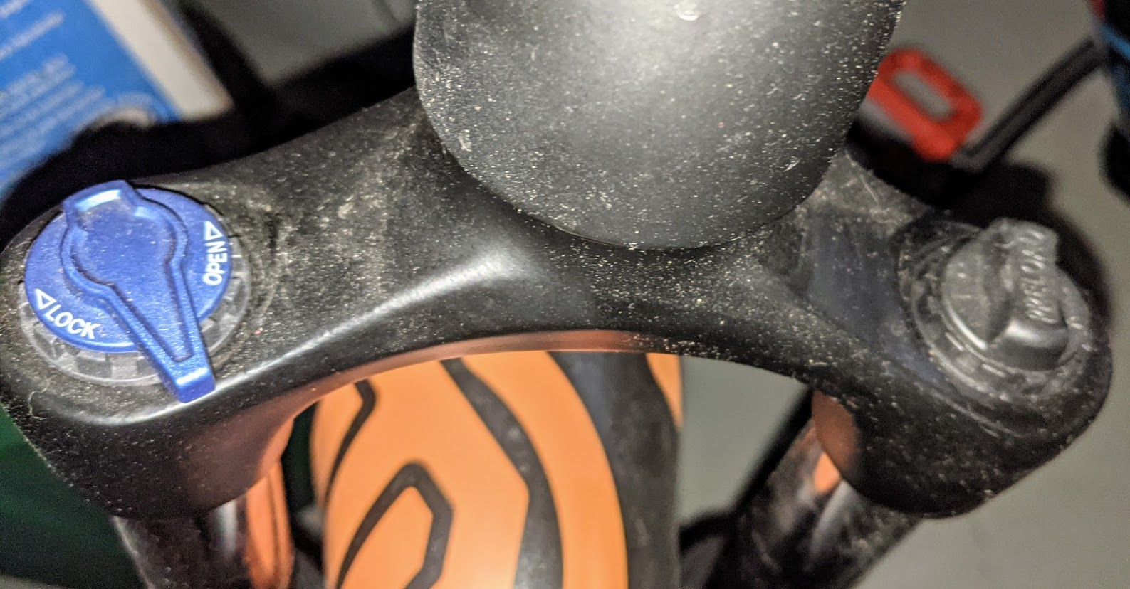

I've ridden a handful of different "cheap" suspension forks - some have "lockout," some have "preload adjustment," some have both, and some neither.
Can you post a pic like the top one below? This cheapo has lockout and preload dials, though the latter's pretty useless.
The bottom pic is of a fork that looks like it has an adjustment dial, but it barely moves and does nothing at all. It's basically a pogo stick!

Ugh, most of those low-priced Amazon and Walmart bikes and ebikes come with pogo stick shocks and other low-end components.

Well based on the photos I posted I believe you can see it’s intended to adjust. It’s just stuck. I just checked again. This bike sounds so sketchy. Can’t wait to return it.

Oh one more thing. I have I have realized the suspension on the bike runs a bit better when it is open and in suspension mode. But with the suspension turned off that is where the fork is not rigid totally and clunks over bumps. Is that normal? Perhaps for cheap forks? To me it totally sucks cause that’s how I want to ride it in the city. And everytime I hit a pothole or bump it sounds awful and is super annoying. Not what you would expect for paying over 1k. Am I being too picky about what I should expect from this thing?
