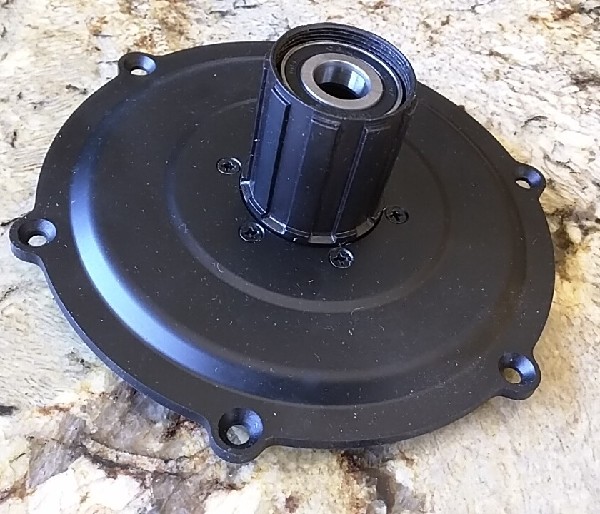

I also have a Bafang hub with a clicking noise. It occurs twice with each rotation of the rear sprocket. I was able to isolate it to the cassette ratcheting mechanism (freehub body). In certain spots it double clicks under pressure. My bike is theoretically under warranty from Bikes Direct, but I was hoping to be able to buy just the freehub as shipping the wheel back and forth is expensive. Any idea where I can purchase a freehub cassette mechanism?I have a Shred model but would like to share some info about an issue that may concern your bike. The sound could be a faulty freewheel assembly. Photo attached. View attachment 36481
The part is housed/mounted in the hub motor case. The clicking sound is easy to hear because the Bafang motor on my Shred model operates so quietly. The bike performs OK, but with 500 miles racked up I'm now concerned about the tension of the derailleur. The clicking might be caused by the freewheel mechanism not seating properly and this could cause some slack. I can't verify this yet, but I do want to eliminate the noise coming from the hub motor.
I'm looking for an assembly drawing of the Bafang hub motor that illustrates how the freewheel assembly fits with the other parts in hub motor case. I need the drawing to make sure I have the right replacement part without disassembly. A couple of photos would be great, too. I can't find anything on the web that shows mounting. Here is the ID on the Bafang motor. If anyone has mechanical drawings or photos of this motor I would appreciate sharing or directing me to the access. This is stamped on the Shred motor:

Surface will send you a new freehub if you just ask. They sent me one.I also have a Bafang hub with a clicking noise. It occurs twice with each rotation of the rear sprocket. I was able to isolate it to the cassette ratcheting mechanism (freehub body). In certain spots it double clicks under pressure. My bike is theoretically under warranty from Bikes Direct, but I was hoping to be able to buy just the freehub as shipping the wheel back and forth is expensive. Any idea where I can purchase a freehub cassette mechanism?
