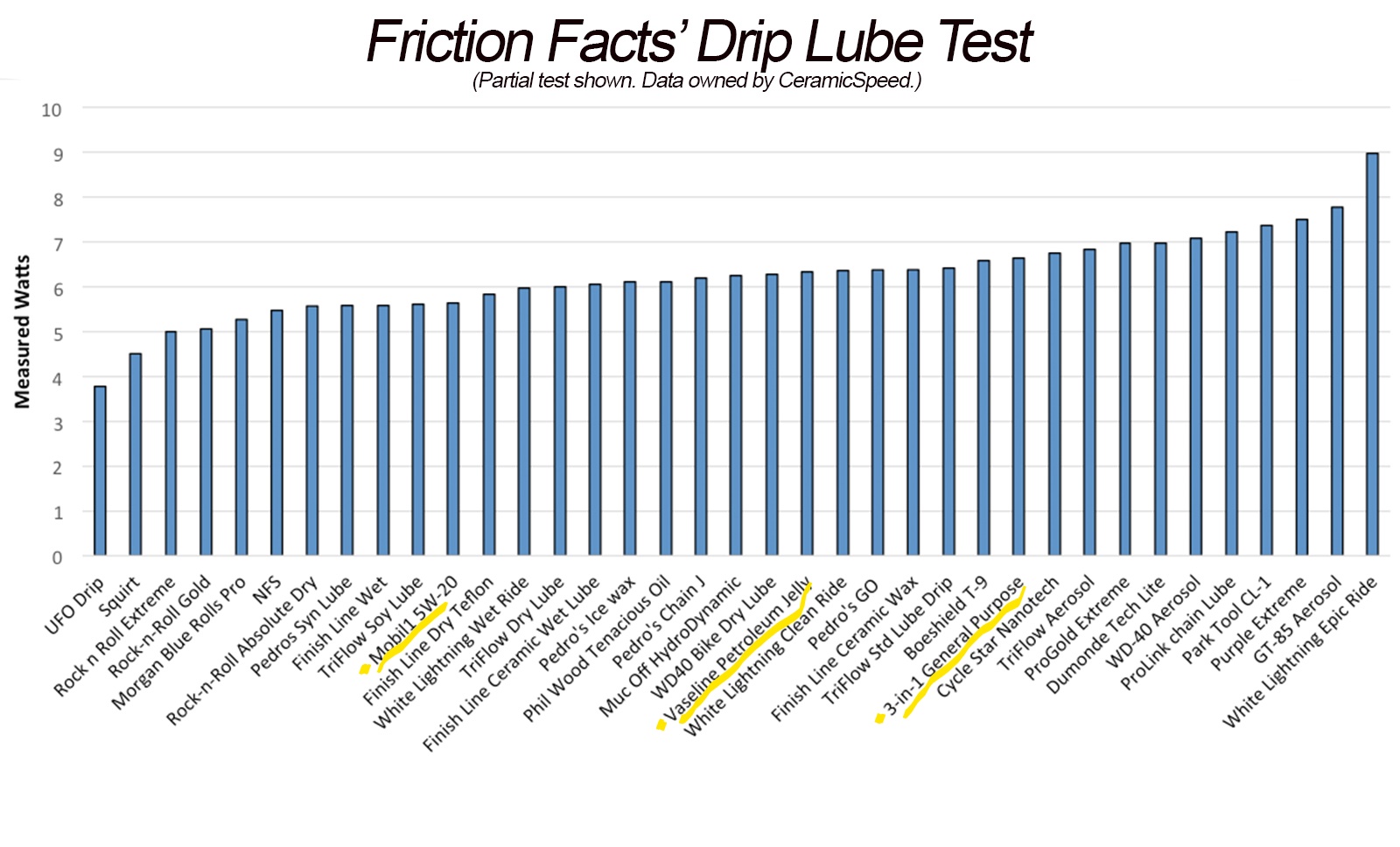

As for the lube tests, they are interesting, but not real world. As soon as you hit the trail, dust and dirt gets on and in the chain. You ride another 10, 20, 30 miles with that dirt before you're home cleaning and so 9, 19, 29 miles of dirt has ground into the chain, causing wear. The best lube is a combination of low friction, enough body to stay on, enough something to keep dirt from getting in, and probably a few other things I can't think of. Until they have a test bench with dust and dirt flying in the air around the chain being spun, and the drive is not just continuous but has hard starts after stops as well, I'll continue to believe the tests are just interesting, but not necessarily informative.
The lube tests done by Zero Friction Cycling introduce water and grit into the chain during the test to simulate 'real world' conditions. As far as I can tell their test bed and test protocols are unique in this regard.

Esp since the 'best' lube is ~$75...😯
And the data is owned by the same folks that produced the lube. 🤔
Ceramic Speed sells snake oil, IMO. All their products are ridiculously priced, and any improvement is mostly of the imaginary kind. Like those companies that sell thousand dollar speaker cables to audiophiles; you hear/feel the difference because you bought into it.
