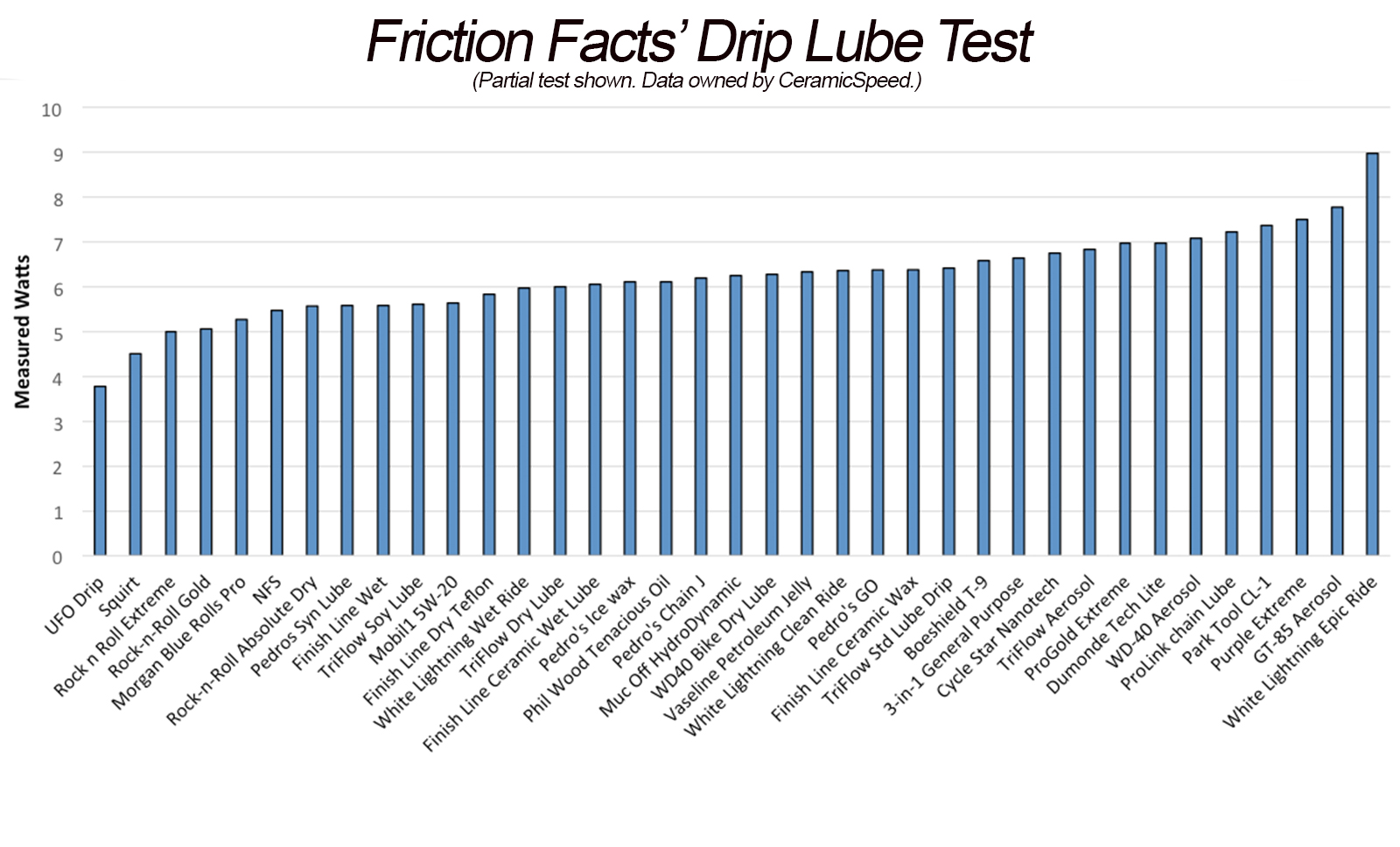

I love that this test included
Mobil-1, Vaseline, and good old 3-in-1 Oil... gotta give em credit for trying everything. 😉

The theory behind these tests, performed by Zero Friction Cycling, is that higher watts=friction=wear. So by measuring watts they can predict which lubricants will minimize friction and wear. This only transfers to the real world if they simulate actual riding conditions. A few of the stated goals of their testing are;
"Worlds first controlled longevity testing to determine lubricants real world performance."
"Load, time, contamination levels, wear measuring all extremely accurately controlled."
With that said, laboratory simulations will always have their limits but everything else in anecdotal.
If we rode in a laboratory I could say that these test have some validity... but since we don't I say they are boooolshit perpetuated by the guberment.
IMO the devil is contamination... so the best solution is cheap, easy and often and not how long it last or how few watts burned in a lab.
Wipe it down, Flush it with new oil, Repeat.

@FlatSix911, the link in your post isn't working for me. Can you take a look?
I love that this test included Mobil-1, Vaseline, and good old 3-in-1 Oil... gotta give em credit for trying everything. 😉
I use Squirt wax and Muc Off Ceramic dry lube depending on conditions... YMMV.
The underlined sentence was not a link... I was just referencing the chart that you posted with the unusual lubricants. 😉

4 ball wear test. Lots of information.
My mech engineer sons tell me that the ASTM tests that describe the "4 ball tests" are intended as initial
quallification tests for lubricants and as quality control tests over time. As far as they can recall these tests aren't intended to represent 'real world'conditions for any specific use, but are a minimum standard that the industry has agreed to. As such they could be used to compare relative lubrication qualities of various bike lubes, but this would not necessarily be an indicator of chain life as contaminants, rain, etc isn't covered in the standard.
I have no relation to Zero Friction Cycling but they do seem to have developed a test bed and test procedure that the industry is accepting as a realistic and repeatable simulation of actual riding conditions.

I agree with the person who replied that the original video of using a rag to clean the chain isn't really cleaning the chain. If anything, it's pushing the grime into the bearing surfaces. Depending on how much lube he's putting on afterwards, it could be that the liquid lube is flushing out some of the grime.
As for the lube tests, they are interesting, but not real world. As soon as you hit the trail, dust and dirt gets on and in the chain. You ride another 10, 20, 30 miles with that dirt before you're home cleaning and so 9, 19, 29 miles of dirt has ground into the chain, causing wear. The best lube is a combination of low friction, enough body to stay on, enough something to keep dirt from getting in, and probably a few other things I can't think of. Until they have a test bench with dust and dirt flying in the air around the chain being spun, and the drive is not just continuous but has hard starts after stops as well, I'll continue to believe the tests are just interesting, but not necessarily informative.
