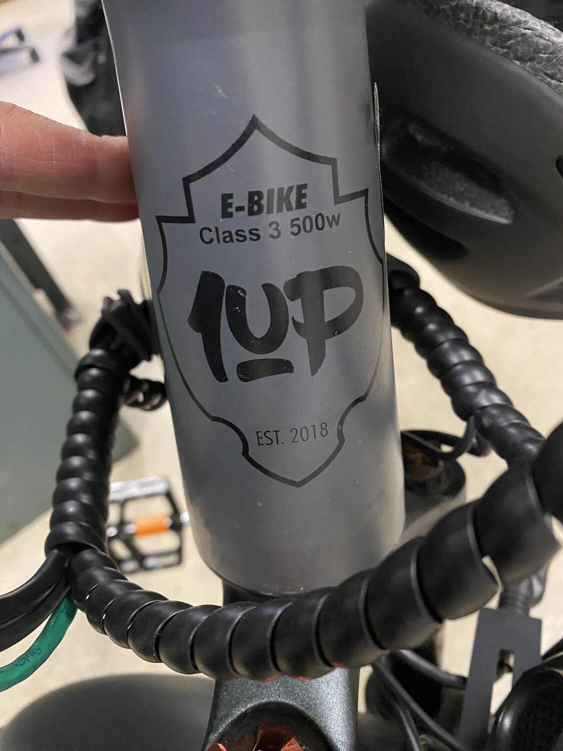

Don’t need a sticker for my class 3 500w bike. I hope the cop doesn’t get confused.

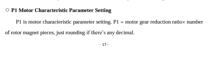

how many magnets
That is a really tough question. Is it really asking what it is asking? Total operational system magnets? That would include brake cutouts. Or just about the cadence sensor, or speed sensor, or only the magnets deep within the motor's windings.
,.. or only the magnets deep within the motor's windings.
A KT controller wants to know the number of magnets within the hub motor.
The controller uses the hall sensor data (the hall sensors monitoring the phase wires) to know how fast the motor is spinning and how fast the wheel is spinning.
The magnet count and gear ratio change the data pulse rate of the hall sensors.

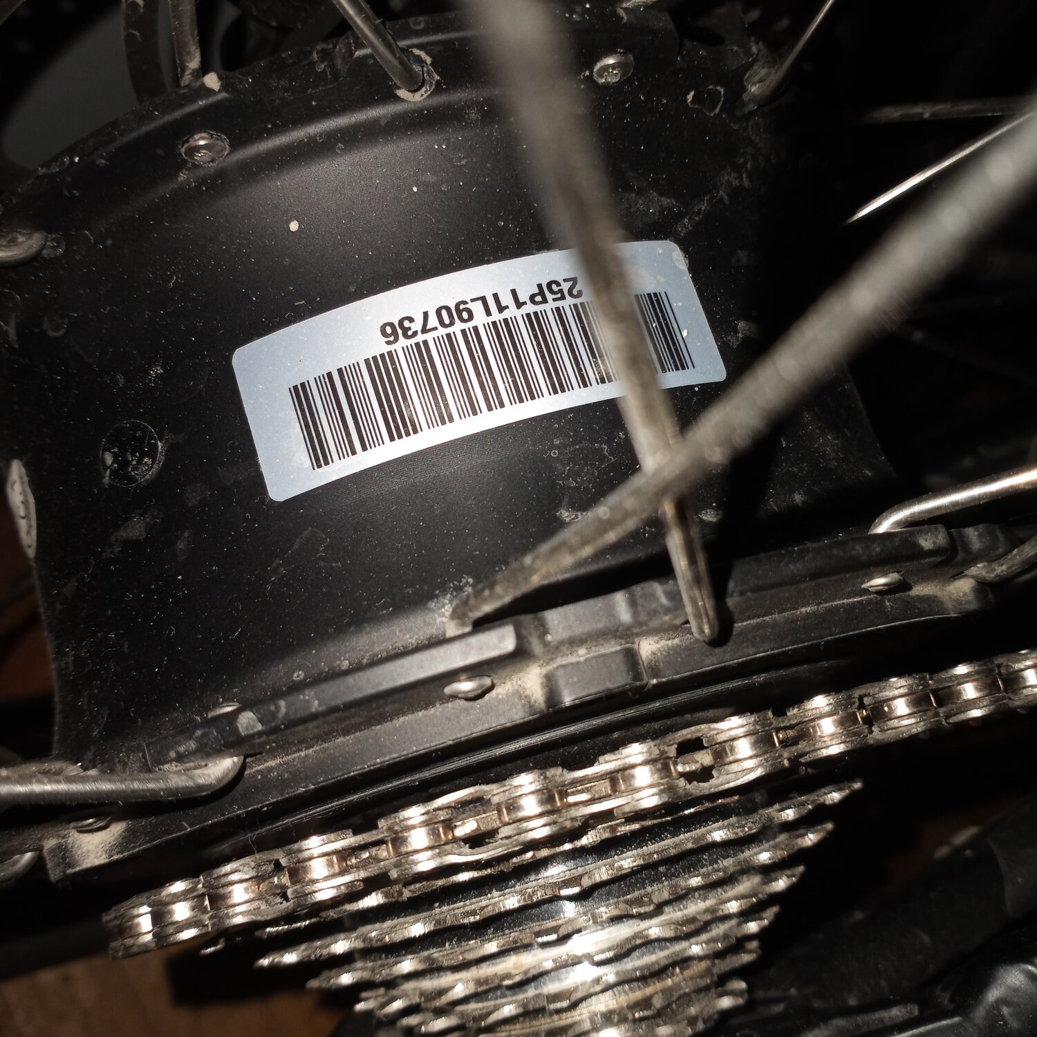

Inside the hub. I found out that I have this motor.
I've got a proprietary unmarked Das-Kit motor with nothing but a serial number/bar code sticker.
I couldn't find any information about the motor.
I'm going to have to open it up and count the magnets and the teeth on the gears.
Apparently it's a MXUS motor but that didn't help my search for information.
