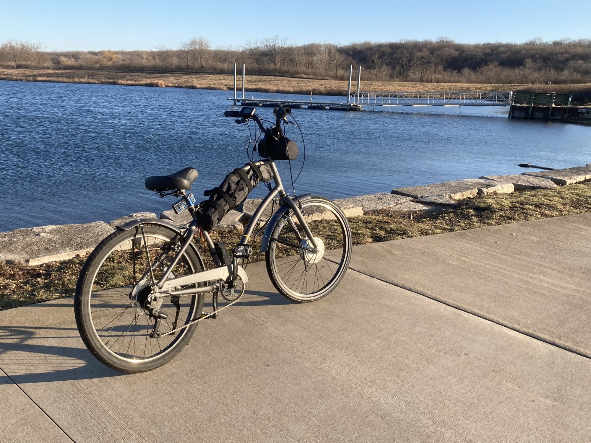

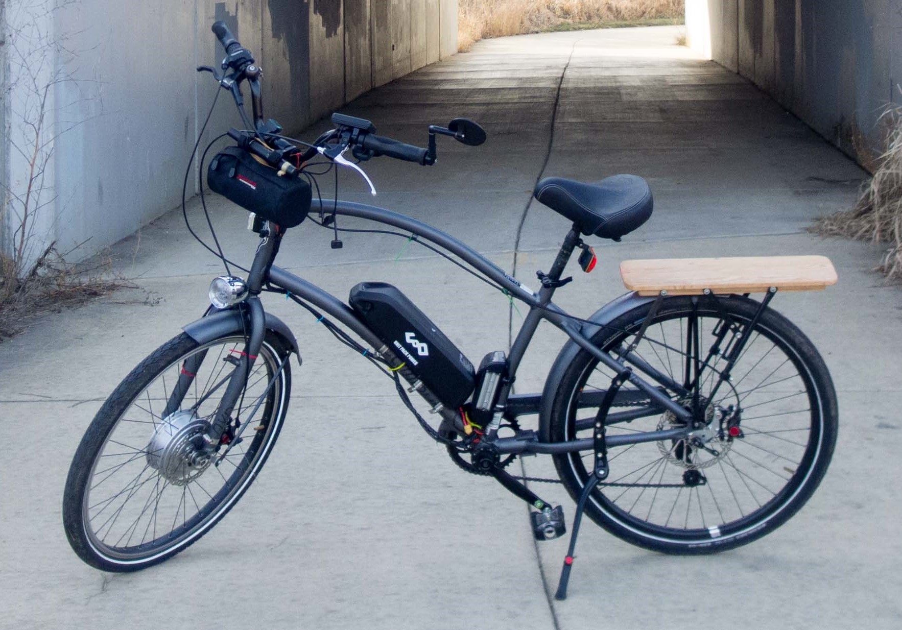

Here's a cheap Cruiser I did in 2018. Bought a used bafang front motor and a used 36V nineboot scooter pack for $100. Motor controller was $75. Put it on a Kent 26" Cruiser. Rolling along for under $200. Later went to a 48V battery, upgraded the awful rim brakes to disk brakes, and am at $500.
I recommend a rear motor kit. A bad install on a front motor, you will rip out the motor and faceplant. Really, you can.
