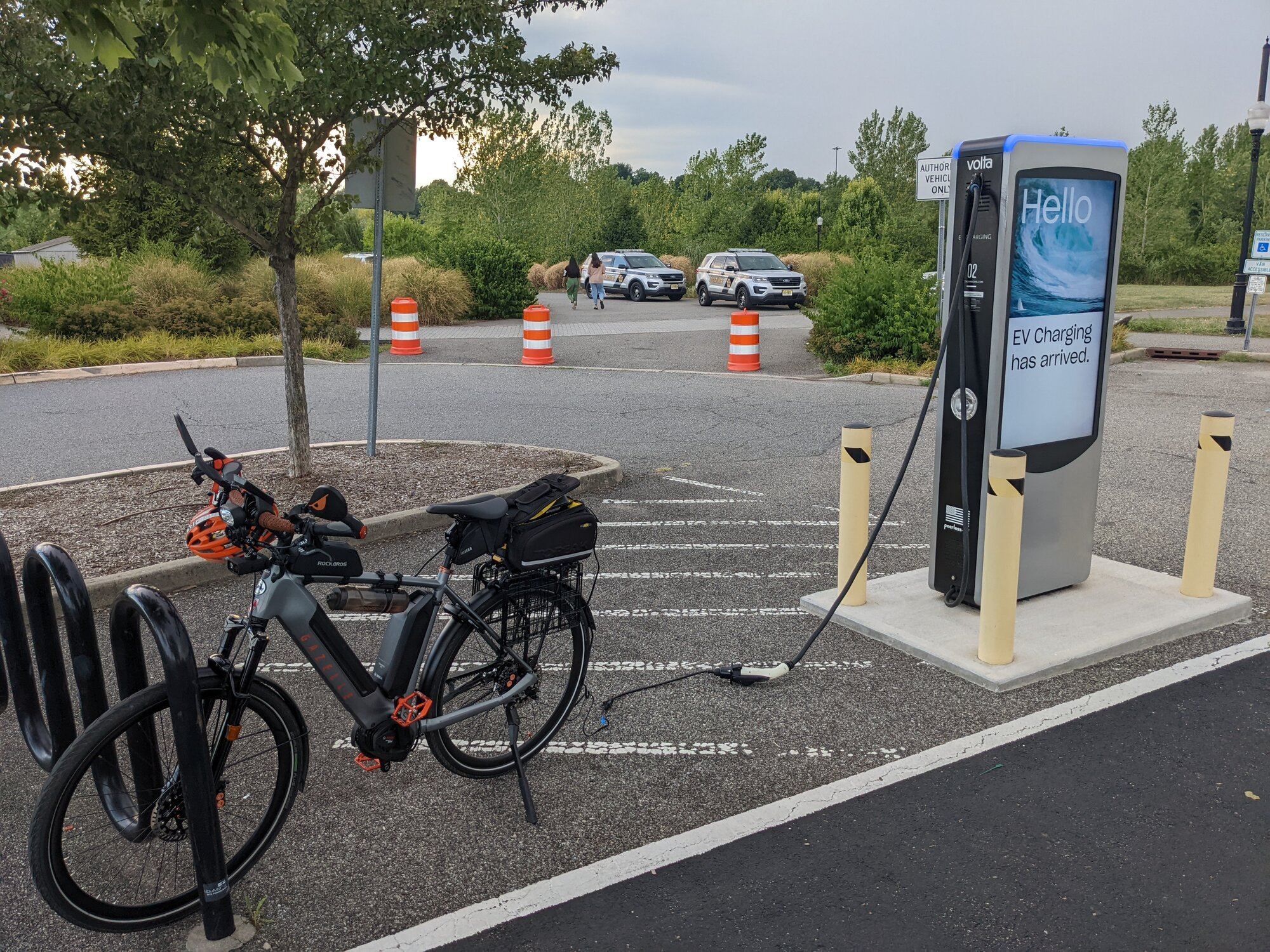

I want to share my first experience with charging my ebike on EV charging station. I am going to share as much details as I have so far and will answer any questions you might have. Would also love to hear about your experience if you tried doing same with your ebike!
Goal. My interest in ability to re-charge my bike on EV station is related to my interest to do longer rides (200 miles and more), which means ability to re-charge on the route. Regular outlets are not uncommon, but difficult to spot and relay on - even when resources like https://nyceboarding.com/map exist. EV stations location is well known, their statures are monitored in real time and these facts allow to plan longer routes with re-charge points.
Station. I did the experiment with one of the Volta L2 EV stations I have just in few miles from my home. L2 (Level 2) here means that station voltage is 240V (in comparison to 120V for L1). This is important, since voltage limits the selection of chargers you can connect.
Equipment. I did some research online, so I came pretty well prepared to the experiment.
  • Ebike. My customized Bosch-powered Gazelle C380+ HMB with dual battery kit (500 Wh + 500 Wh)

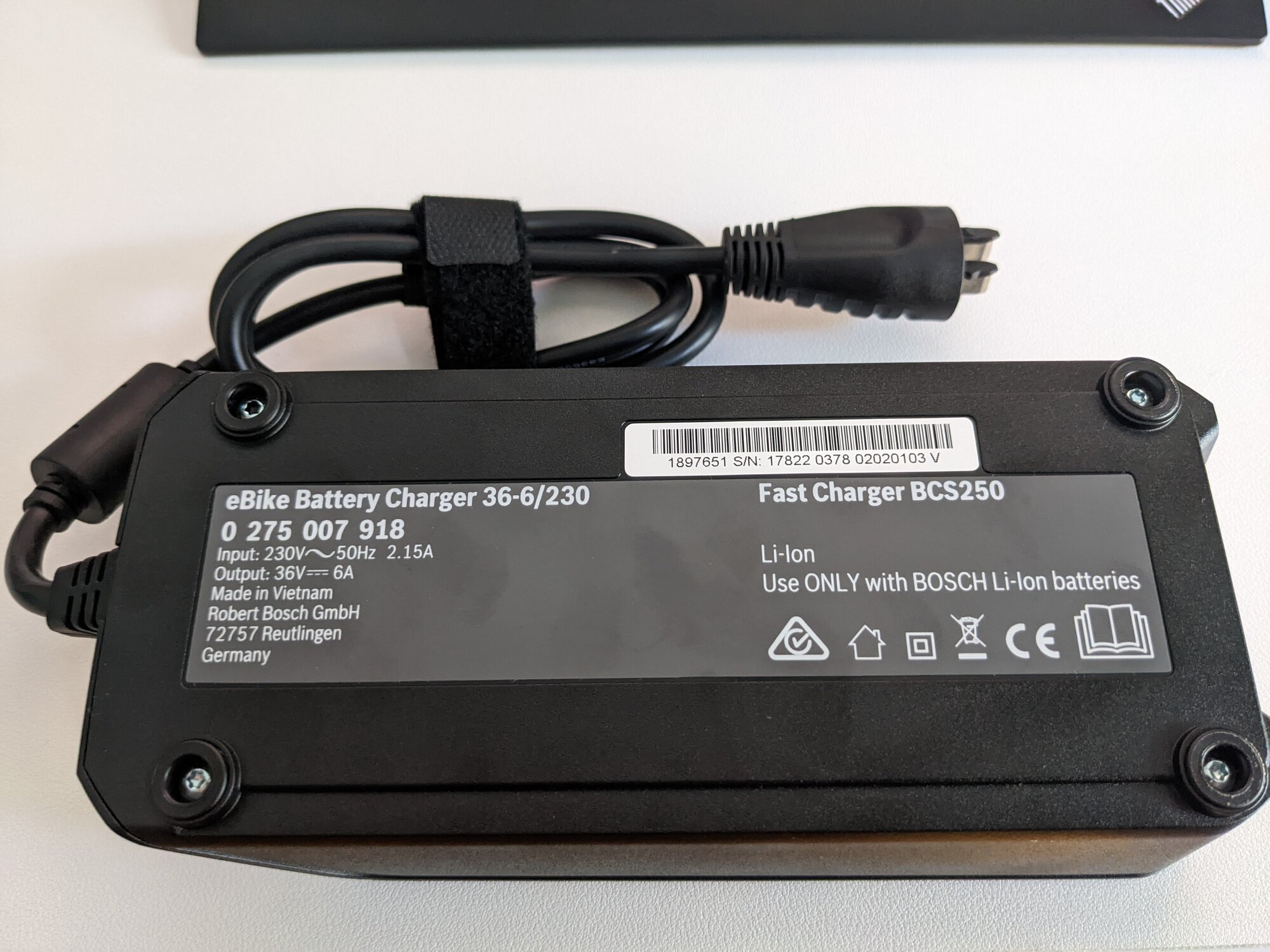

  • Charger. I have few charges for Bosch (stock one for 4A and portable one for 2A), but just few days ago I received another super fast 6A charger from Europe. There is good reason this charger is not sold in US - it expects 220-240V input voltage, which is common is Europe and not common in US. However for using with EV L2 stations this is perfect choice!

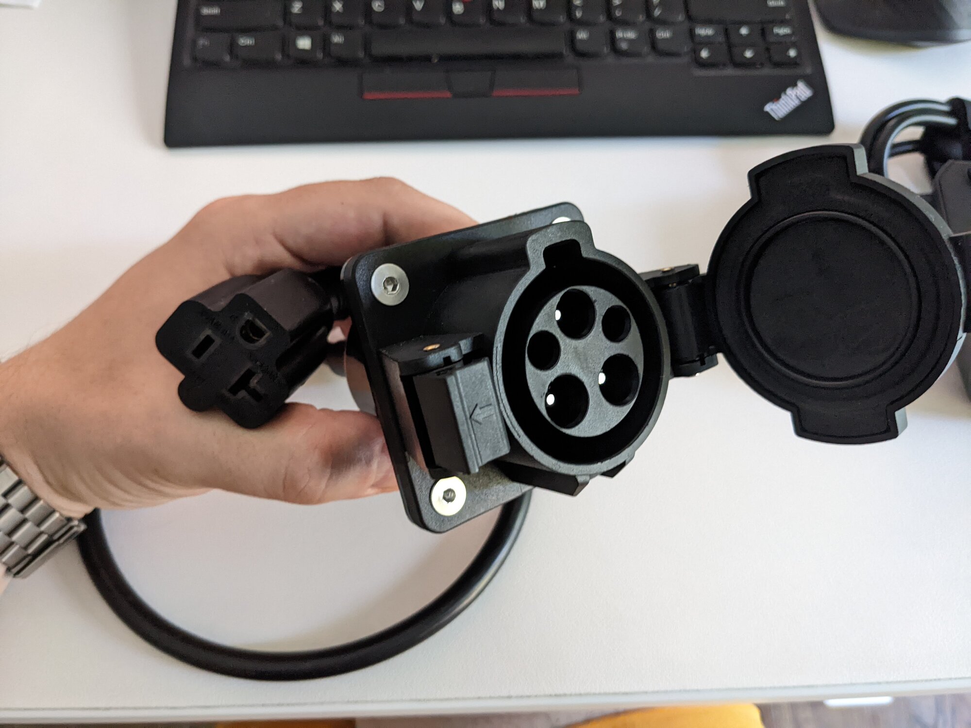

  • Adapter. This piece is very important, since EV stations are using very different plugs to connect to vehicle. One of the common standards is J1772, which is used by Volta stations as well. To connect my Bosch charger to this plug, I bought J1772 to NEMA 5-15/5-20 EV Charger Adapter, which takes care about communicating to charger station to actually start the charge (some signaling is involved in order to convince charging stations you are ready to accept the charge) and provides standard for US NEMA interface on other end.
Process. Here everything was straightforward - ride to the station, connect bike and wait while it being charged. The most complex thing was to spot the free charger, since we have lots of electric cars in the area and chargers are located at the parking near large playground.
Results. I left bike connected for 2 hours - mostly because this is the limit defined for these stations. One thing I observed is that station status with connected ebike is shown as "Plugged in...", while connected car is shown as "In use". My theory is that load created by ebike charger is very low and station is not considered it to be an active consumer, which probably mean 2 hours limit can probably be ignored.

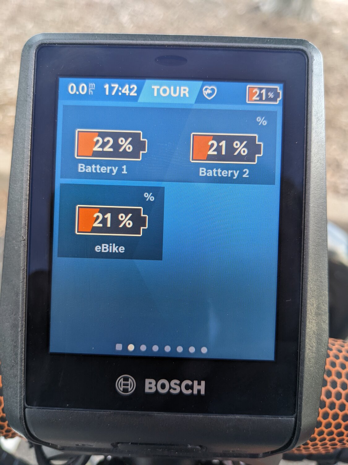

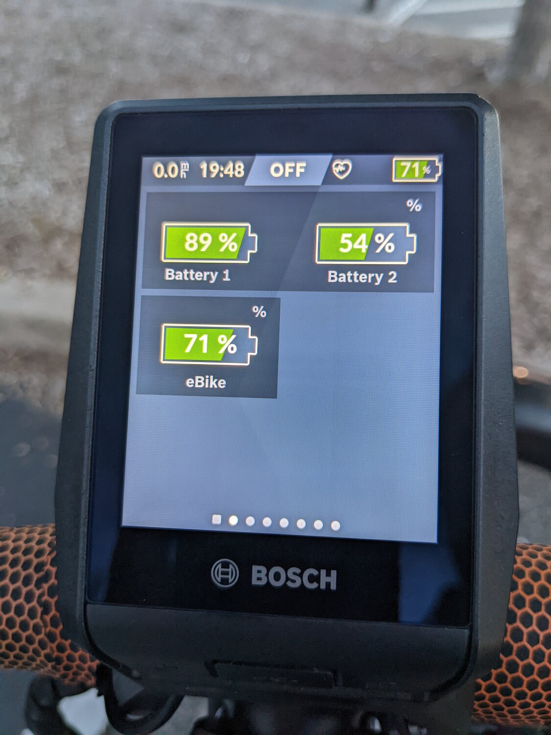

So, I arrived to the station with 22% battery level:

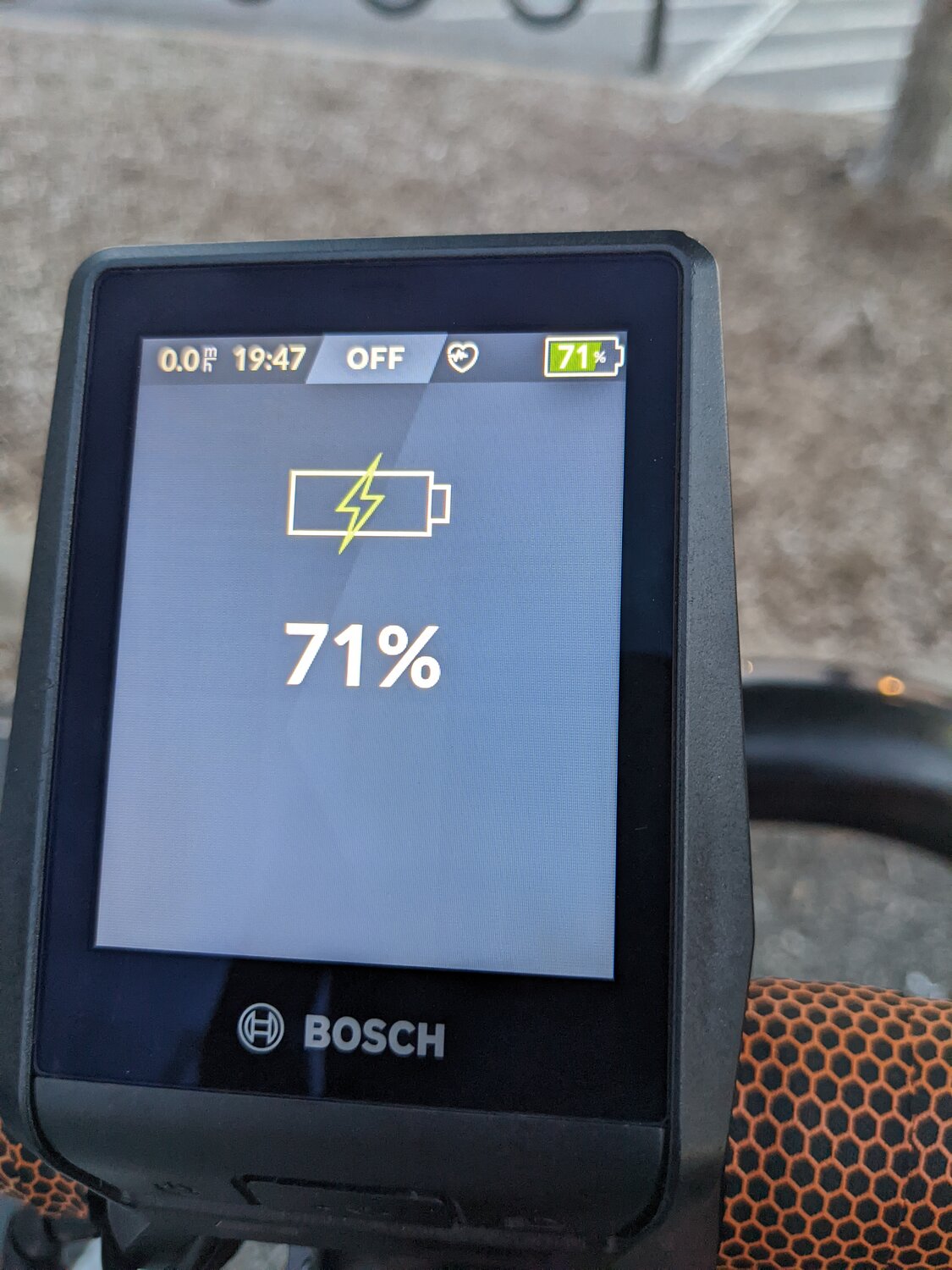

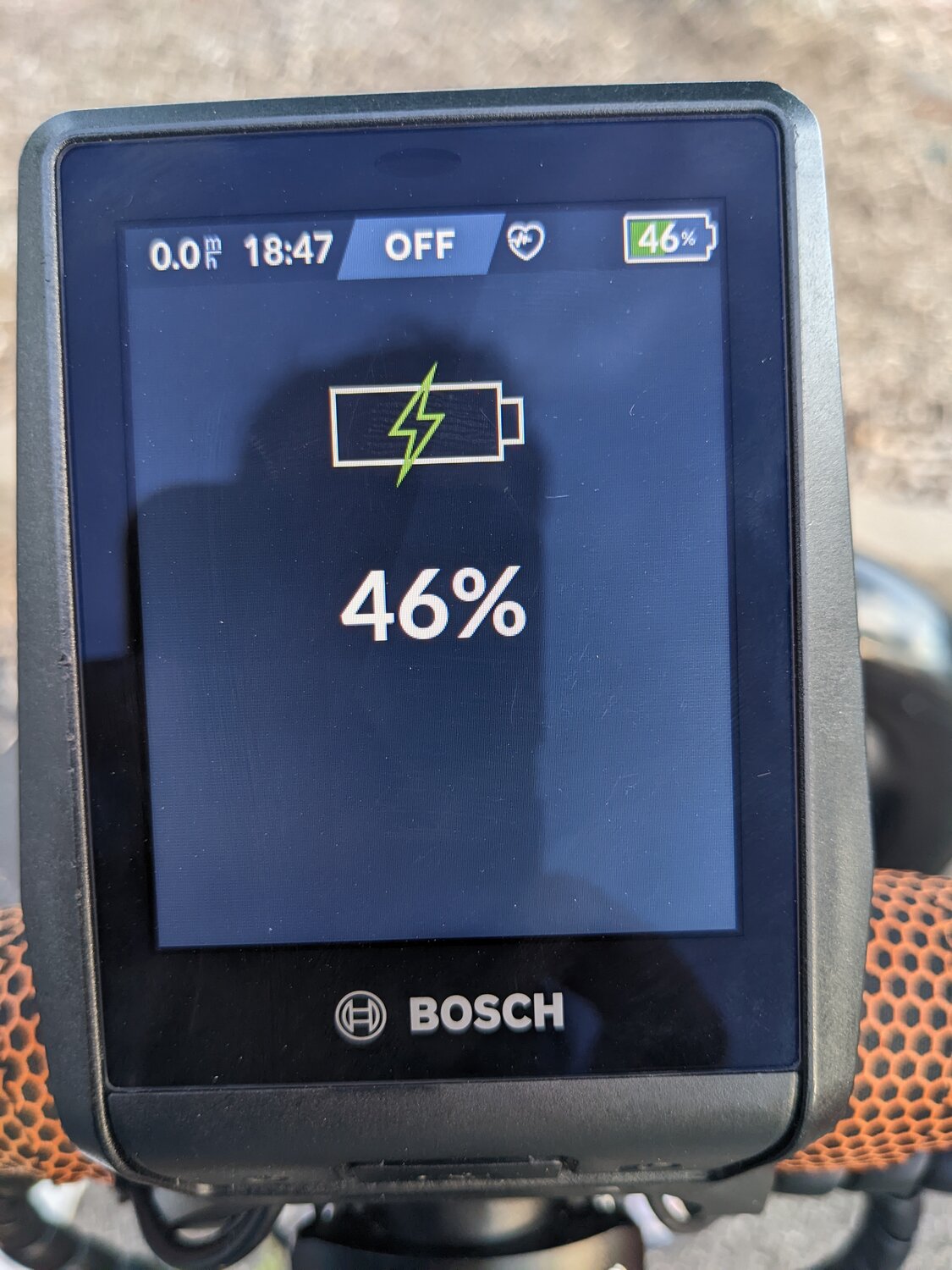

I captured first level update in an hour:
and 2nd in two hours:
Final batteries state after 2 hours:
As you see, the results are pretty impressive - I was able to add 50% to my 1000Wh setup in just a two hours. I believe using super-fast 6A charger was a key thing here, but I am very happy with the result. I noticed some battery level dis-balance after charge (which I never saw when charging with 2A and 4A chargers at home), but this is probably result of super fast charging speed. As far as I know Bosch dual-battery setup works well with any charge level in both batteries.
Final verdict. Total success! The charging set is not very bulky, so I can take it with me to long rides and stations availability in my area should help me to re-charge my bike pretty easily when needed. Looking forward to try this all in real ride.

so you just have the one 6A charger and it feeds both batteries? can you charge both at once with two chargers? does this same thing work on a L1 charger with 120v? I use two chargers to charge my dual batteries. definitely watching your progress!
One charger for simplicity pretty much - I can charge batteries separately with two chargers after removing them from bike, but this means more things to carry and more complex wiring.

Should work pretty much same way, except I won't be able to use my 6A charger, which needs 240V input.

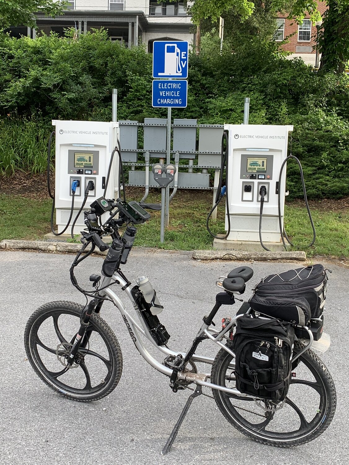

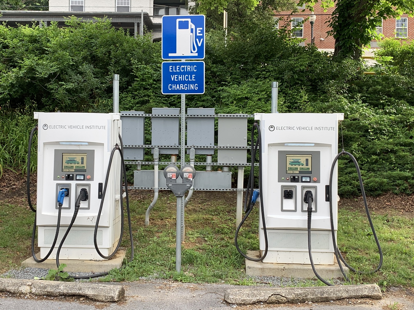

I came across this E/V charging station last week in Hancock MD. It's located in a commuter park & ride lot adjacent to the Western Maryland Rail Trail.
One of the stations was being used to charge an electric car and the other to charge an e-bike. The rider was using an adapter connected to his 110V e-bike battery charger. He was having a somewhat heated conversation with the owner of another electric car who wanted to use the station. I didn't listen to the entire conversation but in effect, the car owner said the station was for cars, not bicycles and he was going to call the cops. It would have been interesting to see what eventually happened but I didn't stick around to find out.
I can see conflicts like this becoming more frequent as demand increases for these E/V charging stations. If the feds are going to pour billions into adding more of these stations nationwide, how much extra would it cost to simply include a 110V electrical outlet? This would eliminate these conflicts and indirectly promote the use of e-bikes in general.
Another issue here is billing. These particular E/V charging stations use a credit card reader with a $5 minimum. Personally, I would think twice about paying $5 for about 20 cents worth of electricity to charge my e-bike battery. Many of these stations I see are free while some charge a fee. IMO, some sort of fair use standard needs to be established.
